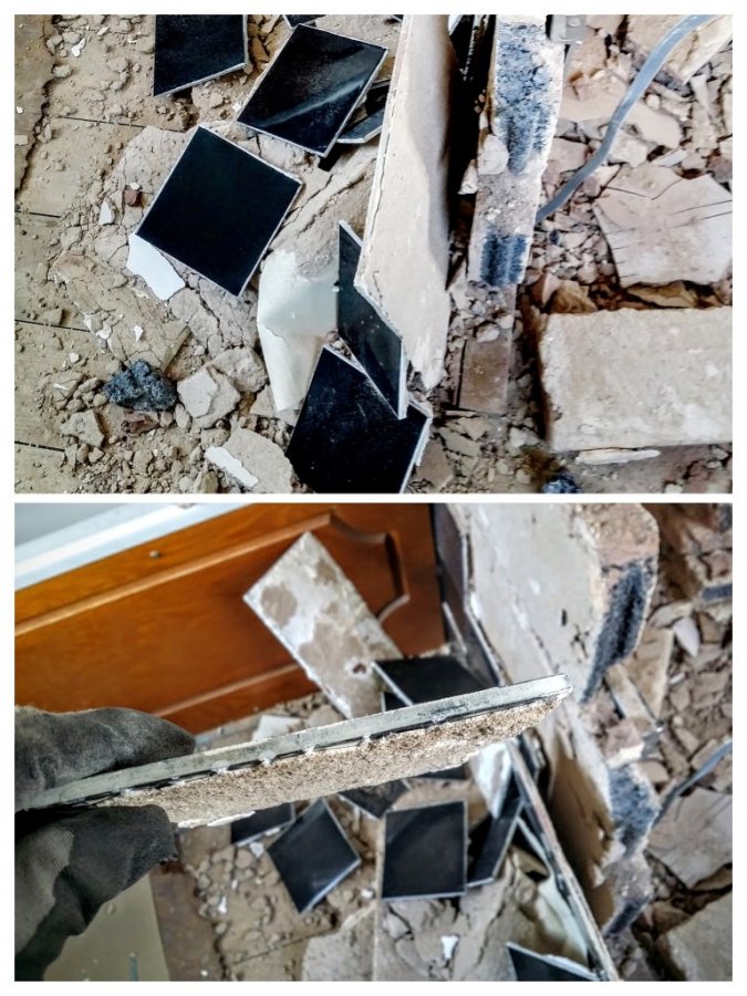

I happened upon some tiles coming off in one piece today. It helps if the plaster comes off easy though ... or just falls off.
So it might be possible. (y)

The blocks are actually 2". One wall was across the joists, and another at 90° to it which was on floorboards, with no deflection or cracking. It was easier to remove/replace the walls rather than mess about trying to move doorways and be left with wobbly walls.
The first floor joists were undersized by todays standards too, but the joists and all the other timber was solid and not easy to drill or screw into - certainly not as soft as the CLS that replaced that wall. So that probably explains why the first floor walls have not moved when the floor was loaded.
