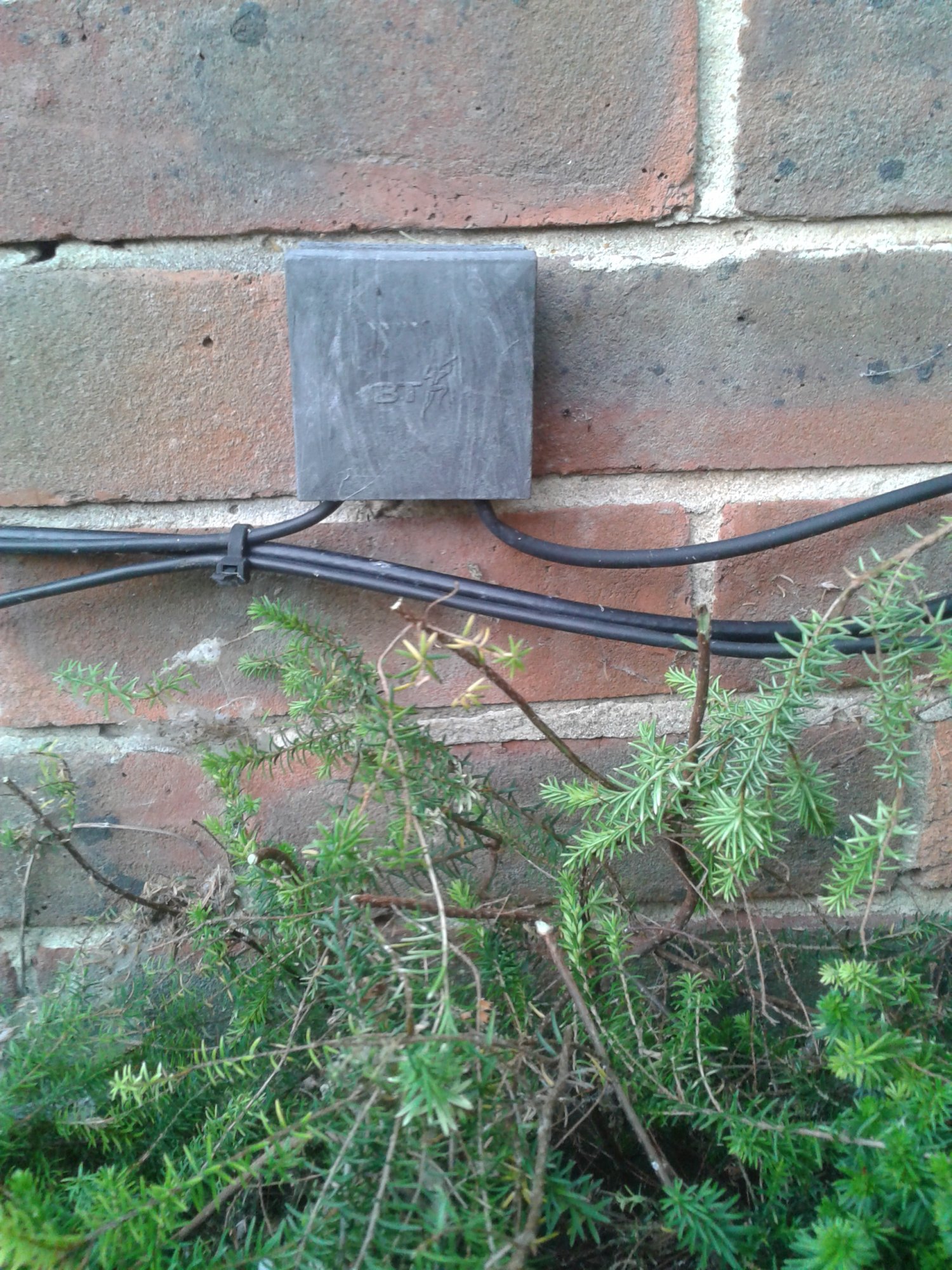

The other thin cable also goes outside the house and leads into this box from:
the wire exiting this box goes a bit further around the house leading to another identical box which has two exit wires that lead into the other back bedroom wall which has this socket.

The thick cable coming up from the ground to the outside box is the incoming BT line. Open this box carefully (You should not be playing with BT stuff ) and identify the incoming pair of wires. These are A & B. Ideally you would want these to continue on & into the master socket, but I suspect that they have been split onto the two thinner cables to provide two circuits. The polarity of A&B is not material.
It would be worthwhile fitting an NT5 master socket on the interior wall opposite to the incoming junction, with the A&B incomer connected to the A & B on the backplate of the NT5.
Then the two thin cables could be brought through the wall and into the NT5 and connected using their existing pairs onto terminals 2 & 5 of the faceplate.
To complete the job, use an NT5 filtered (replacement) front plate and use a separate Cat5 minimum cable from the A&B connectors on the faceplate to an outlet on a socket used for your broadband router.

Since its already removed from the wall and none of the other sockets that i am using seem to have been affected is there any reason that i cant/shouldn't i disconnect the wire at the grey ground box.

OK.
For that socket, just trace back the cable and remove it.
When you come to removing other sockets, though, they may have an incoming cable and an outgoing cable daisy chaining to another socket that you wish to keep. If there is only one cable to a socket, you can remove it.
Suggest that you do it one at a time and ensure that the remaining circuit does what you want before you do anything drastic.
