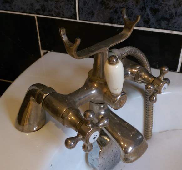

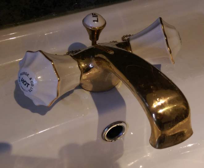

Couldn't think of a better way to describe these. They date from 1994, so drip, squeak etc. The hot tap in the hand basin is actually quite weird… it only turns about an eighth of a turn at all, lock to lock – and you have to turn it the wrong way (ie clockwise) to get water to come out!
I’m trying to learn very basic plumbing, and what I’d like to do here is take these units apart and fit new washers, or ceramic units, or whatever’s inside them. Is that practical, or are there likely to be bits and pieces I don’t know about, which could be worn or wrecked, so make replacement of the whole unit necessary?
And if I can, how the **** do you get the tops off the taps in the hand basin?
Thanks :D
Your bath taps, the indices should screw off and let you get to the screw below to remove the cross head. The Basin tap is another story, they may just pull off

Those old fake Victorian taps are horrible; by the time you've messed around trying to refurbish them you might as well replace them with modern taps. If you don't plan to stay long in the house buy cheap from a shed, if you do plan to stay, buy a decent brand. Make sure you buy taps suitable for your system, high or low pressure.
Thanks - beginning to think you're right. Also, I've replaced the other bathroom fittings with fake antique chrome ones, so the gold taps don't really match.
