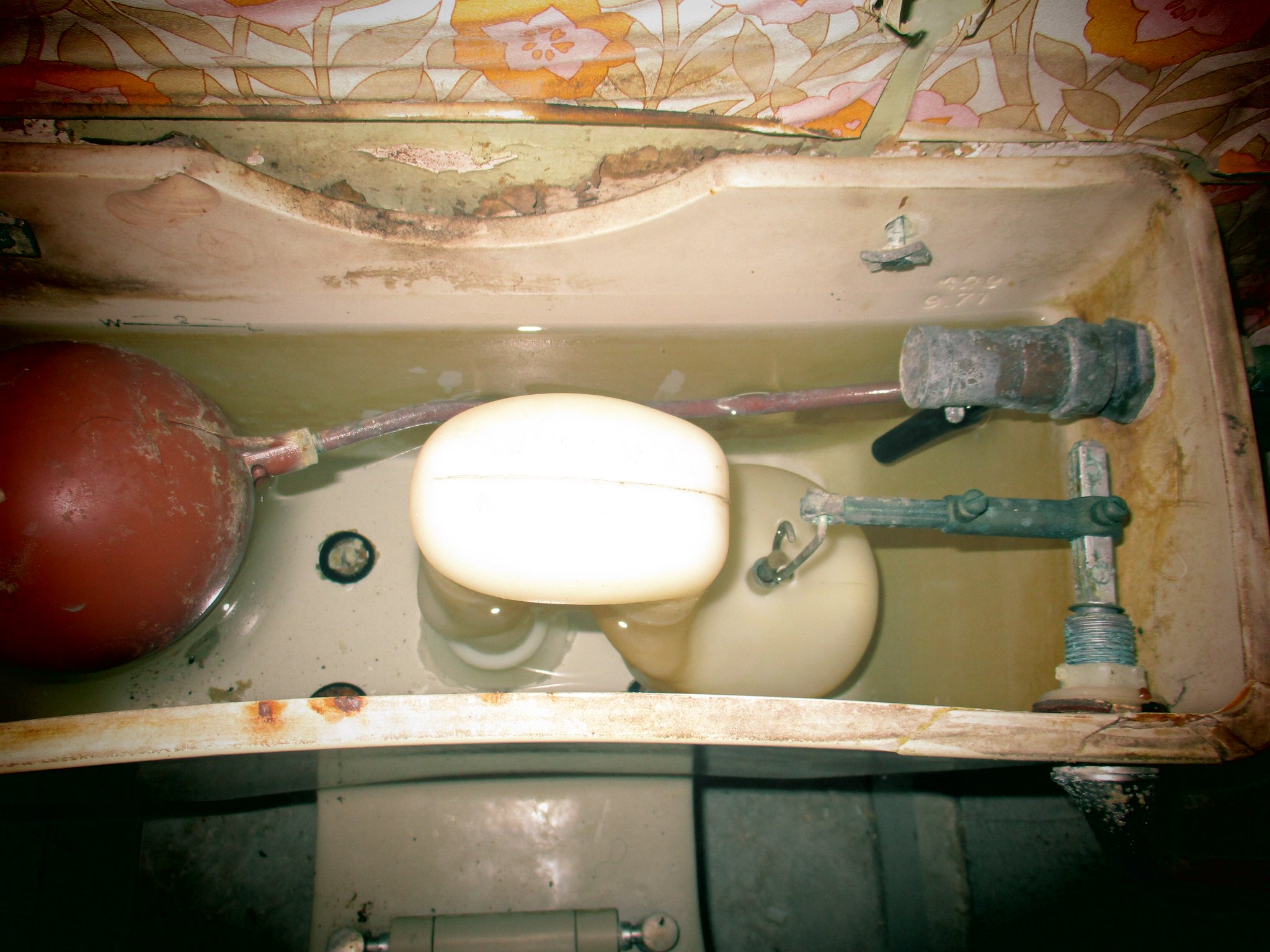

Hello all,

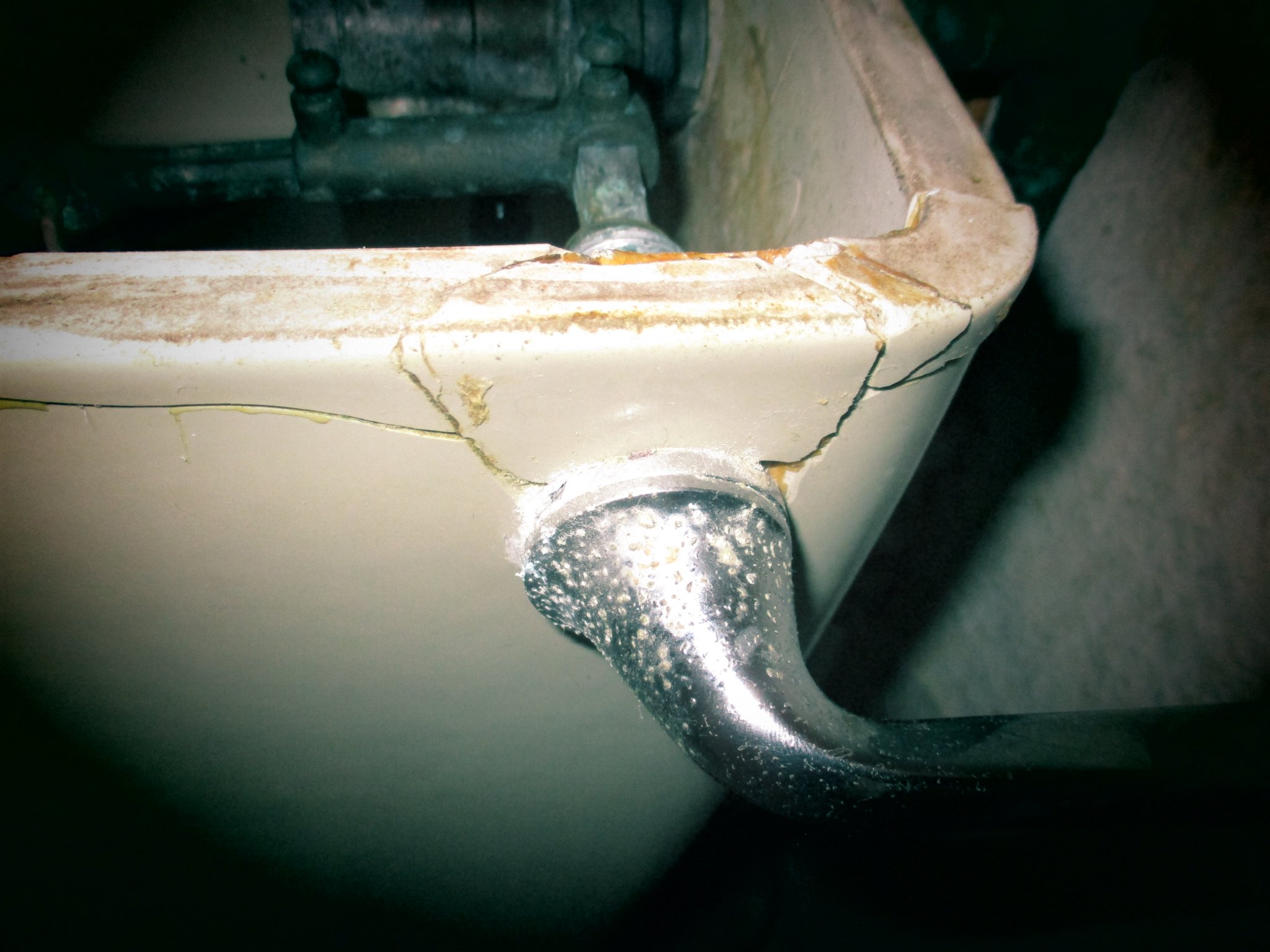

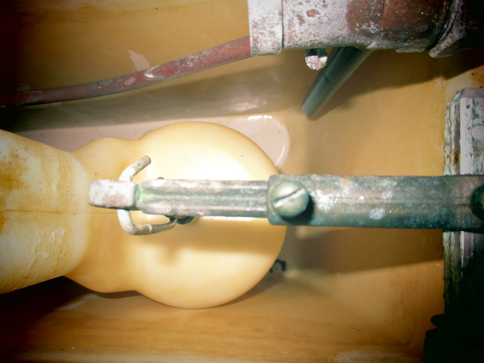

I have an ancient Cistern syphon (see attached photos IMG_9460, IMG_9461), which was seen by a plumber 4 years ago, because the WC handle became difficult to turn. I had wanted a new syphon but the plumber took a look at the crack on top of the handle (IMG_9462) and declined to replace the syphon. Instead, he squirted some WD-40 around the handle, and this solved the handle turning problem.

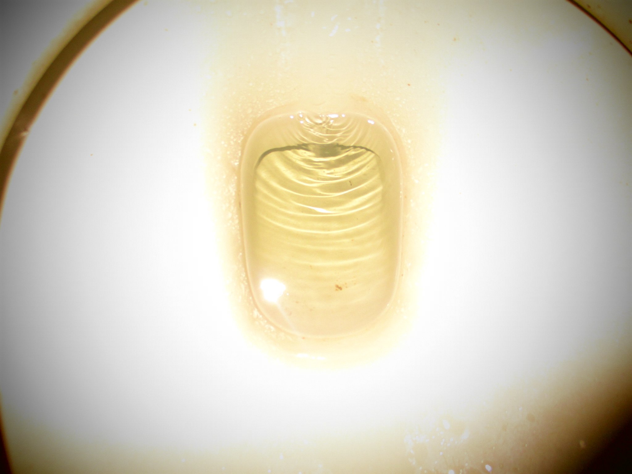

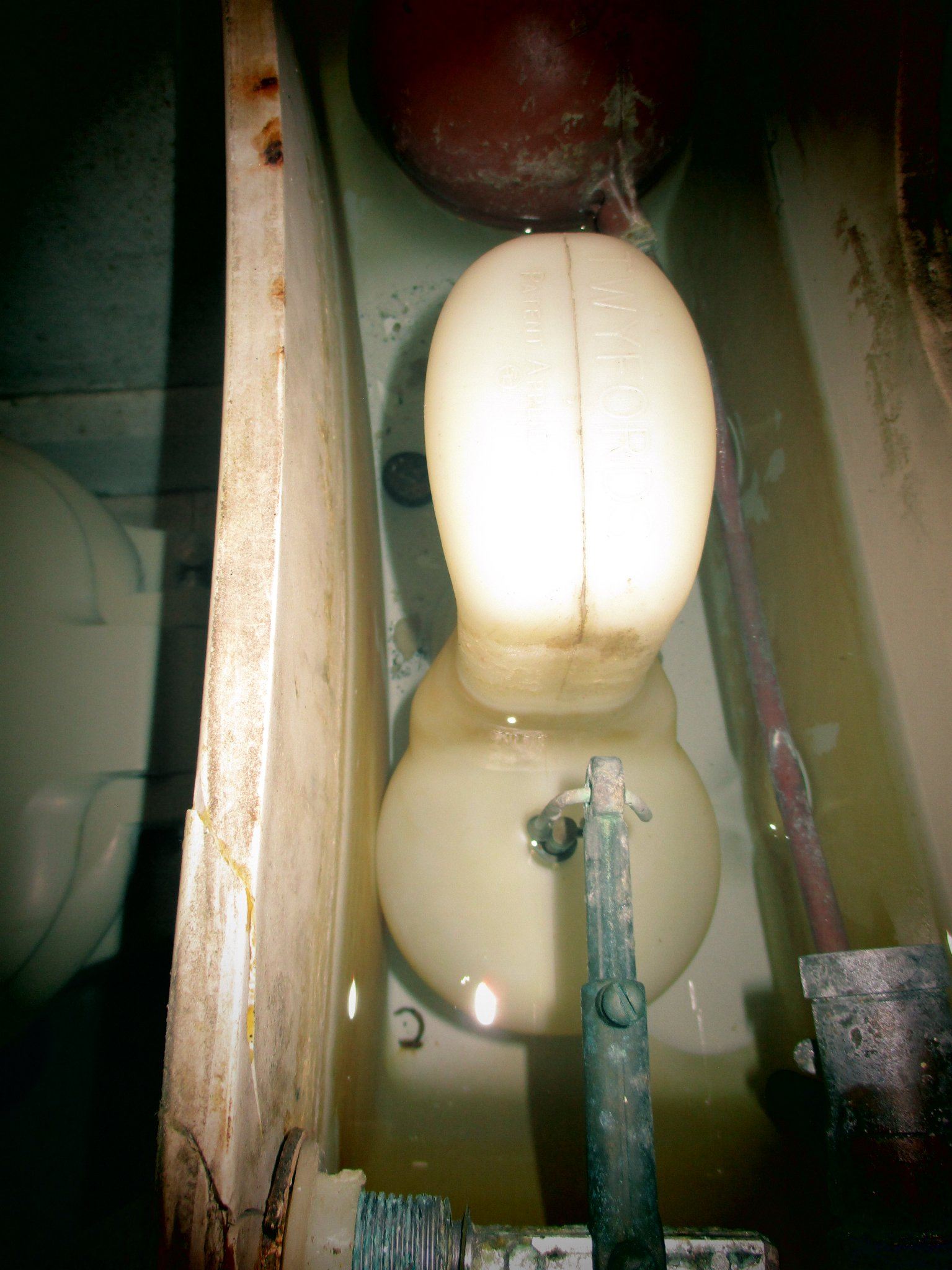

For the last year or so, the syphon has started to leak appreciable amounts of water into the commode (see IMG_9459). This problem now causes my water bill to be 60% higher than before and I am keen to replace the syphon with a new one to stop this leak.

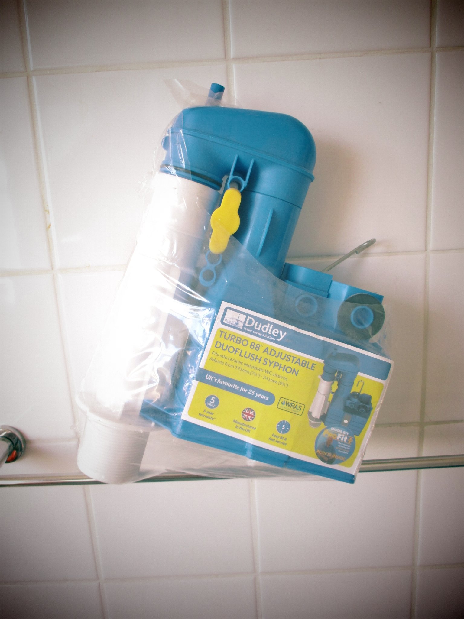

Please advise me on how to remove this faulty syphon and replace it with a new one. I already have a Dudley Turbo 88 syphon (IMG_9464) which I bought 4 years ago, just before calling in the plumber, if this is suitable. IMG_9466 is my best shot of the cistern base.

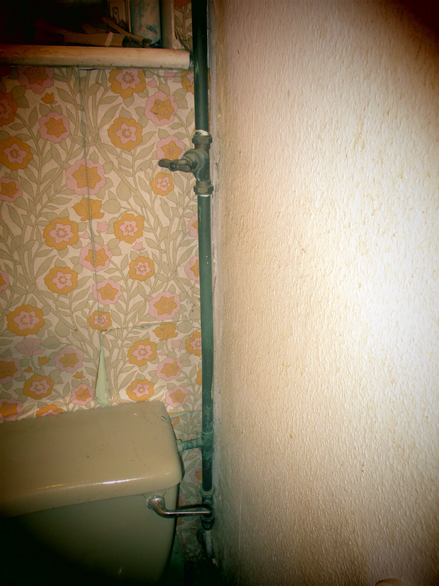

Incidentally, the photo IMG_9467 shows that there is a gate valve between the loft water reservoir tank and the WC. The top of the pipe containing the valve, goes to the loft water tank, then moving down this pipe we reach the gate valve, then the connection to the WC, and finally it (the white PVC tubing at the lowermost end of this pipe) goes to the bathroom adjacent to the Loo.

Ime, it’s usually the float valve passing water via the internal overflow, not the actual syphons.
Thanks CountryFan. What do I do to check if it is the float valve which is faulty? Remove the cistern cover and hold the float ball up, and see if the water is still forming the ripples?
To Herts P&D, if you mean the orange colour of the first photo, then its a trick of the camera flash used to get a clear photo of the water ripples. The toilet bowl is clean. It took me 5 attempts to get a reasonable image of the water ripples.
UPDATE: I held the float ball up for 3 minutes. It made no difference to the water ripples. That rules out the float valve as being faulty.

@denso13 "Turn off the feed to the toilet and see if the cistern empties overnight."
Will do this tonight and report the outcome tomorrow.

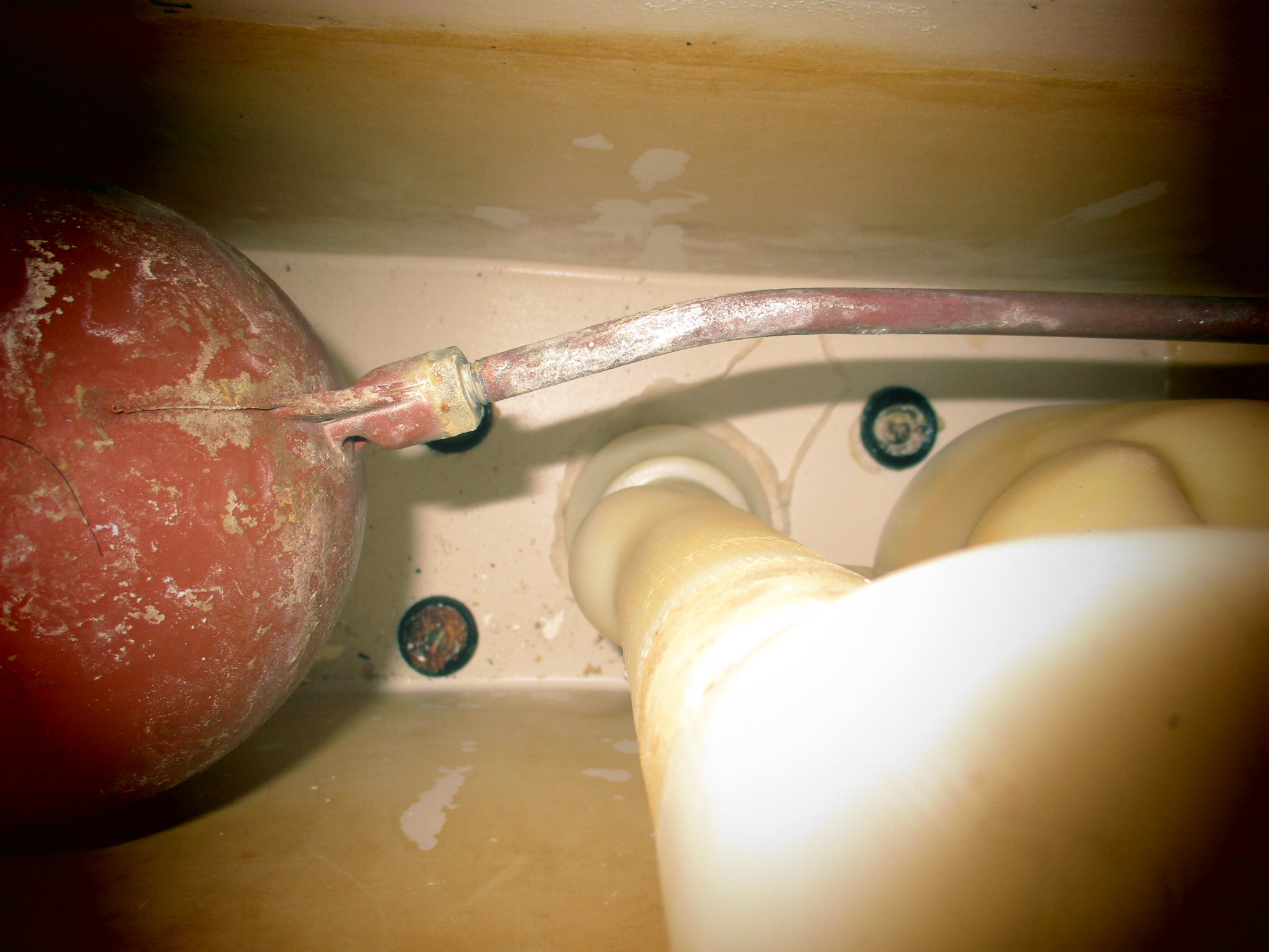

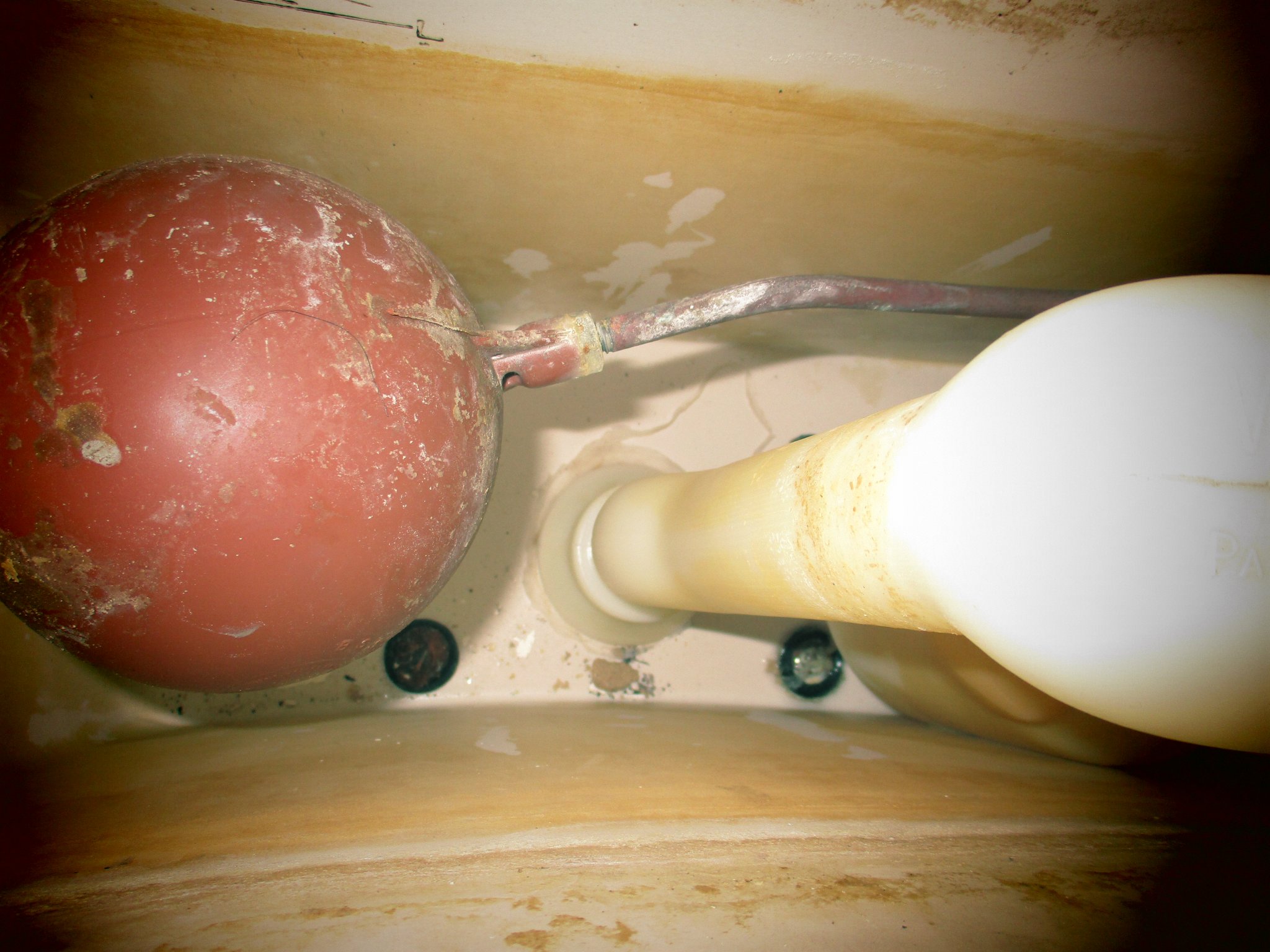

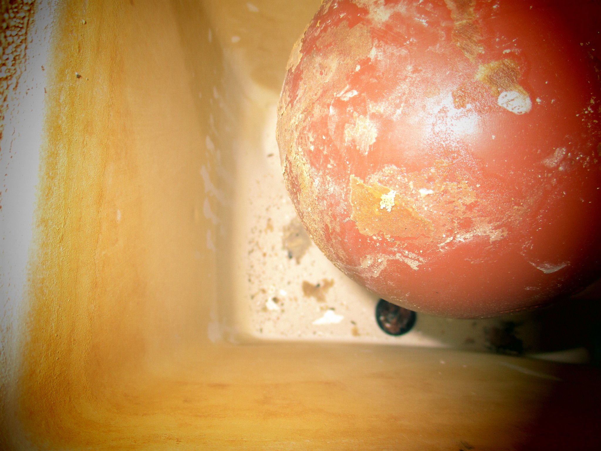

8 hours after shutting the gate valve, I opened the cistern this morning. As you can see from the attached photos, the cistern was bone dry inside.

Definitely a syphon problem then, you'll need to remove the cistern from the pan to replace it.

Disconnect the supply, loosen (or cut off) the bolts holding the cistern to the pan and remove any fixings holding it to the wall, then lift the cistern off.

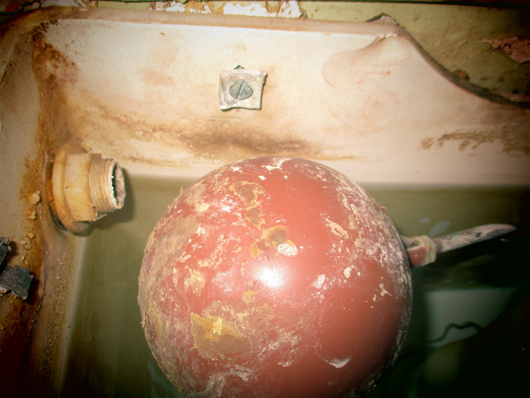

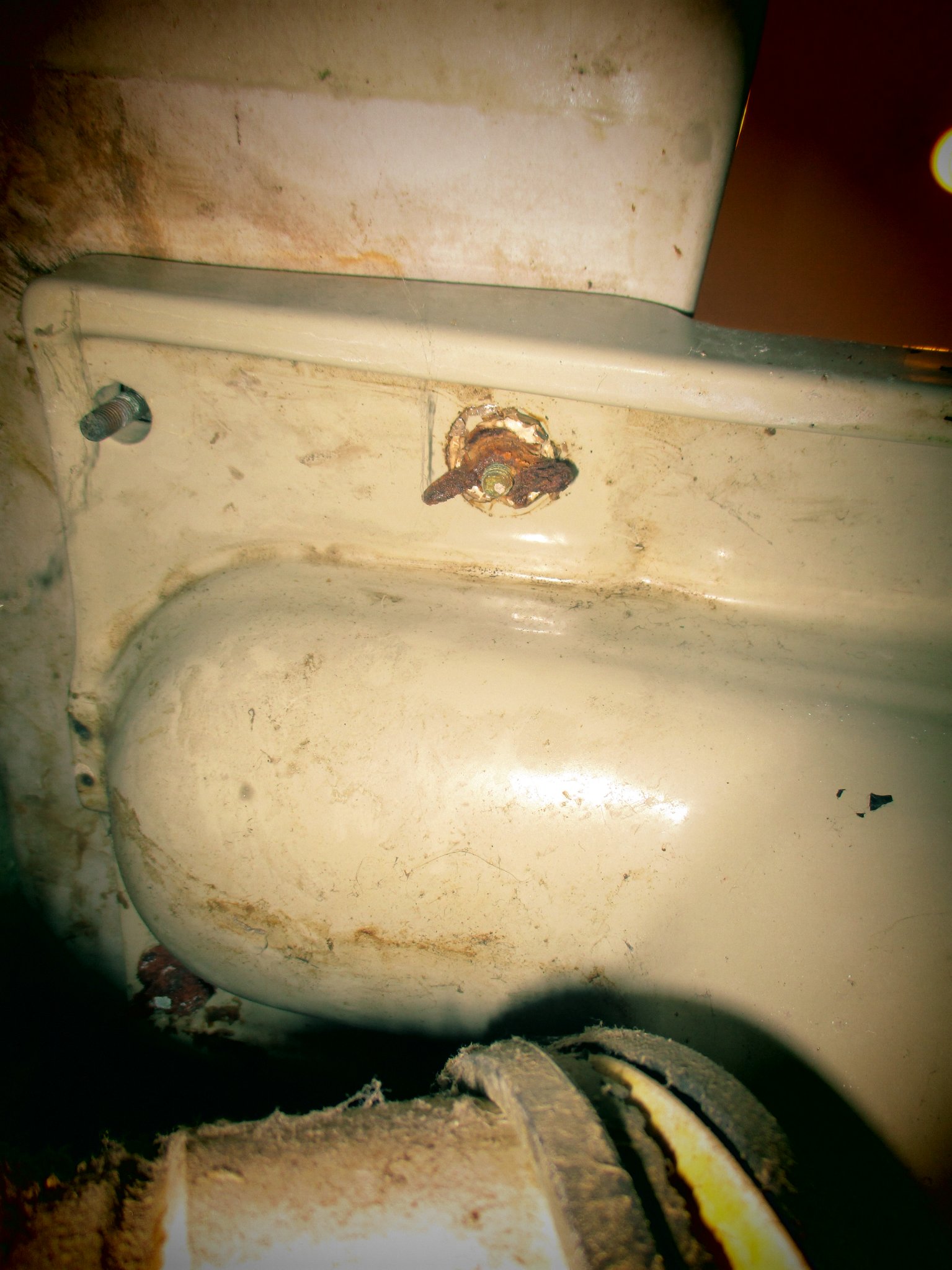

(a) Wall fixings: there are two of these, one on each side of the cistern, near its top (see attached photo IMG_9472) which shows one of these. Each one is made up of a M4 or M5 screw with a large square (15mm or 20mm) washer. Both of the screws are loose and should be easy to remove. I presume there is a rawlplug type lined hole in the wall to receive these screws.
(b) Cistern to Pan fixings: There are 4 of these. Inside the cistern each fixing is comprised of a M4 or M5 screw with two washers. A large metal penny washer atop an equal sized black neoprene washer (presumably for a water tight seal when the neoprene washer is squeezed between the metal washer and the cistern base) . These 4 screws are on the base of the cistern. The screws pass though holes in the pan, and are held in place by Butterfly nuts. The nuts are quite rusty.
Two of these fixings are obstructed inside the cistern, by the syphon, making them had to reach. I will need a long screwdriver to hold the screws stationary while I undo the butterfly nuts on the underside of the pan.
(c) Inlets & outlets: There is a compression jointed water inlet tube which mates with the float ball valve inside the cistern.
This will have to be loosened before the cistern is removed.
I HAVE NO IDEA ABOUT THE WATER EXIT CONNECTION OF THE SYPHON AND WOULD LIKE YOU TO ADVISE ME ON THIS.
