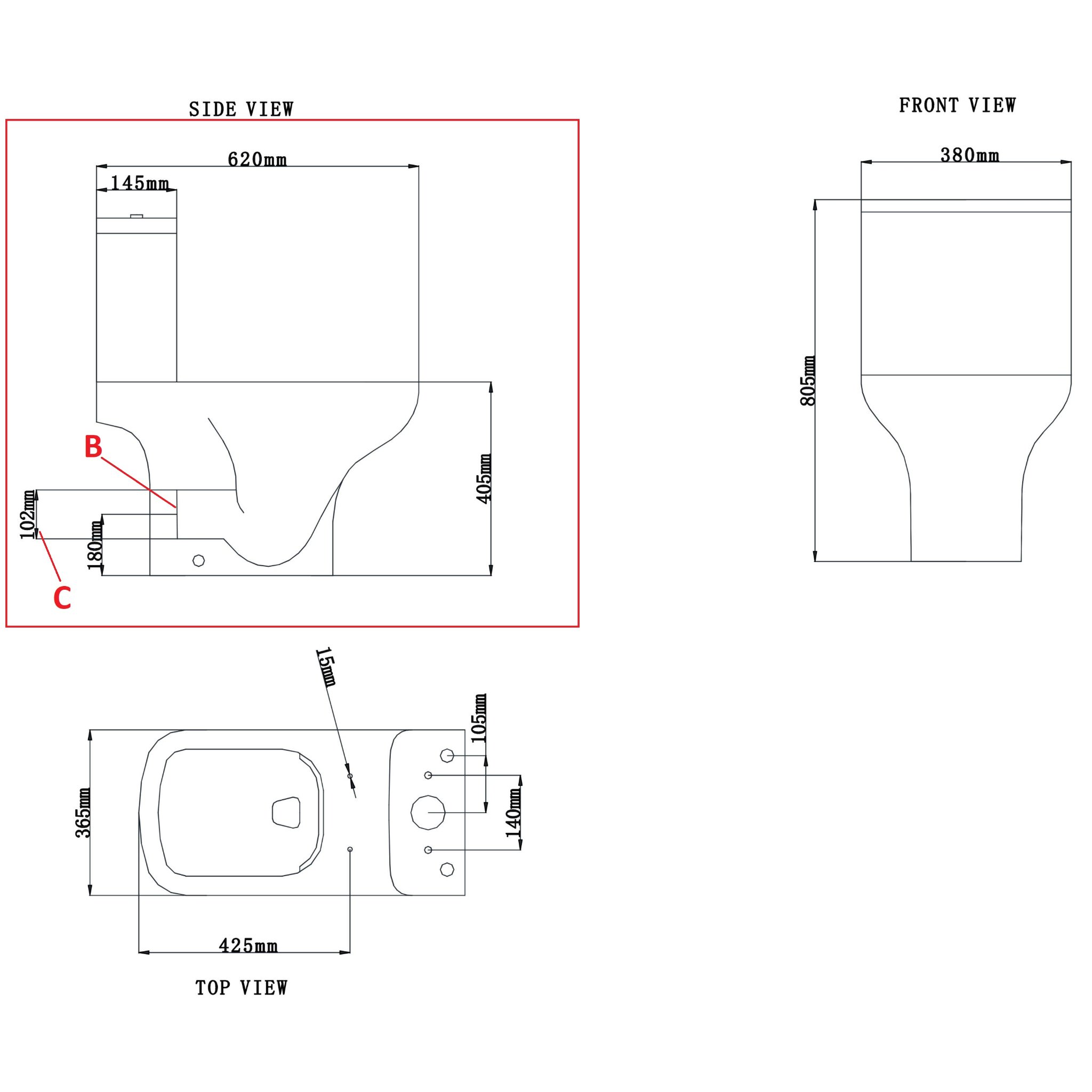

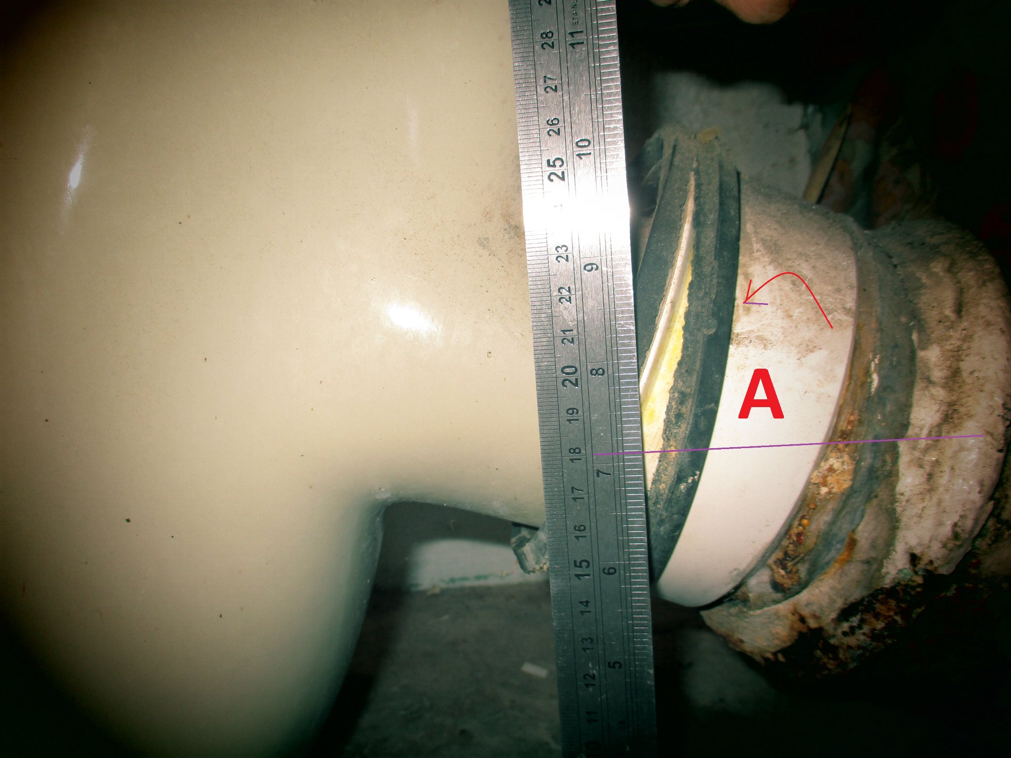

We come now to attaching the new WC to the sewer. Attached to this post are two images. The photo is of the existing sewer connection and the drawing is from the Wickes website detailing the new WC's outline. I draw your attention to the red boxed section of the drawing. Question: Where does the sewer connector pipe end, at B or at C?
In both cases B or C, the midpoint of the sewer pipe is 180mm from ground level.
Now look at the photo. I have placed a ruler on the ground next to the existing WC's sewer exit pipe. I have drawn a purple line horizontally to the right, at the 180mm mark. We can see that the adapter, labelled A, will either have to be removed and/or replaced with another adapter which is angled more counter-clockwise (in the direction of the drawn red arrow) to mate with the sewer pipe of the new pan.
Question: Where are adapters such as A available?
Question: Using the info given here, which adapter should I buy?
Question : Do I need a sealant to seal the WC's sewer pipe into the existing sewer connection/or into the adapter and the adapter into the sewer connection to prevent water/gas leakage? If yes then what sealant do you recommend?

But this looks like your best bet:
Andy

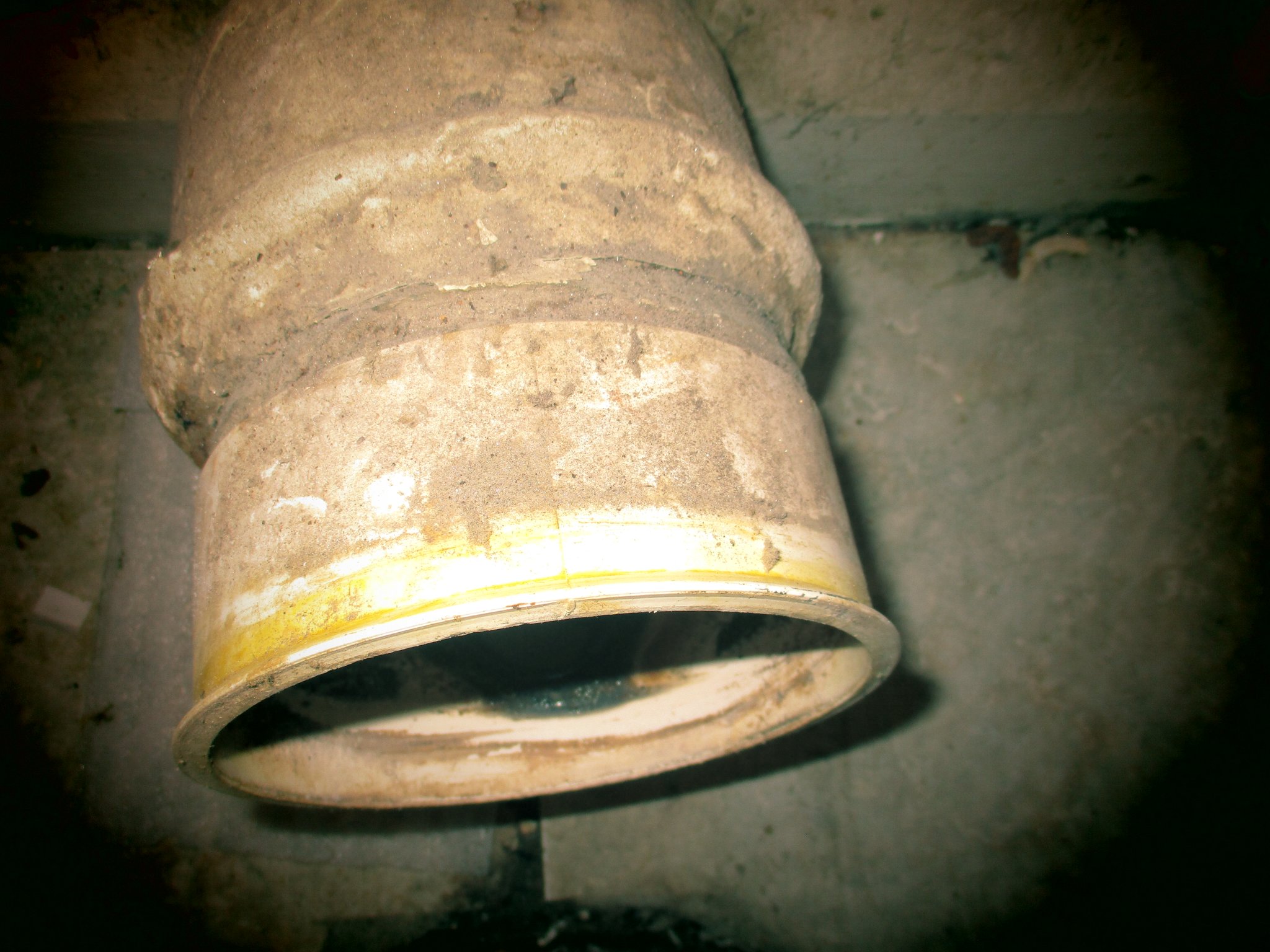

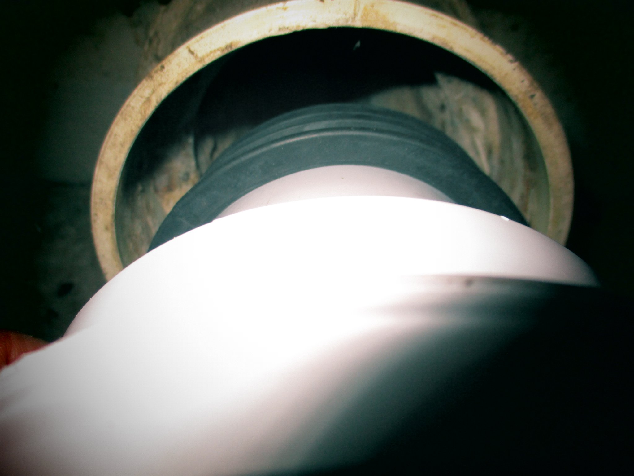

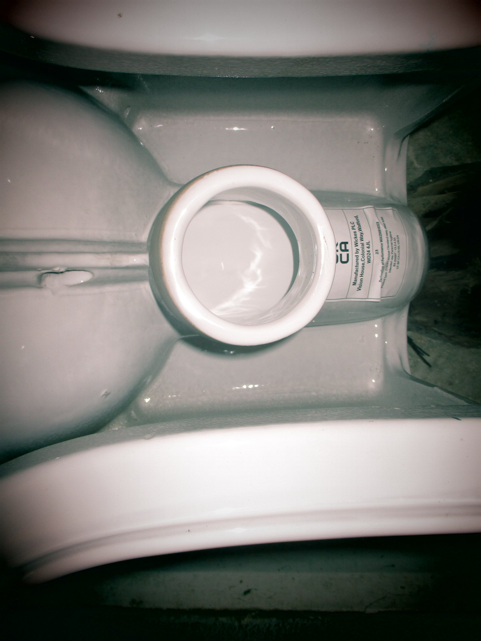

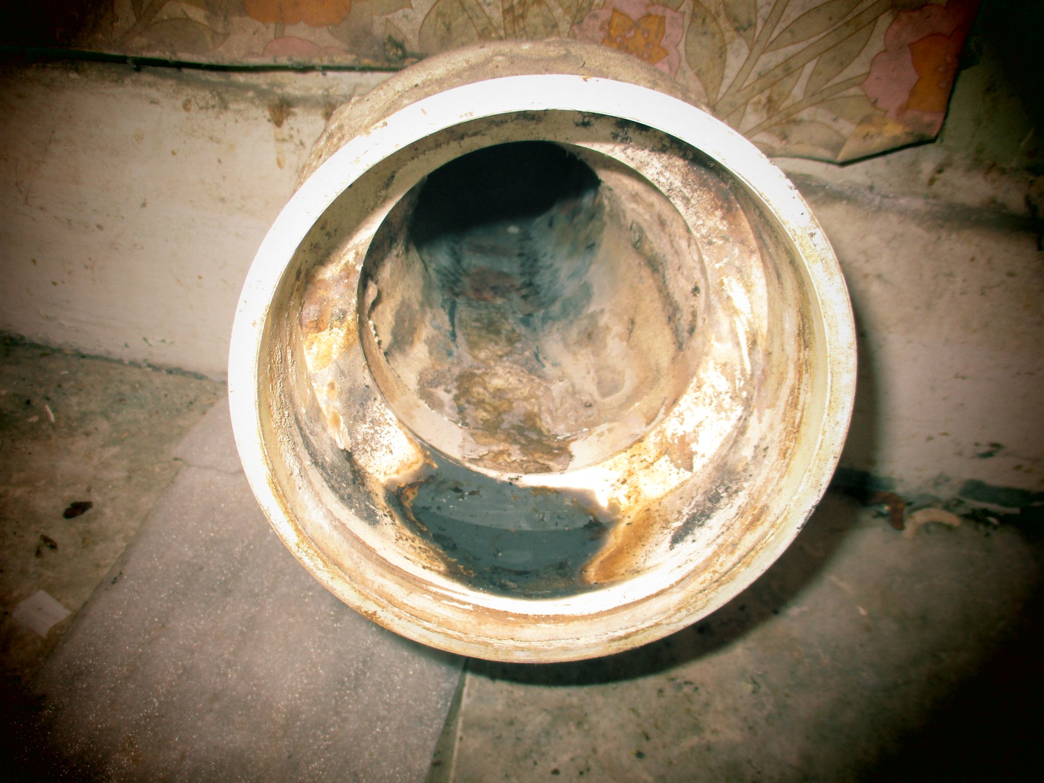

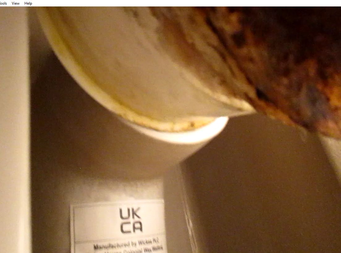

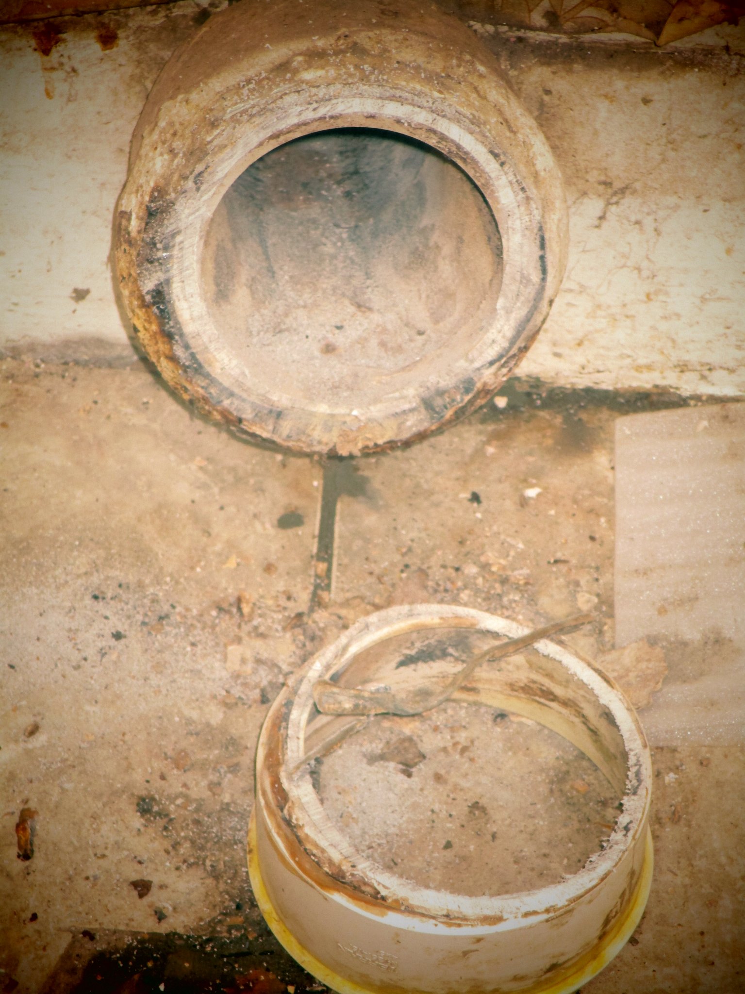

Well the old WC is out and the new one is in. But there's a problem. The OD of the pan's drain pipe is 100mm, which snugly fits the inlet gasket of the Floplast connector of post #53. But the exit side of this connector has a concertina gasket with OD = 110mm, whereas the ID of the sewer pipe is 130mm. IMG_9509 shows the sewer inlet, IMG 9508 shows the gap between the Floplast adapter's exit end and the sewer inlet. The photo NoAdapter shows what it looks like when the pan's drainage tube is abutting with the sewer inlet WITH NO ADAPTER IN PLACE.
IMG9510 is an overhead view of the sewer inlet and IMG9511 is a shot of the pan drainage tube. I looked for a 130mm OD EPDM gasket to fit inside the sewer pipe but found nothing. Other than that I am thinking of using the following connector
Although it may be too long to allow the cistern to abut the wall as it should.
Your advice please gentlemen.

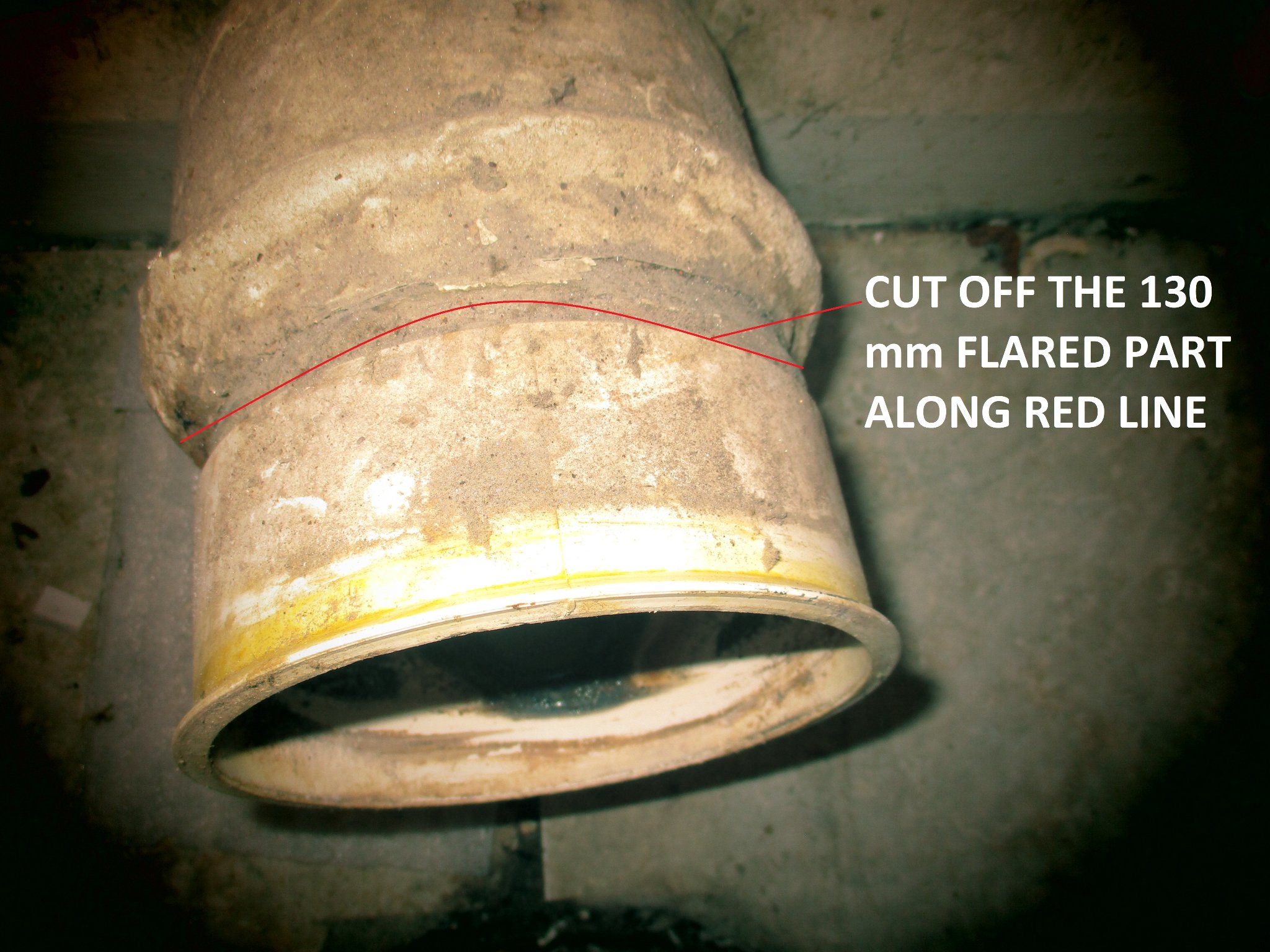

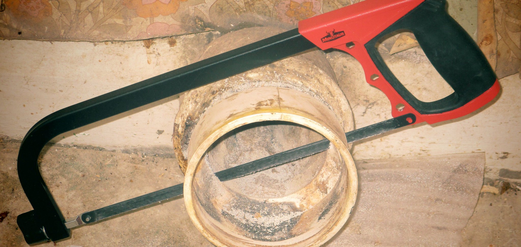

EDIT: Closer inspection of IMG 9509 shows that 130mm flared part of the sewer tube is topmost part. Further into the pipe, the ID drops to the standard 110mm sewer diameter. I am thinking of using a hacksaw to cut off this flared part, (as in photo IMG_9510_MODIFY. Then I will use the above mentioned . This will allow me to avoid using a 130mm sealing gasket AND allow the cistern to closely abut the wall. Is this feasible?

Shove the pan con past the flange...
If need be, cut the flange off!
It's the throat size that is what matters!
Else get a mcalpine DC fitting to convert to 110mm.
Well, Thanks to you Andy (post #53) & Dilalio (post #58), I've made a lot of progress. I sliced off the flange IMG9509 in post #57, IMG9515 & IMG9516 in the current post. This is because it serves no useful purpose and simply acts as a stand-off spacer in connecting the new pan to the sewer. With the flange off and the adapter Andy recommended, plus the shoving that Dily suggested, the pan is now shoved up right next to the wall and the adapter-connector is rammed down the throat of the cast iron sewer pipe. I have also connected the water inlet to the cistern to the old compression fitting in the water inlet pipe of the previous cistern, using 900mm flexible hose.

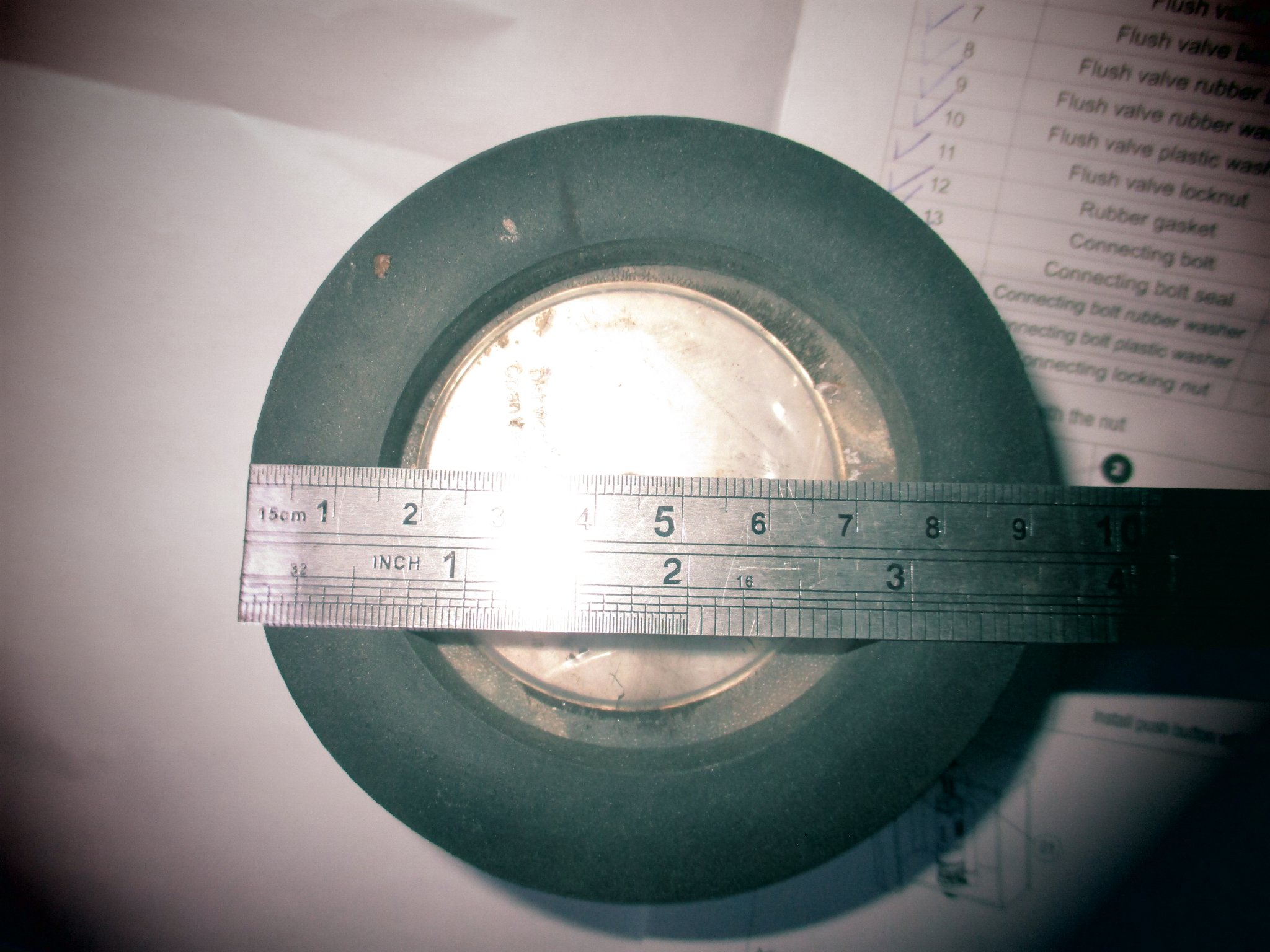

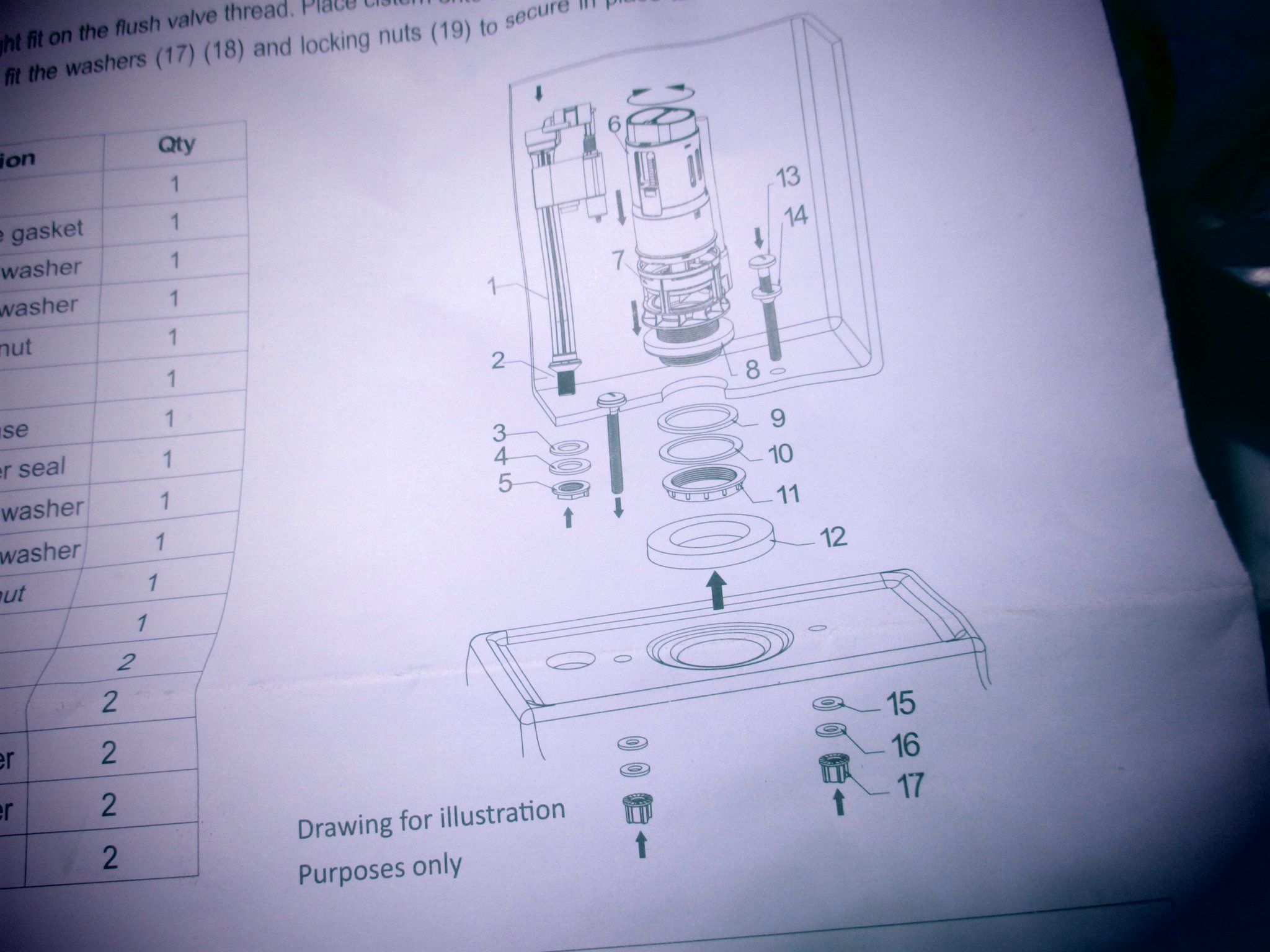

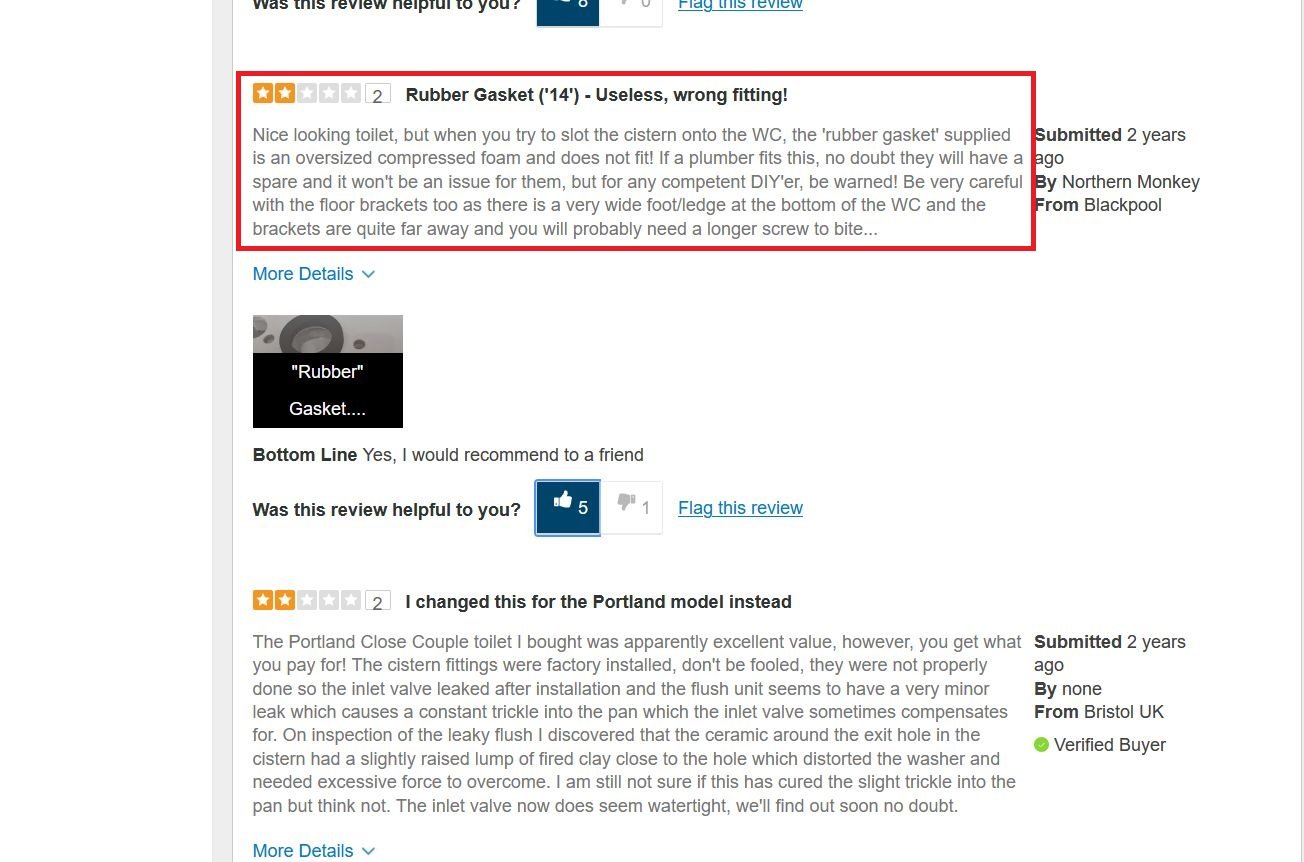

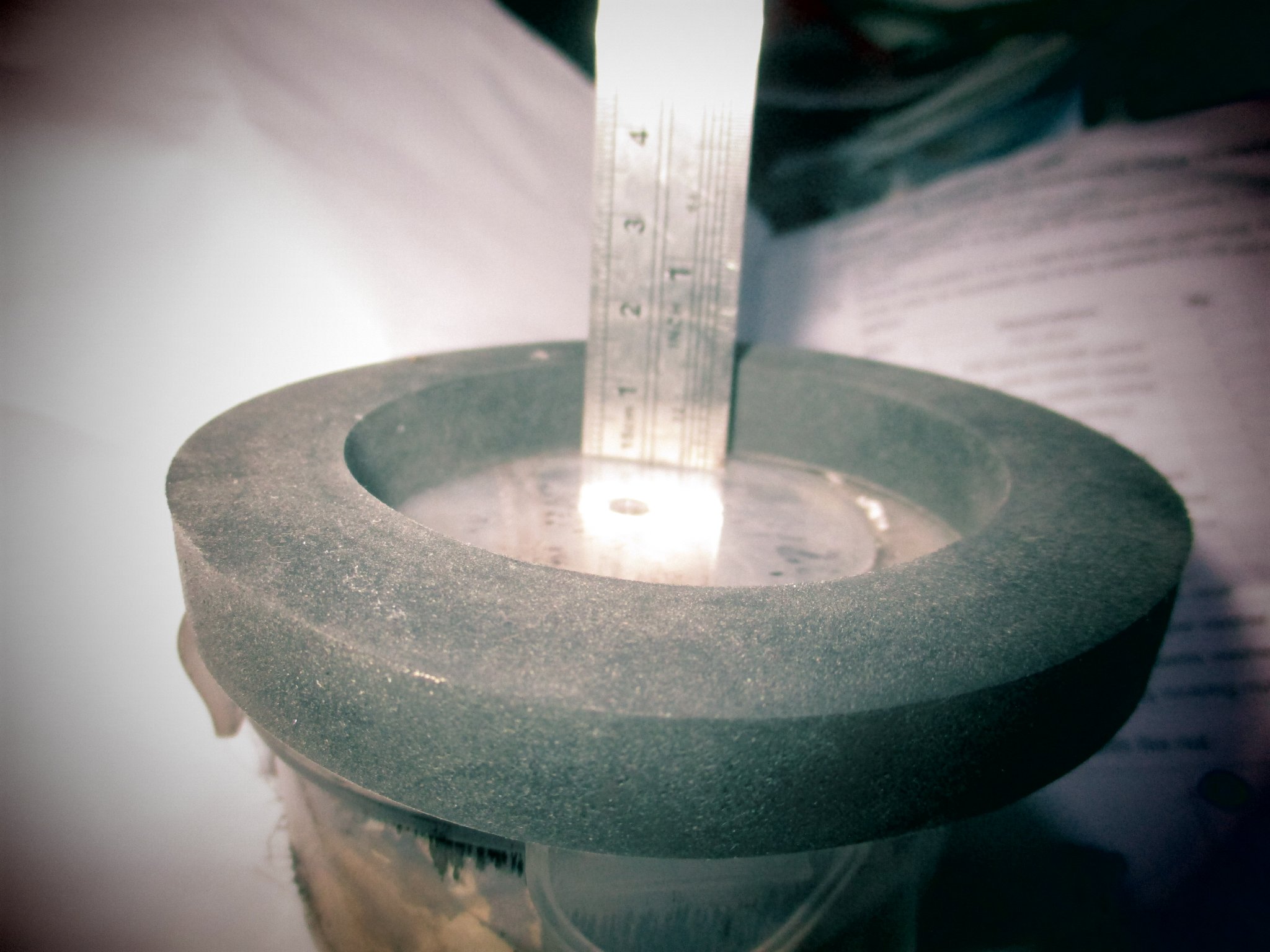

I then proceeded to place the cistern on the pan. There is an 11mm thick foam neoprene washer which is placed on the cistern's water outlet pipe's nylon retaining nut (item 12 in the assembly drawing IMG_9523). But this washer is much too thick at 11mm (IMG-9522). With this washer in place, the cistern is too far above the pan and wobbles from side to side about the washer. Previous constructors have also pointed this out in the Wickes Product Reviews for this WC (see the Attachment labelled Gasket Problem). I have laid out the gasket in IMG_9524. Its OD = 92mm, ID = 63mm, thickness = 11mm. I need a washer with the same dimensions but 5mm thick. Where can I get it? Can I omit this gasket since it seems to be sealing nothing. In IMG_9523 item 9 is a neoprene washer, item 10 is a plastic washer and item 8 is the Flush valve rubber seal.
