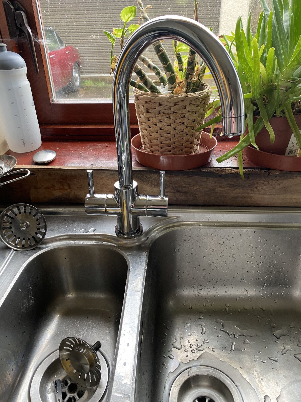

How to replace this kitchen sink tap?

OK, I did as I was told. I undid the bolt with the tube spanners and hacksawed the old tap off.
Then I connected up the new one.
All went well.

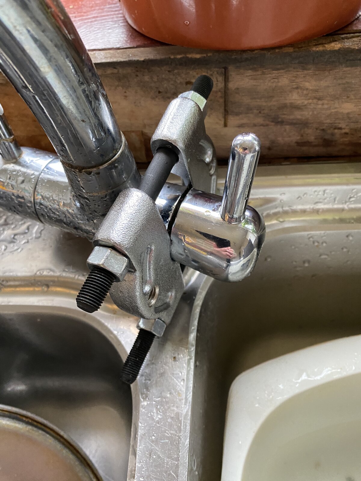

Before I went the whole hog trying to replace the tap, the wife suggested just changing the cartridge on the old one.
For a laugh I took the screw out and tried to get the shroud off.
It went as well as I expected so it was back to Plan A.
Couldn't even get it off with bearing separators.
