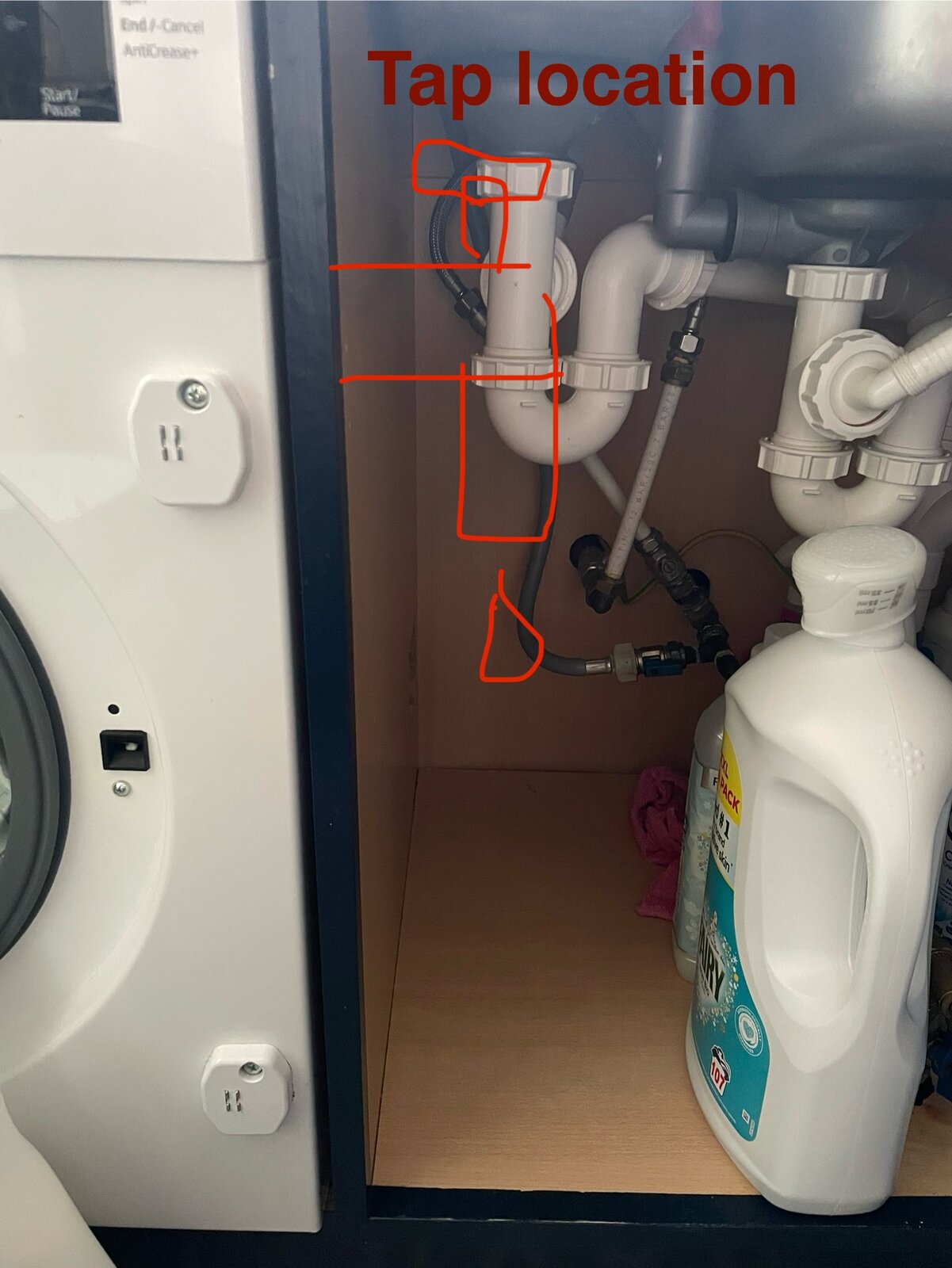

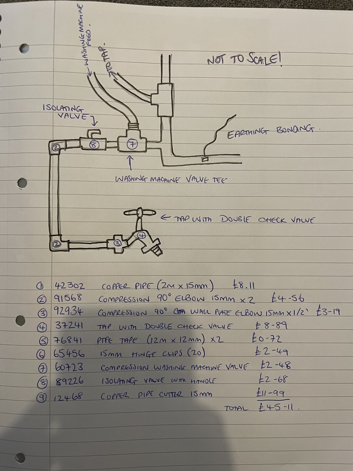

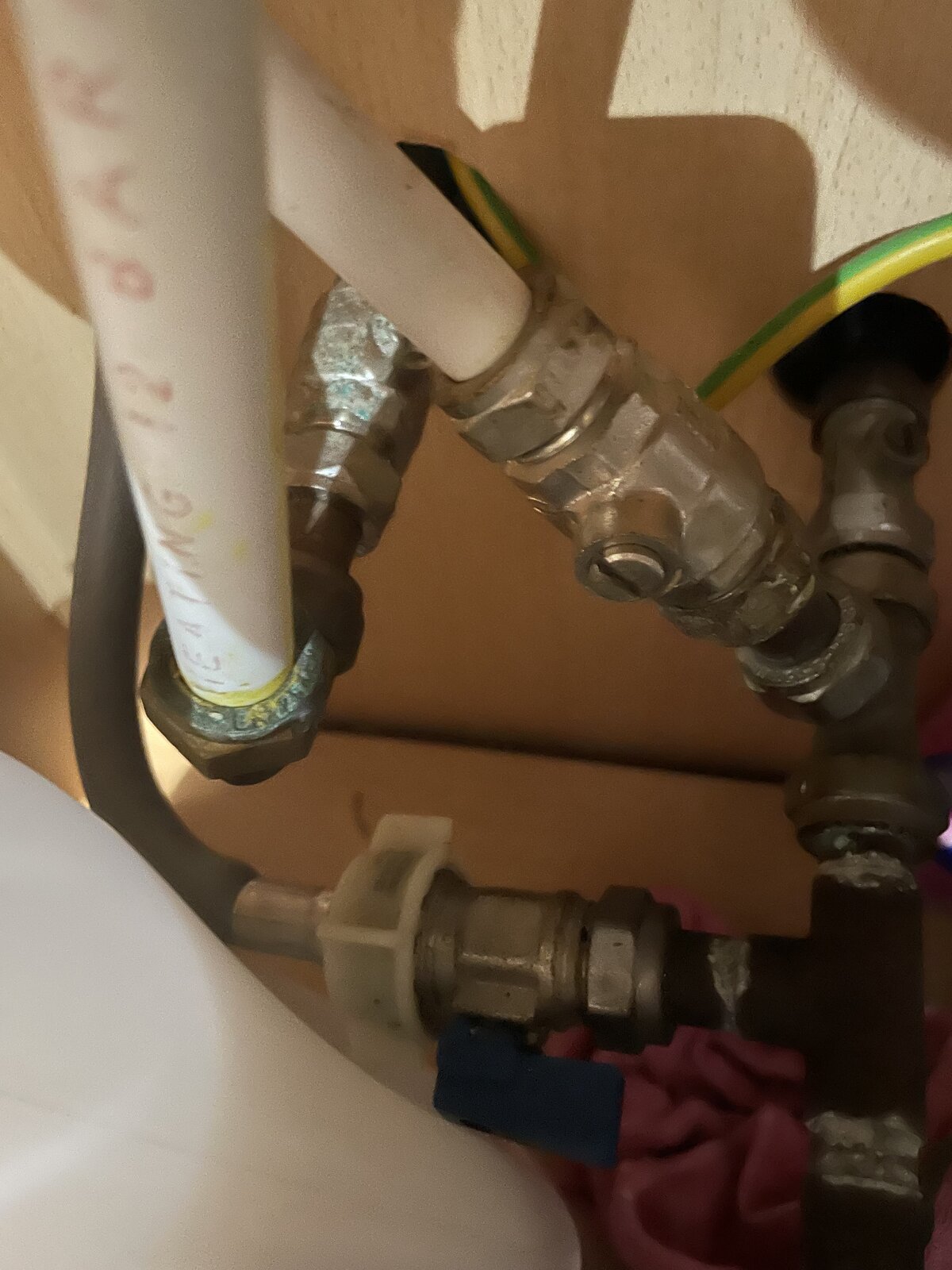

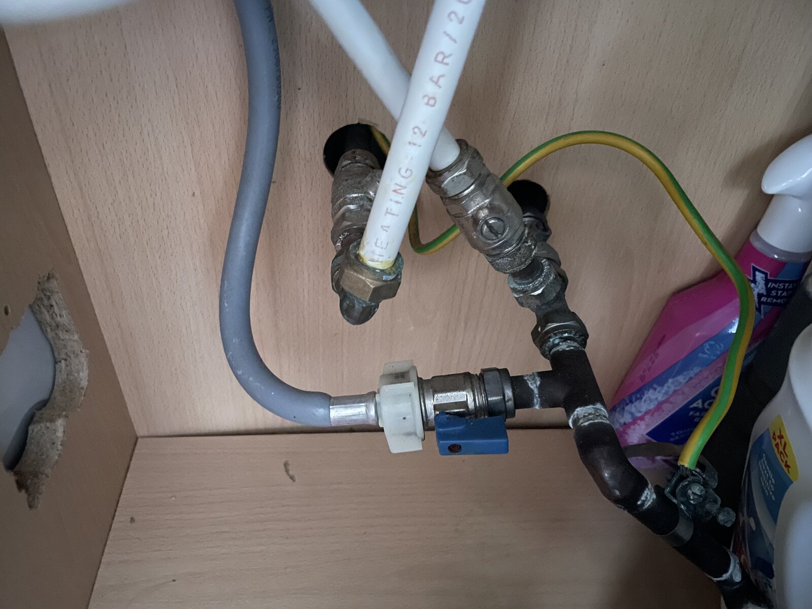

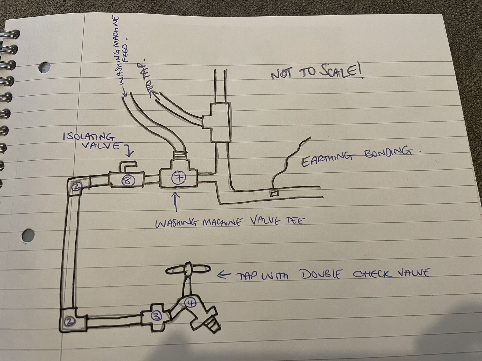

Howdy!
In my kitchen under the sink I would like to install a tap for using a power washer. The reason I’m thinking of adding it under the sink rather than outside is that it saves some of the work cutting and running it all through the outside wall. Also wouldn’t need to worry about the pipe freezing over in the winter.
I’ve added some photos of under my sink as it is and a quick sketch and parts list.
I was thinking of adding a tee valve in place of the existing isolator that currently goes into the washing machine feed and then adding a separate isolating valve for the new tap so that a) I can work casually on the sections after the bale with no rush once it’s fitted b) if there are any issues later down the line I can simply isolate the tap.
I was considering mounting the tap to the inside of the cupboard next to the washing machine (as my superb art skills show in the pic) but wasn’t sure if this would have the strength to hold it.
Any thoughts/suggestions welcome.
Have I covered everything?

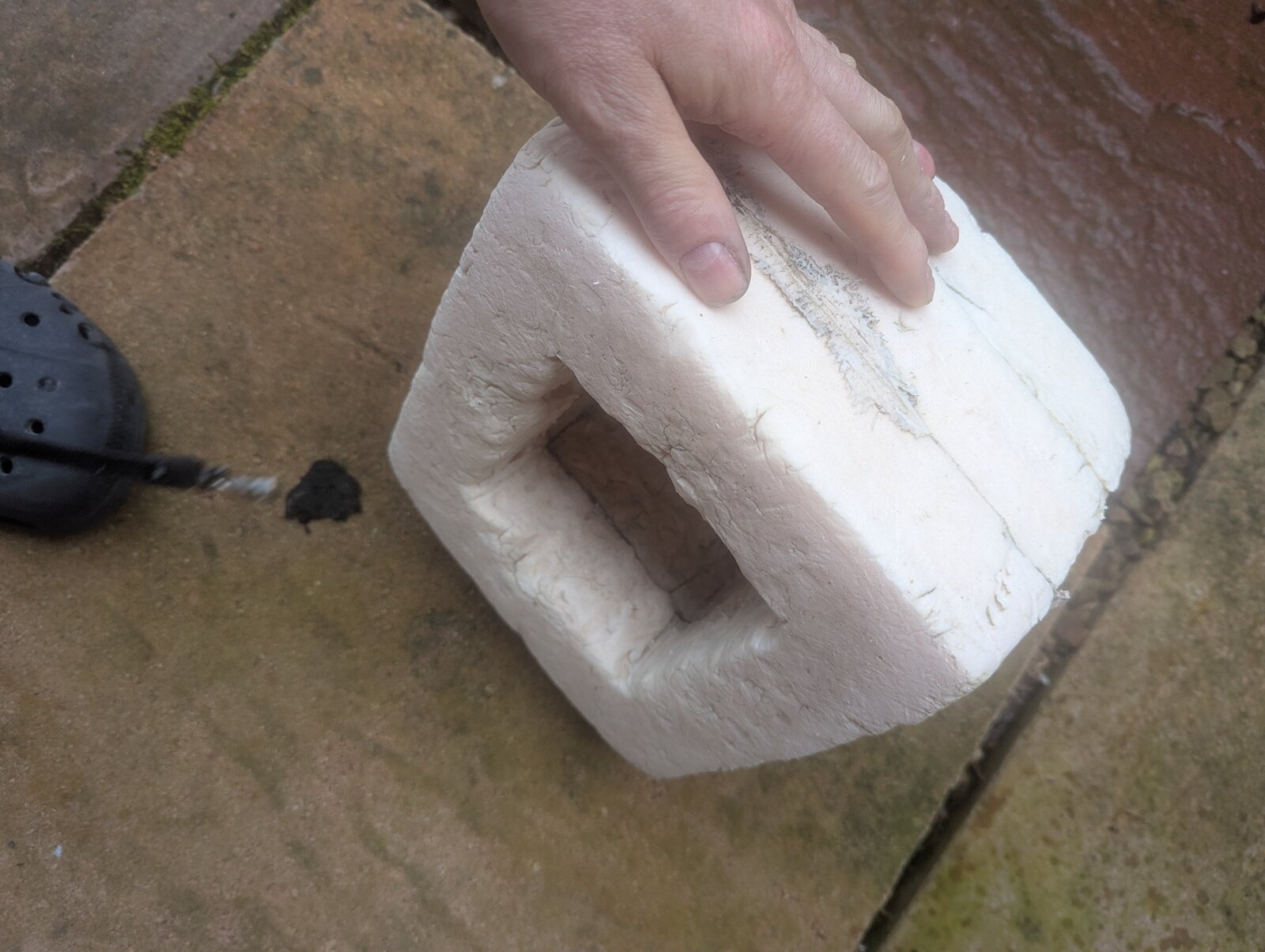

I cut up some polystyrene and stuck together with silicone. It covers the outside tap in winter. I never turn outside tap off. Just seems daft to do that imo. I need the tap all year
I'd run tap outside. I'd not want one under sink. They leak a bit when being used and you won't know. If you can't fit yourself get local plumber. Have ago yourself. Don't dog things up though all keen or you will have leaks.
Tap cover.

The issue with the tap is not with it but with what is connected to it, if you are using say a hozelock plug on connector they can fail suddenly... who has not had a gusher and they can also drip in use even if properly connected. Also as the tap is under a cupboard these too can drip and fail with no route to the drain.
You might be better off fitting a good lever ball or gate valve with complete isolation and then fit enough hose using a permanent coupling to get you out the house to the hozelock.
I would also fit a one way check valve to prevent any back flow.

Also can I still run an outside tap with the same items I suggested in my original post and fit a tee valve instead of the isolator that already feeds into the washing machine?
Err not really tee valves are for dual appliances eg a dish washer and a washing machine.
I would take a feed to where you want the tap, is the kitchen the closest point with a cold water feed... do you have a downstairs loo ?

You can tee off where you find it easiest...ie just before the washing machine connector.As for bits... whats your skill level. All Plastic is the easiest, compression fittings and plastic pipe, all copper and compression, or soldered copper fittings and pipe in ascending order of difficulty.
If the outside world is behind that cupboard, drill through the wall and run some clipped insulated ( ie the round foam stuff ) pipe along to where you want the tap.
So a tee, isolator and double check valve ( or if space is tight a combined one - https://www.bes.co.uk/double-check-valve-with-isolation-valve-15mm-15584/ ) pipe, elbows, clips and insulation and the tap.

I’m thinking copper compression fittings throughout as I guess i’m going to have to run copper through the wall anyway and was thinking of using a hose union back plate for a nice finish on the outside and to fit the tap to.
If I was running a hose using back plate with copper pipe included I assume I would still need the insulation. How thick should the installation be and is there an easy way to run it through the wall or just get the hammer drill out with masonry bit and take my time?

The pipe has earthing, does that mean I need to turn off the electrics whilst fitting the tap?
Can the tee come off any run of pipe where there is most room and it’s convenient for space or does it have to be a in a certain place after/before certain fittings?
Sorry been at work... no you do not need to turn off the electricity unless you disconnect the earth strap, tee off where is easiest and to be fair the side you drill from is really a question of where you can best do it from so the pipe work lands in the right place.
