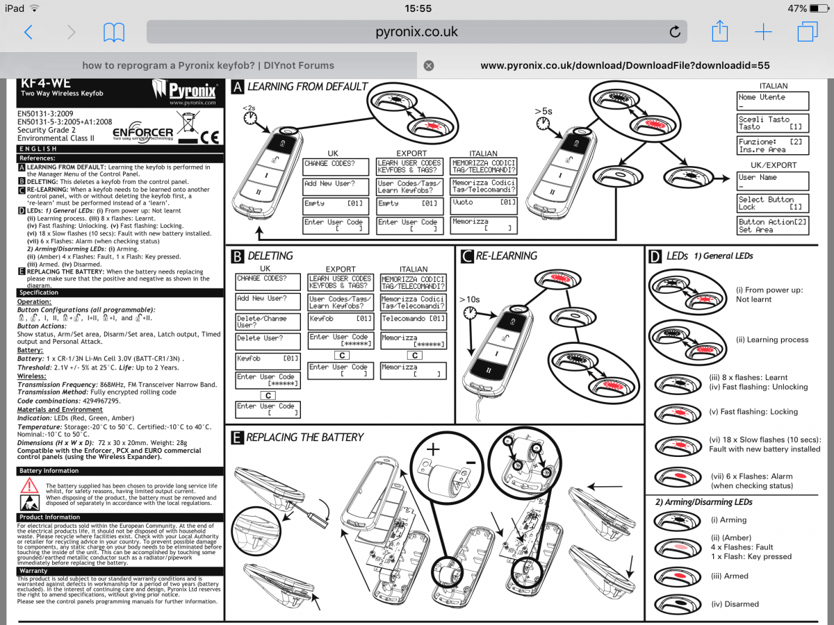

can anyone advise how to reprogram an existing Pyronix keyfob to a new Enforcer panel? The keyfob is one of the new type, rectangular (not square) with the four buttones one above the other.
I've tried removing the battery to no avail.

It IS in the User Manual, under the heading >>>> Change Codes (Adding codes, tags and keyfobs) - perhaps someone tore out the page you should have :LOL:
I don't think it's a new one , it's like importing tag on a premier it's a different operation, the fobs come with a sheet in the box which you don't get if you buy a kit !
You're right - there was nothing in the kit.
So can anyone tell me how to do it?
TT
As stated above, you don't get the keyfob manual in a kit box. The Install and Programming manuals only cover the panel, not the buttons or internals of the keyfob.

It's in there.
As below
Perfect thanks. Thats what I was missing. Much appreciated.
