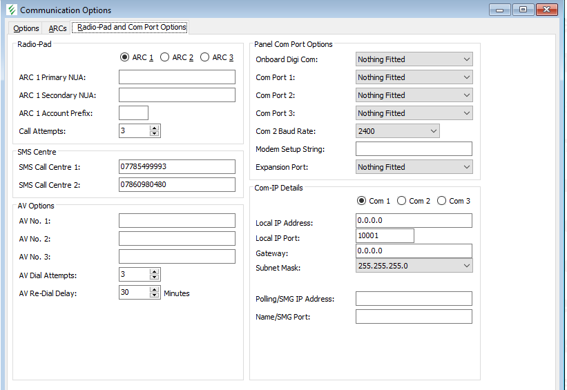

All com ports have been removed in Wintex, and I can no longer connect to the panel from Wintex.
wintex plays no part in the flash process so its settings mean absolutely nothing them being programmed off in wintex, has to be programmed off in the panel.
the com ip module does not need to be programmed up be used, nor does the usb com cable.
I'm not clear on what you meant? The panel was previously configured to use all 3 com ports, with the 3rd one configured as Com IP. The screen shot was just to confirm that all 3 com ports are now set as "nothing fitted", as suggested. And I confirmed via the keypad that the settings had taken.
