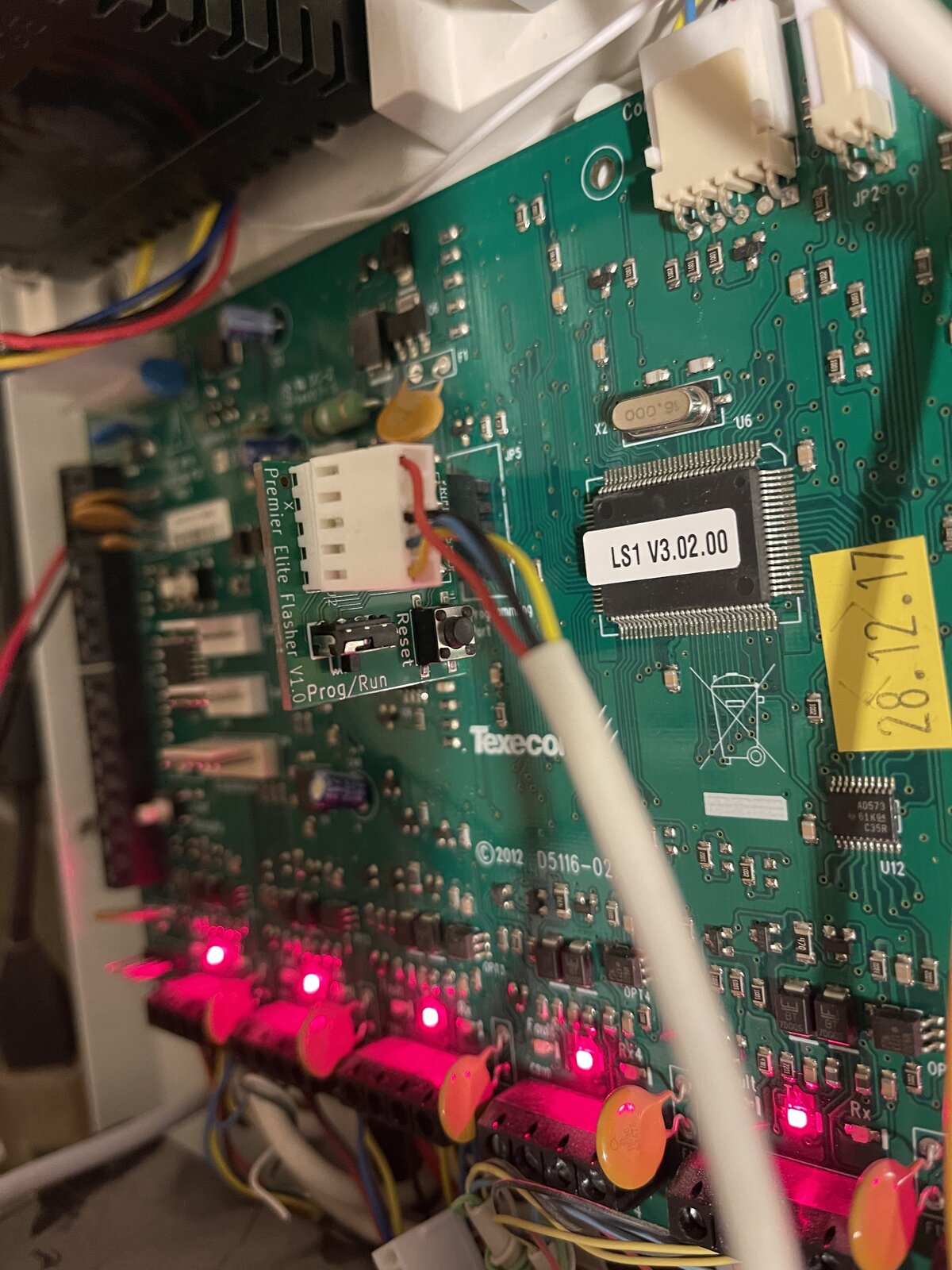

When I plug in the flasher board which is set to "prog" should the panel boot and run, or should the network lights stop?
I've deleted the wireless devices, disconnected and deleted the com settings in the panels, backed up in Wintex, printed out the config, created an installer account and downloaded the v5 PremierEliteFlasher software.
I'm getting an "Establishing comms failed: board failed to respond correctly." error. However, I'm using a PC-Com with a usb to serial adapter (I've tried 2 different ones a Digi and a Prolific.), and the flasher board is not a texecom original. I've tried the flasher board in both orientations. I've been using the USB to serial interface and PC Com for several years continuously to connect to this panel.
In what I expected to be the correct orientation, the panel does not run when powered up with the flasher in Prog Mode, the network lights are red. If I switch to run mode then the panel boots up and the internal sounders sound.
In the other orientation, the panel runs regardless of the switch position, and with one of the PC-Coms it gets a bit further and says something like reading header. Then it fails on "Getting Chip Status"
Do you think it is more likely to be the flasher board, or the PC Com at fault?
Should I have loaded defaults before flashing?
Cheers.
The flasher port has an arrow, along red cable with arrow.
In programming mode the lights out and won't come back until flash complete returned to run mode and press reset the flasher should guide you through with prompts.
Like I say not sure you should be attempting this. As not doing it properly can damage the board specifically incorrect flasher alignment.
Not uncommon to see it done wrong and panel may still be recoverable depending on what is/ was done wrong but not always.
Thanks for the warnings and the replies - I proceed at my own risk! :-) The flasher I'm using plugs straight in - no cable. If I plug the flasher in, set to prog mode and power on the panel the red network lights are solid. Is that the expected behaviour?
The flasher is plugged into a PC-Com, which is plugged into a Digi Edgeport 4 port usb to serial
I load the flasher software, select the com port and click "Flash", press ok twice, then press Reset" on the flasher. I get "Establishing comms failed: board failed to respond correctly."
Am I doing anything obviously wrong? If not then my options appear to be to get a proper USB-Com and/or a proper flasher board.

When you switch to prog and press reset what happens on the board.
would expect the board to have lights out for example.
Failure to flash usually occurs if it’s not correctly connected to flash port and com ports have things connected to and or programmed up
good catch - it is actually unplugged at the other end of the cable which attaches to the com-ip! I'll do a little video in the morning of what happens when I power up the panel and switch the flasher to prog. I'll unplug the PC Com from the flasher so will be just the flasher board. If that video looks wrong to you then that suggests the flasher board is duff.
Panel doesn't like items plugged into com port when flashing via the flash port.
Also program off the comports
