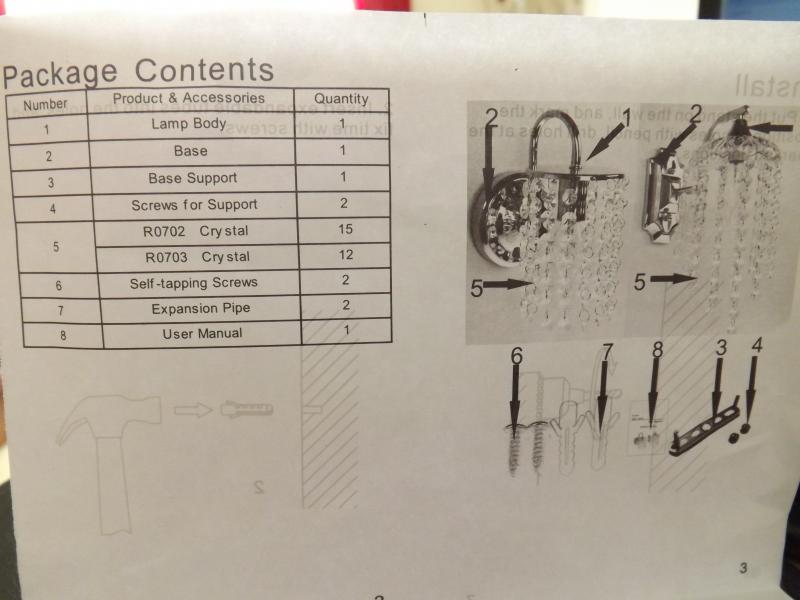

Hi John ... This is everything in the box, except for the shade, hope you can help now.
It would be easier/neater if you have got, or can get, a 4-segment connector block. Alternatively, you could use a separate 1-segment bit for the earth. Something like ....

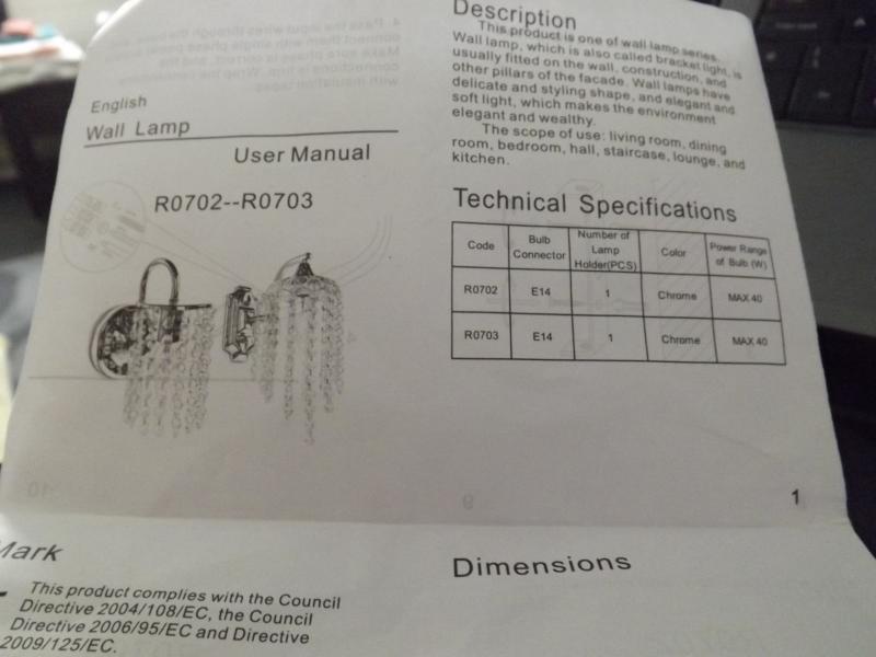

Hi John
I have found these details on another forum, more by luck. Do these help and does you suggested wiring still stand correct to you.
Regards
ray
It does not help when the instruction direct you to wrap the connection in insulation tape!
The instruction are very vague and not much help.
But seems to confirm white is neutral and black is line.

But could that be in the Instructions, which he seems reluctant to post.
Afaik the latest reg 553-03-04 regarding edison screw holder polarity reads different now, whereass before it was only regarding older non BS ones, not sure if it concerns SMALL ES ones nowadays

I have posted them :D
