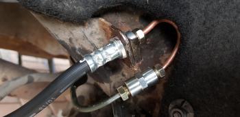

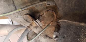

I've had a look at the pipes and they appear to be steel due the brown rust. They're insulated and where they've corroded, are behind a plastic cover.
Need to find a tool that can flare steel pipe I suppose.
The red arrow is the point of corrosion.

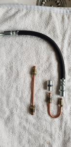

There's the likes of these which I could use to fit these joints.
Useful parts!
I think you'll have an issue forming single flares with hand held gear under the car if the pipes are steel though.....possible enough with cupro nickel.

Access is not an issue, its the long run to the back on the underside of the floorpan and I honestly don't know why the plastic cover was fitted. The pipes are insulated so any sections repaired that will have to be stripped of insulation and a nice coating of grease after job complete.

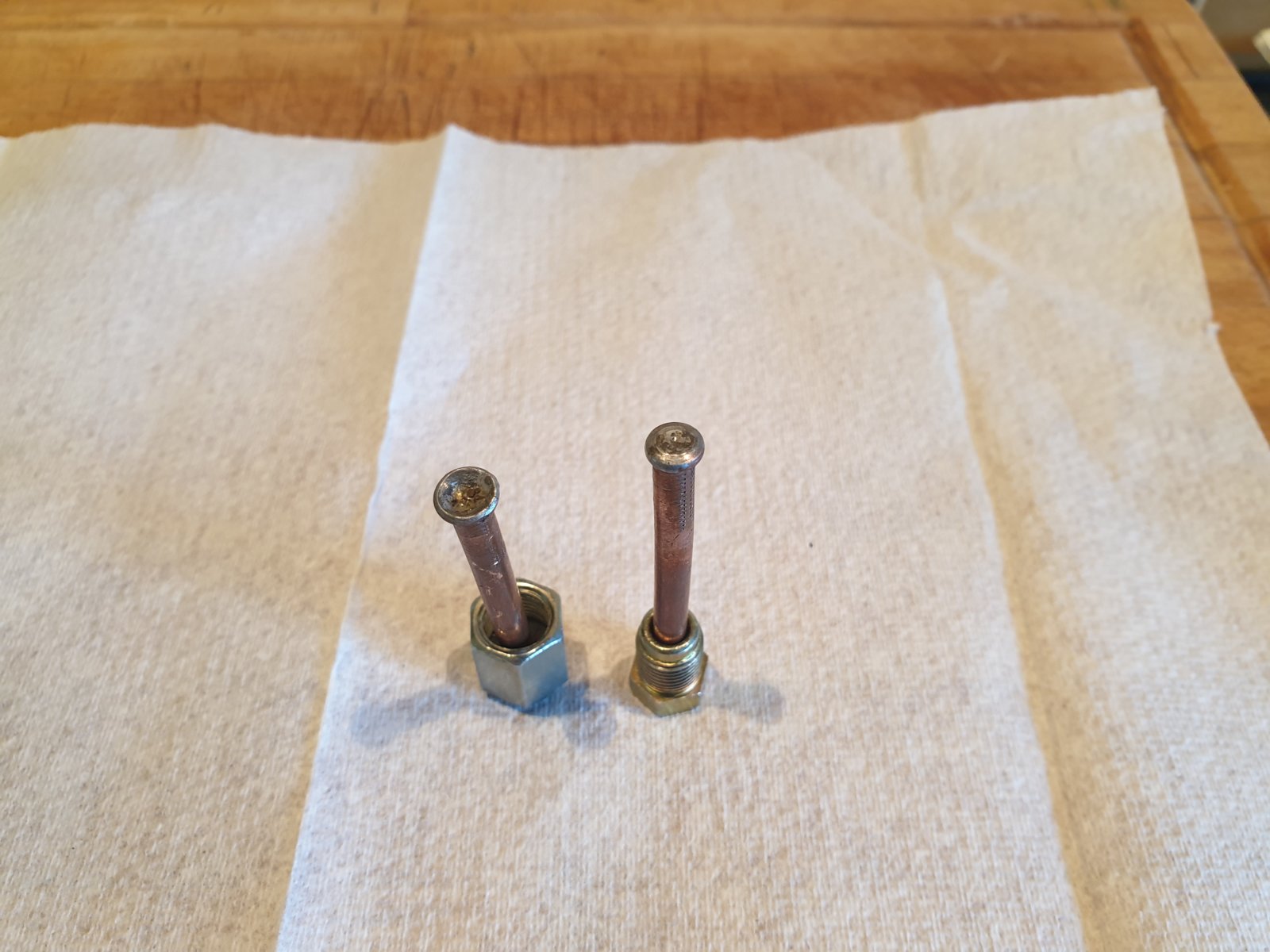

I would suggest that you look carefully at the pipe and decide the best place to cut it. Make sure that the section where you will be putting the new male end is as clean as you can possibly get it because once you cut the pipe you will be losing fluid so you need to be prepared with your flaring tool. Also, as soon as you have flared it, blank it off so that you have all the time in the world to work on the "downstream" part of the pipe.
To blank it off, you can use your new double female connector blocked off with a male in the other end and a piece of rubber or something.
I use these.
It's an Avensis.
I've tried every which way to prevent the fluid running out, now I just prepare for it and make sure that I cut the pipe, get the new end on, flare it and cap it as quick as possible.
