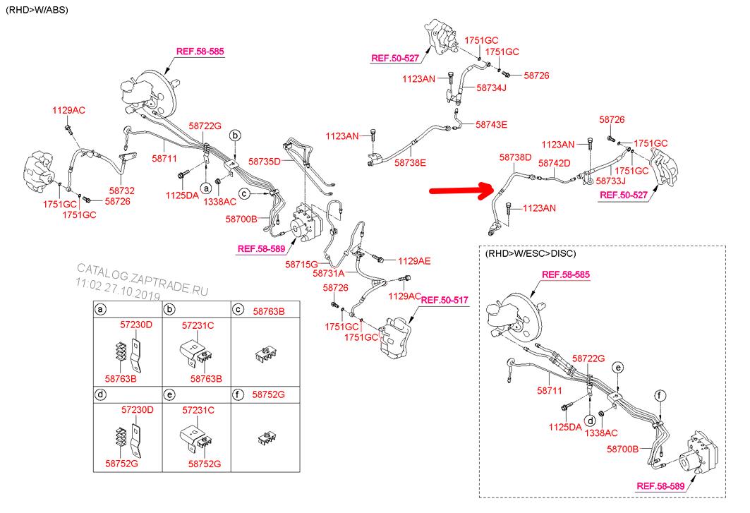

Since there's no flexi pipe to nip upstream, can the rigid/hose, 58738D in the the diagram, be changed without major loss of fluid?
full
Take the reservoir cap off, cover the open thread with a plastic carrier bag or similar, refit the cap. No air can then get in the reservoir so no loss of fluid. (y)
Thanks Motman, I'll give that a try.

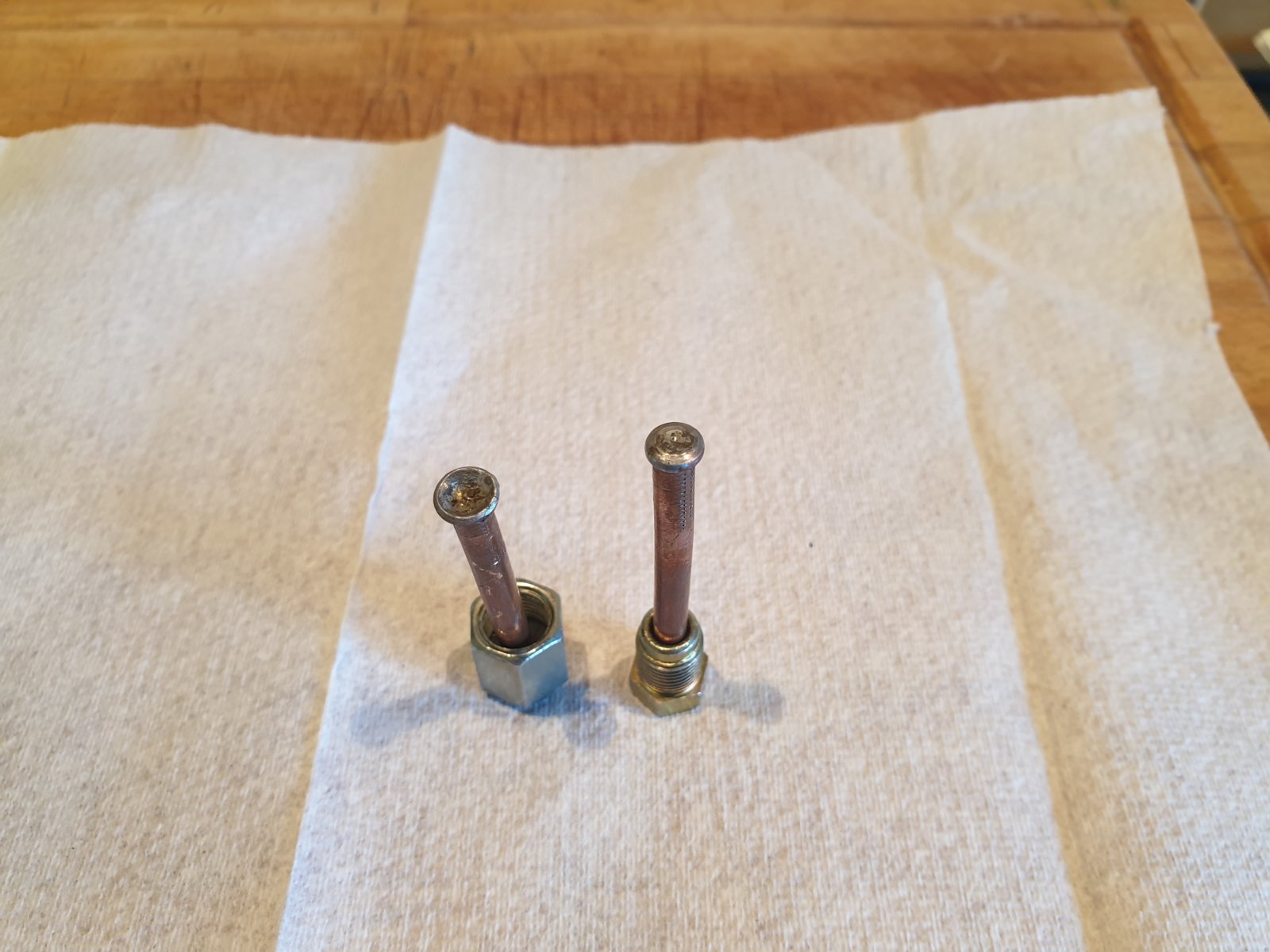

Just to be sure, I usually pop one of these in.
I never cap the master cylinder either. I just blank it off then I have as long as I want to do what I want to do.
Smart stuff (y)
I find the dust cap nipple cover does the male, and those caps from fuel filters or whatever sorts the female.
