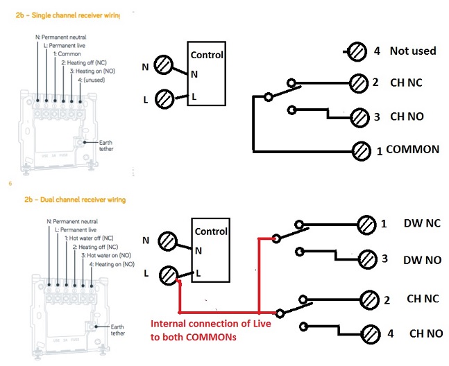

Terminal 1 ( Common ) needs to be linked to LIVE
The Black wire needs to be connected to Terminal 3 ( Central Heating ON )
For clarity
NO = Normally Open contact ( closes when heating is required, terminal 1 is then connected to terminal 3 )
NC = Normally Closed contact ( closes when heating is not required, terminal 1 is then connected to terminal 2 )

That is correct ( has to be as it is working )
One minor point, as the Black wire is a Switched Live it should have a Brown sleeve to indicate that it is a Live wire.
