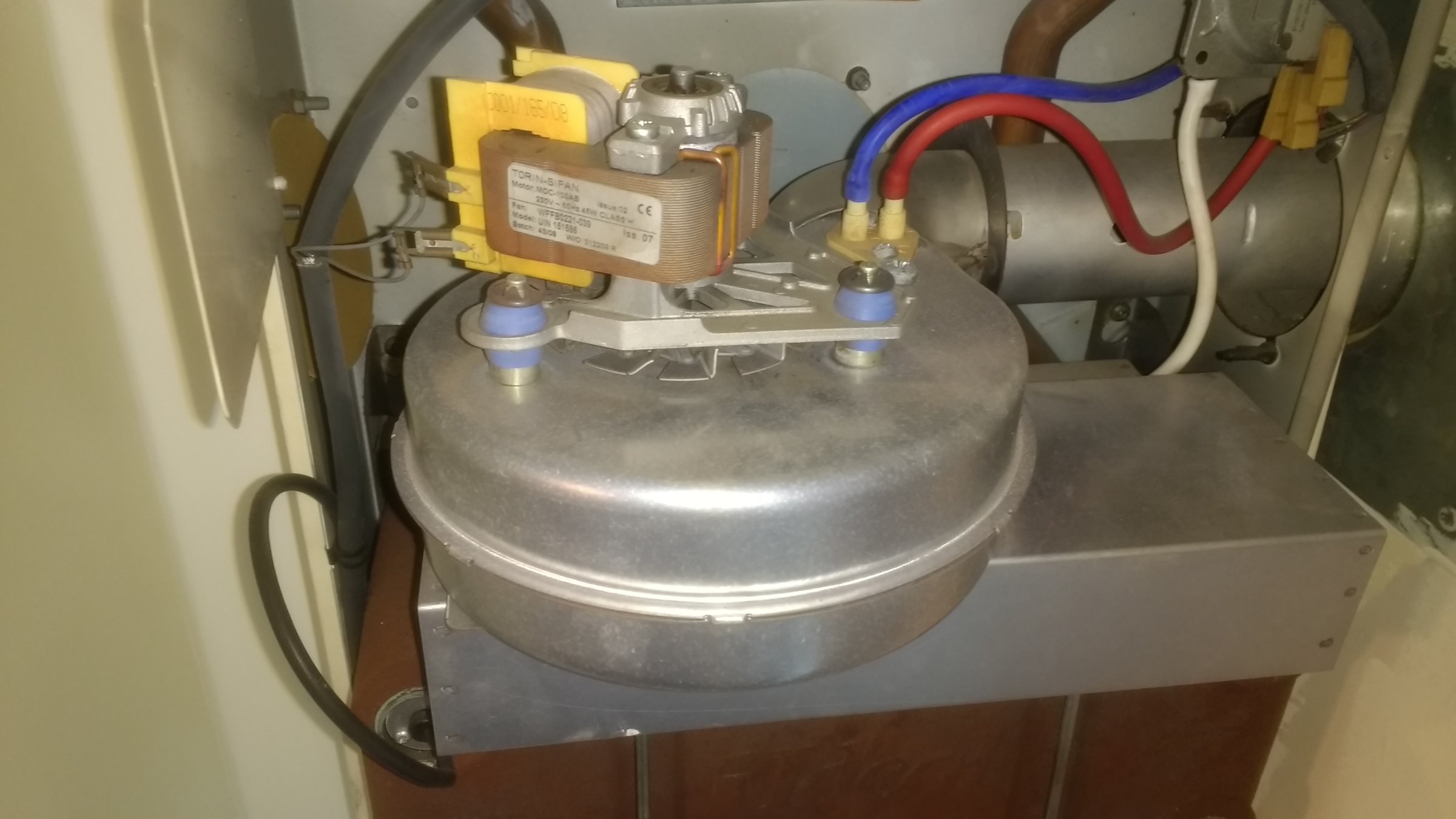

Unfortunately its that time of year when the boiler breaks down at first use :(
Ideal Classic FF240
Think about 10 years old, only lived in the property 12 months.
I returned from holiday and popped the the heating on, there was a bit of a knocking / kettling noise from the boiler.
After a few minutes the boiler cut out, it made a few gurgling noises so i switched it back off.
Now the boiler fires up fine, runs anywhere between 20 seconds and 5 minutes then cuts out.
Then the cycle begins again, the radiators eventually get warm but not that hot.
The old pump (Wilo gold 500) failed just after xmas , a new pump was fitted (Wilo Pico) and it seemed to run fine.
Radiators were also removed at the time and flushed out, Fernox added.
I drained and bled them all again thursday but didnt fix the current issue.
Gas engineer came out on friday, took one look at the boiler (didnt inspect or bring any tools) and said its more than 5 years old, scrap it and replace with a combi.
Wouldnt even investigate the problem.
Had another engineer out today, essentially he said the same... seems they only want to install a new boiler and not fix issues with existing boilers.
I removed the cover to check the fan was spinning as that seems to be a common issue, was spinning but seemed a little noisey.
The heat exchanger however looked quite rusty, photo attached.
Now im not looking to fix the issue myself, just want to know what the likely fault is and whether its fixable?

If the heat exchangers blocked, it will be replacement boiler needed

From the description it sounds like the heat exchanger is scaled/blocked, you could have it descaled or cleaned through, or worst case replaced, however, the system would more than likely need to be cleaned and correctly treated, if sludge is the cause of the blockage.

Good boilers as already advised , dont be in a rush to replace it,they are very reliable and the rust on the heat exchanger is normal.
OP: Lightning #8 is probably not far off. Did your "engineers" actually check anything? First call would be to check ball valve in lift. It can sick in the closed position, and eventually water will evaporate or escape from small/micro leaks. Once the water level drops to a critical level, one loses circulation, resulting in your symptoms. If the header tank is full, then find a magnet. Locate the pipe where the cold feed from the tank enters the system pipework, and test for magnetism. It would be unusual for that boiler t SUDDENLY get sludged to the extent where there is practically no circulation.
The noise suggests the problem IS poor circulation, which would point away from thermostat and fan issues
