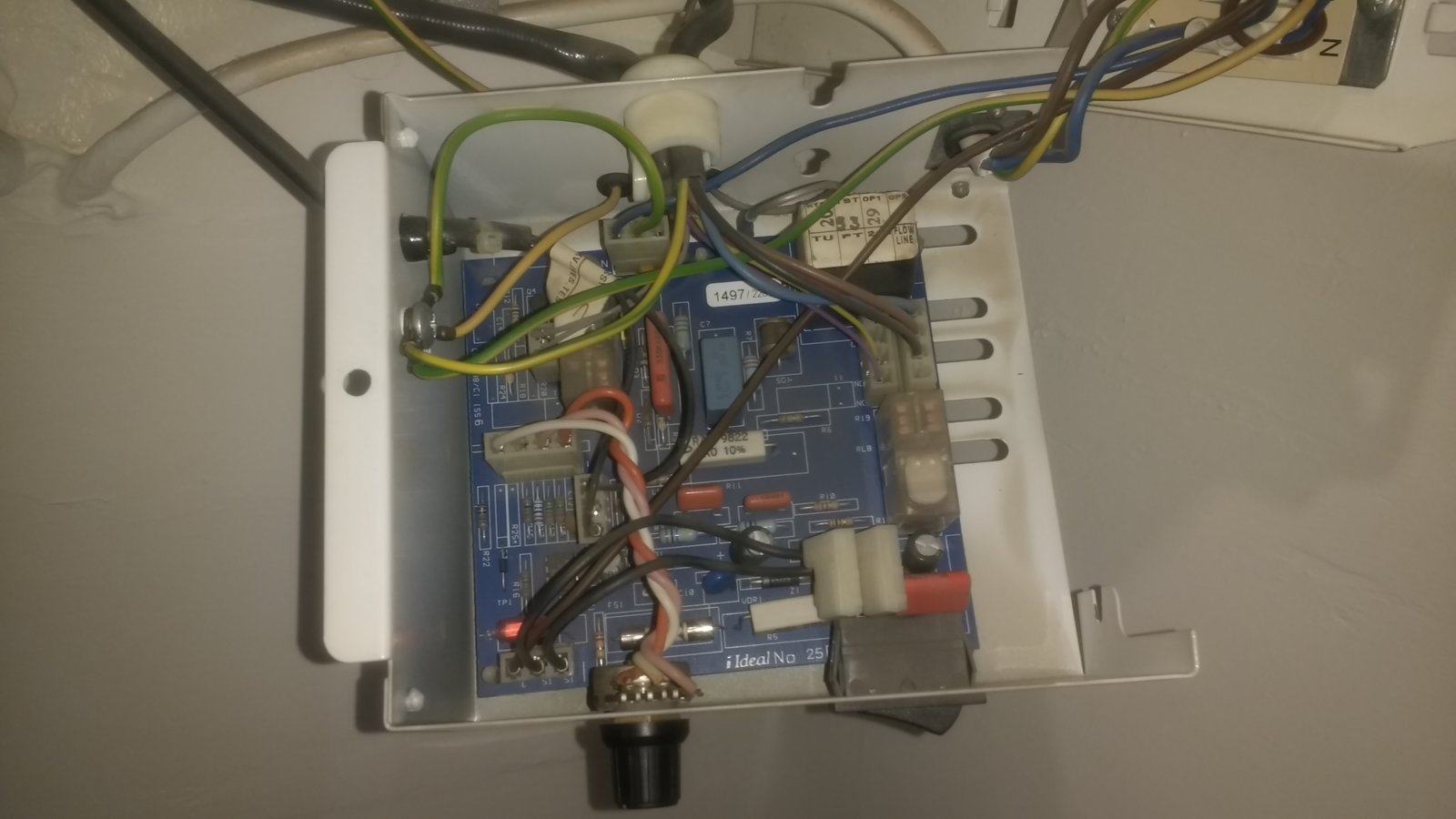

Well the engineer had just been, seems there may be a fault with the PCB.
Something is arcing,.top right corner little round thing partly hidden by the black wire, marked SG1
Any thoughts ?
That's the ignition striker, it should look as though it's arc internally.
Thanks all, it was Mr Daley's colleague who investigated/diagnosed the problem.
Seems it's more difficult to find an engineer who knows what too look for.

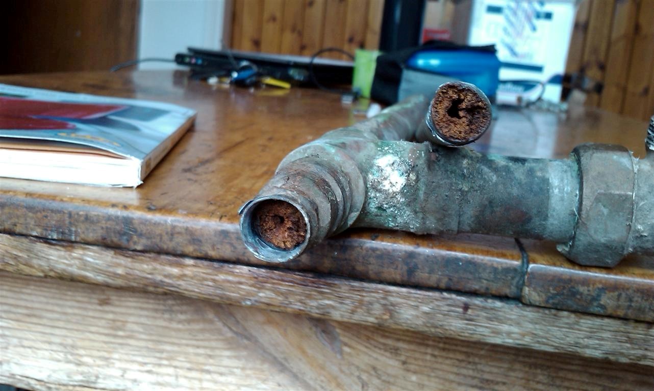

probably blocked cold feed. But might need a powerflush.

Well we may have a little progress, tried a small magnet on the cold feed and there is the slightest hint of a pull :)
So would this need the T junction cutting out and replacing?

Thinking about it when the old Wilo Gold pump failed it looked much like that photo, the width of the pump was reduced to about 5mm.
It took much longer to drain this time, in fact the tall radiator in the kitchen failed to drain fully. There was a lot of gurgling going on!
