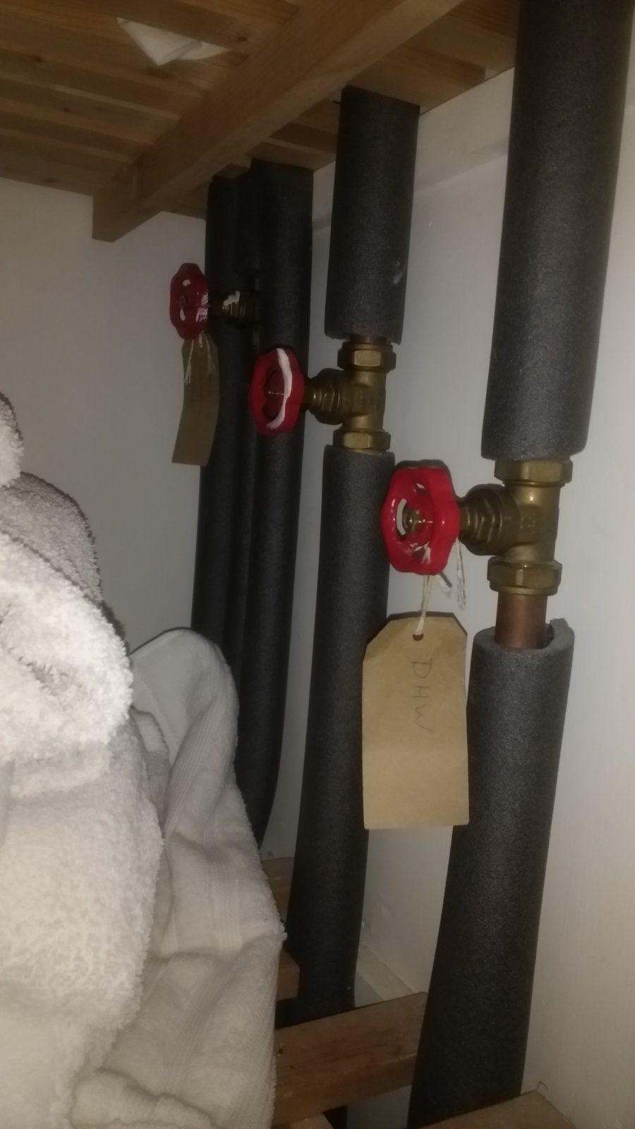

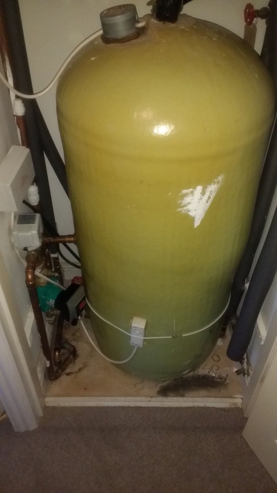

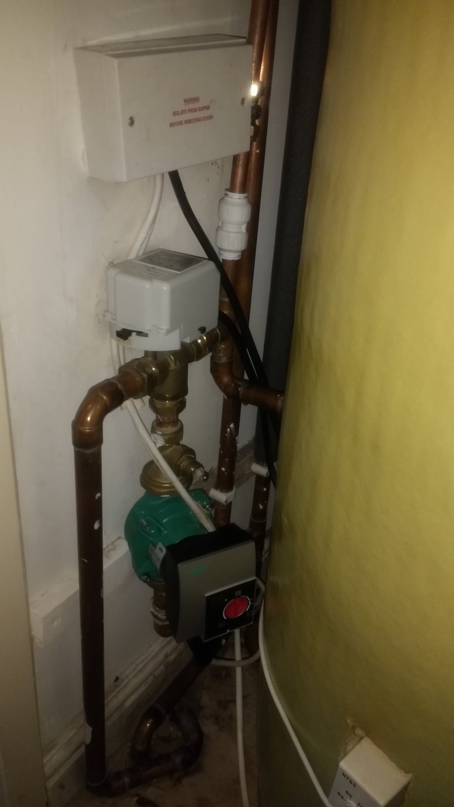

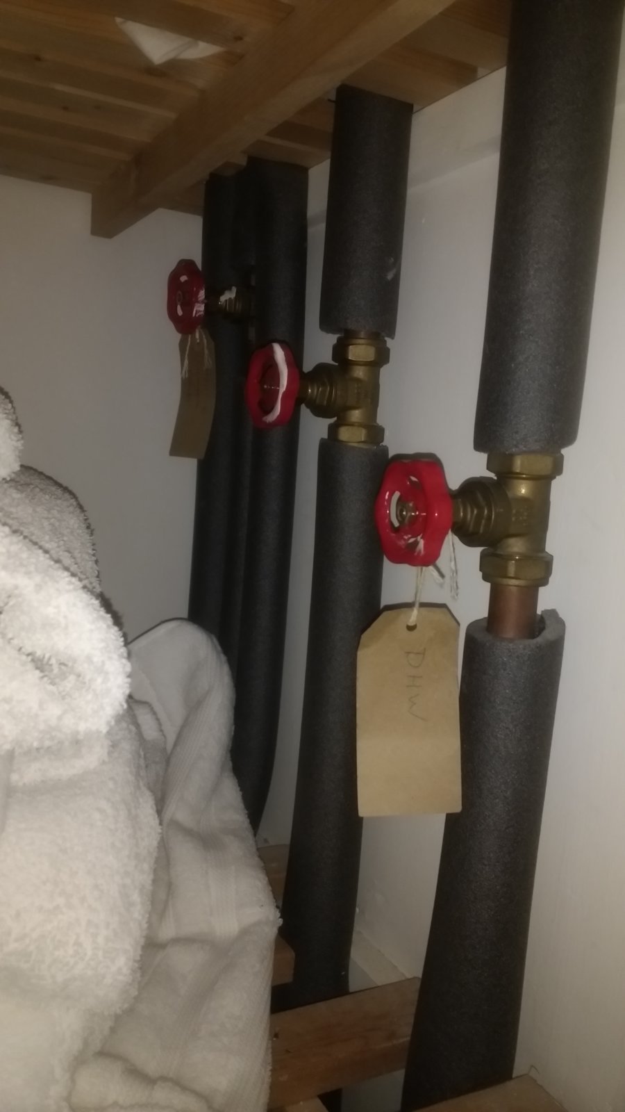

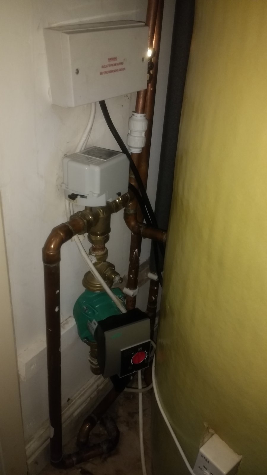

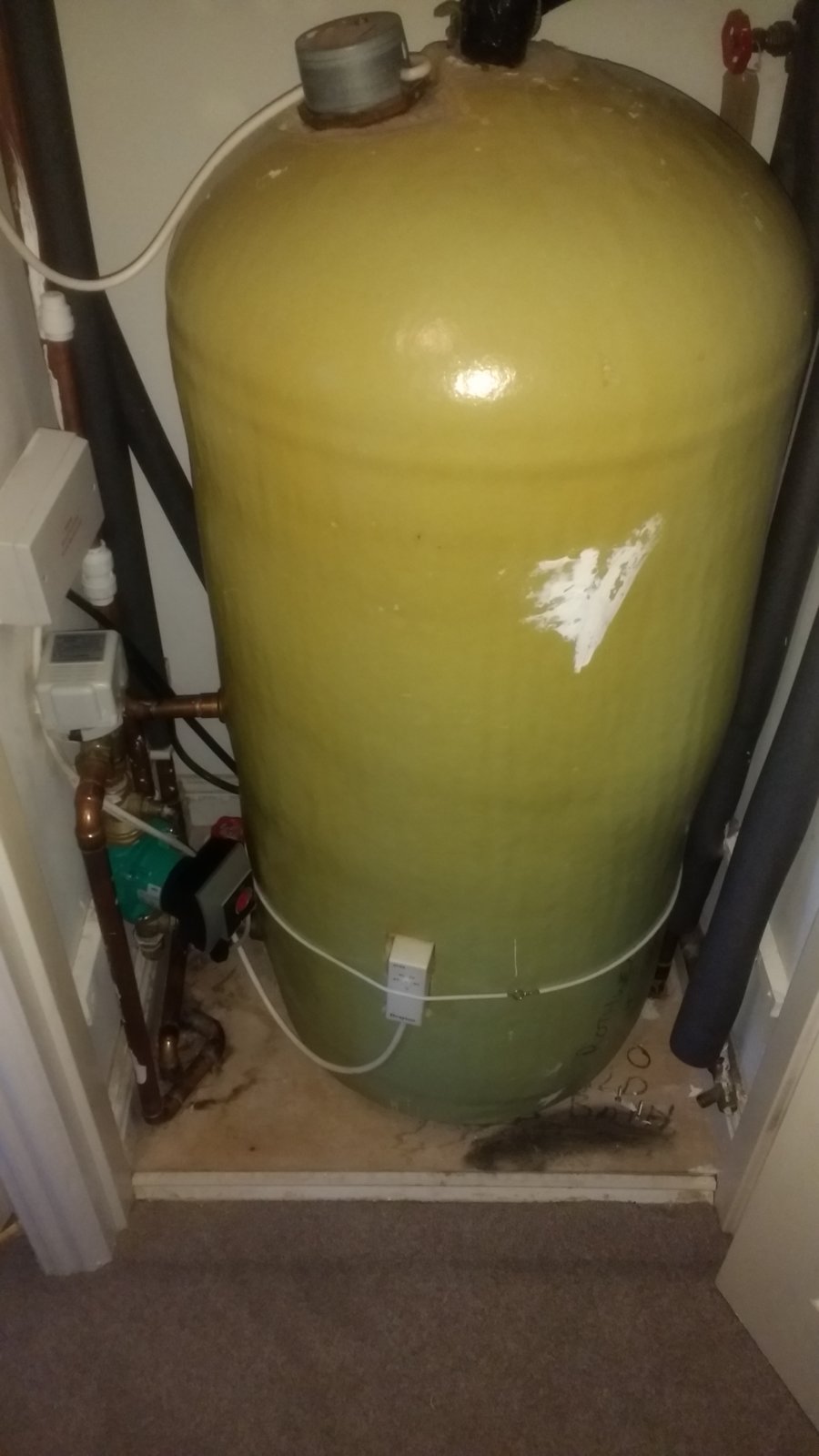

Is your pumpnin the airing cupboard?
Can you post a picture of your airing cupboard.
Crack top pump union and see if water comes out.
Im at work at the moment but will post some pics later.
Yep the pump is in the airing cupboard.

Here's the airing cupboard.
And close up of the pump

Air lock at mid position valve, is that push fit cap on the heating pipework?
