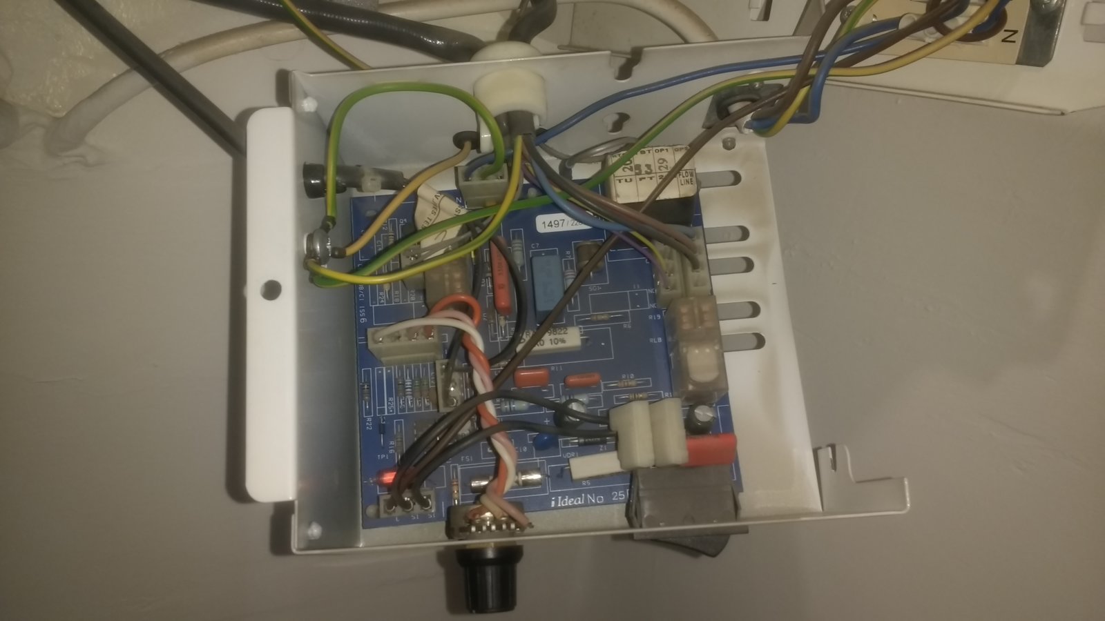

How would I vent the mid point of the is an air lock.
The Wilo pump has an automatic venting routine?
Ok I will try to get a British Gas engineer out tomorrow, the misses wants to scrap it.
Lock 3 port valve in mid position, isolate valve under push fit cap, remove push fit and slowly open isolation valve.
As has been pointed out. We're not there we can't test it but based on the information we have the boiler isn't the fault.

Tried removing the possible air lock, only water came out.
It's pushfit as the original release vale snapped off (2nd engineer).
Thanks all who have contributed, I'm going to admit defeat, see what BG can do.
If nothing then new boiler time :(
Cheers all

Have you checked the pump valves are fully open?.
It is not impossible to have a second failed pump. There could even be some grot blocking the 3 port
