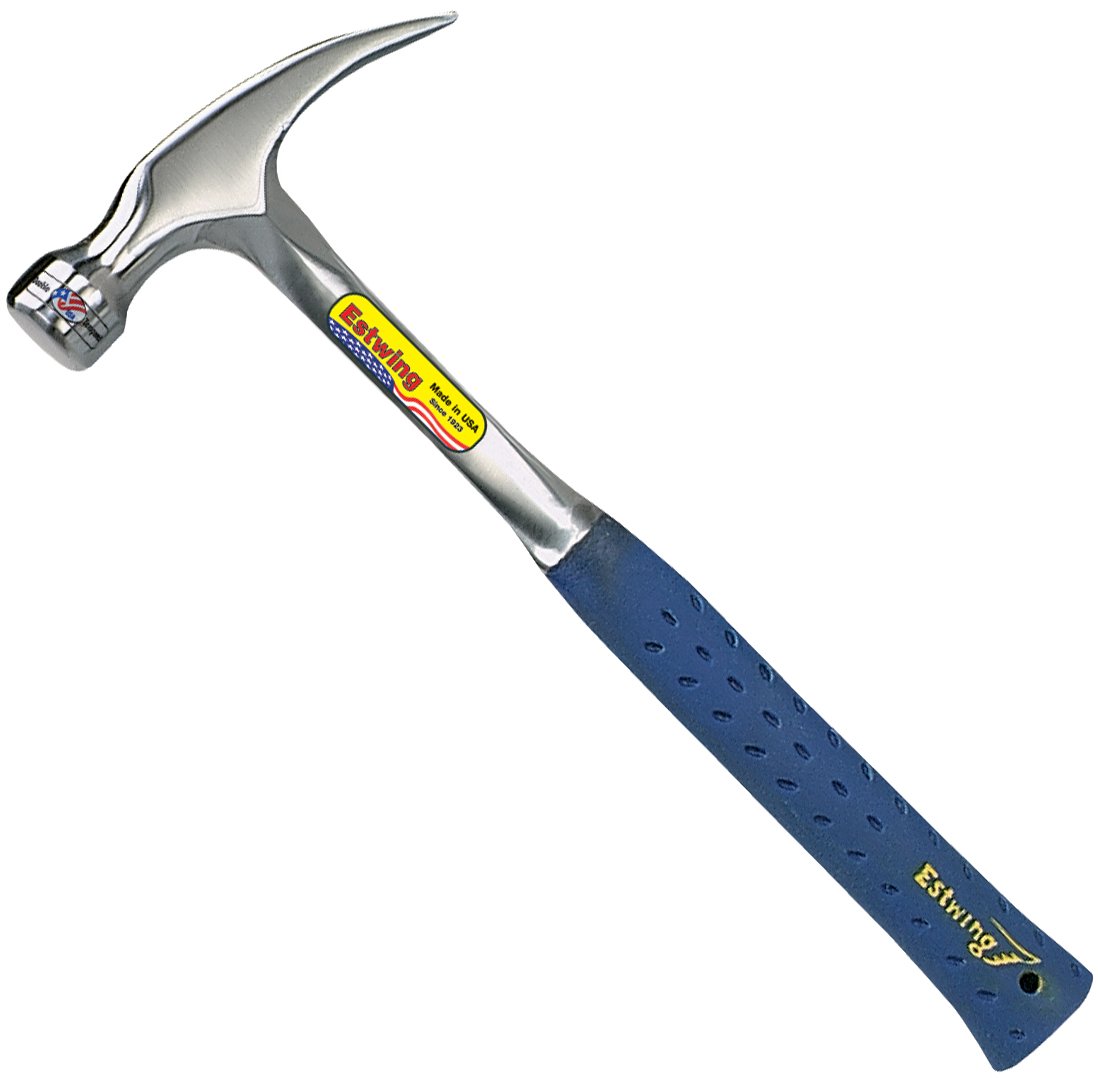

I reckon the GSV was changed, still did not work, so a discreet tap on the pump with one of these got it going: :)
