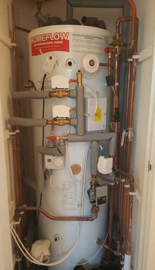

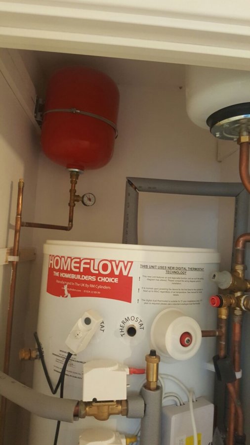

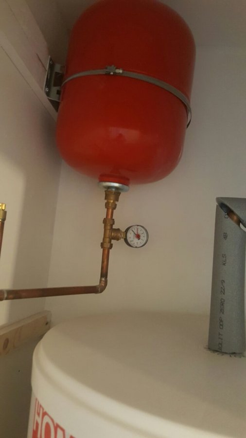

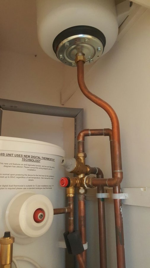

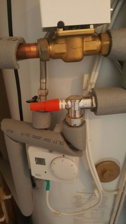

Here are some pictures of the setup.

John. Your photo shows both a pressure gauge under the (Red) expansion vessel. Also, the filling loop is behind the bypass valve below the zone valves at the front of the cylinder.
HTH
Many Thanks PullerGas. So just to confirm, If I drain my radiator system, the pressure gauge below the red vessel will drop. Once I have re-connected the radiator, I re-fill it using the valve I have drawn an arrow on in the attached picture? Is that correct? (and ofcourse not forgetting bleeding the air) I've read mixed opinions as to whether to bleed when system is hot and pressurised or when system is cold? If cold, then I assume I should bleed it straight after filling?

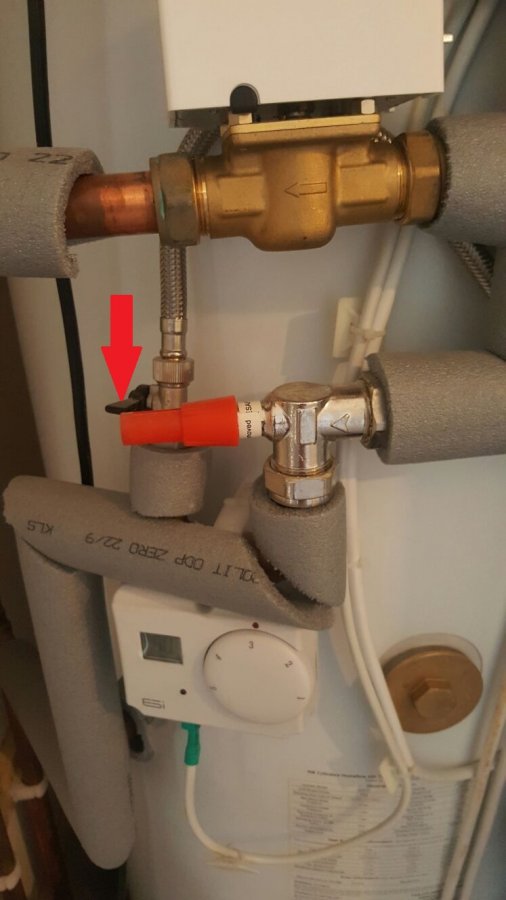

Any comments please? I want to remove the radiator fairly soon and want to be sure that I have understood it correctly. Is it definitely a sealed system and not a open-vented system?
That flexi filling loop has two black isolation style valves (one on each end) that are both on off position. So I assume I need turn these both to on to re-fill the system with water? The filling loop seems to somehow be connected to the white vessel on the top right is that right?
And finally, unlike a combi boiler that has a pressure gauge and one needle which needs to be between two certain points. on this gauge there are 2 needles, a black and a red. the black is not up on anything only the red is up on a value. if i drain the system is it the red needle that will go down? and when refilling do i just refill til red needle is on what it was prior to draining?
Thanks again.
Yup you've got it John. Top up the system when cold, 1-1.5Bar. Sorry John I missed your reply, planning world domination is a bit of a distraction & takes time.
:) Thanks buddy, much appreciated. That means the system is a sealed system and not a open-vented system right?
The flexi filling loop has two black isolation style valves (one on each end) that are both on off positions at the moment. So I assume I need turn both of them to on position to re-fill the system? The flexi filling loop seems to somehow be connected to the white vessel on the top right is that right?
Again you've got it right John. The filling loop is connected to the mains cold water, as is the white potable water expansion vessel........(y)
PS. Yes it's a sealed system.

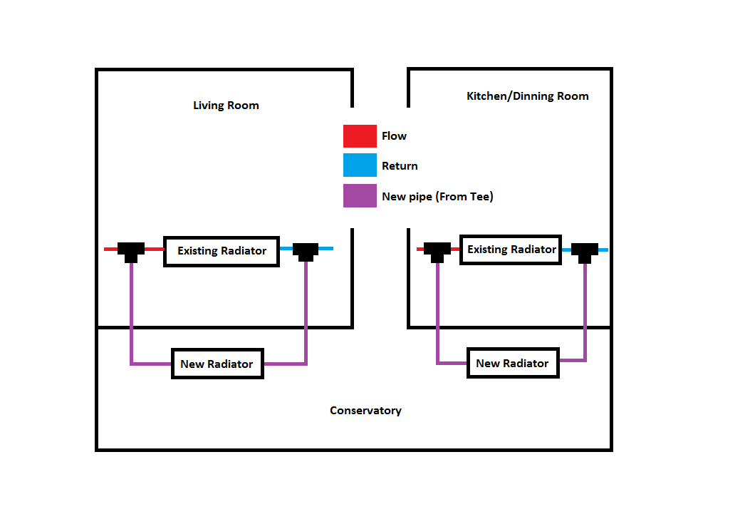

Many thanks buddy. One last question. I am thinking to add 2 new radiators to the system. Each one to feed of an existing one. So in the living room I have a existing radiator from which I want to add another one and in the dinning room I have one that I want to also run an extra one from. Do I just Tee from the flow and return pipe from each radiator? I have drawn and attached a quick diagram I drew to explain.
Your design will work, but is dependent on size of pipe you are teeing into, the size and length of new pipe run and the size of the new rads. More importantly, it contravenes building regs to do what you propose.
