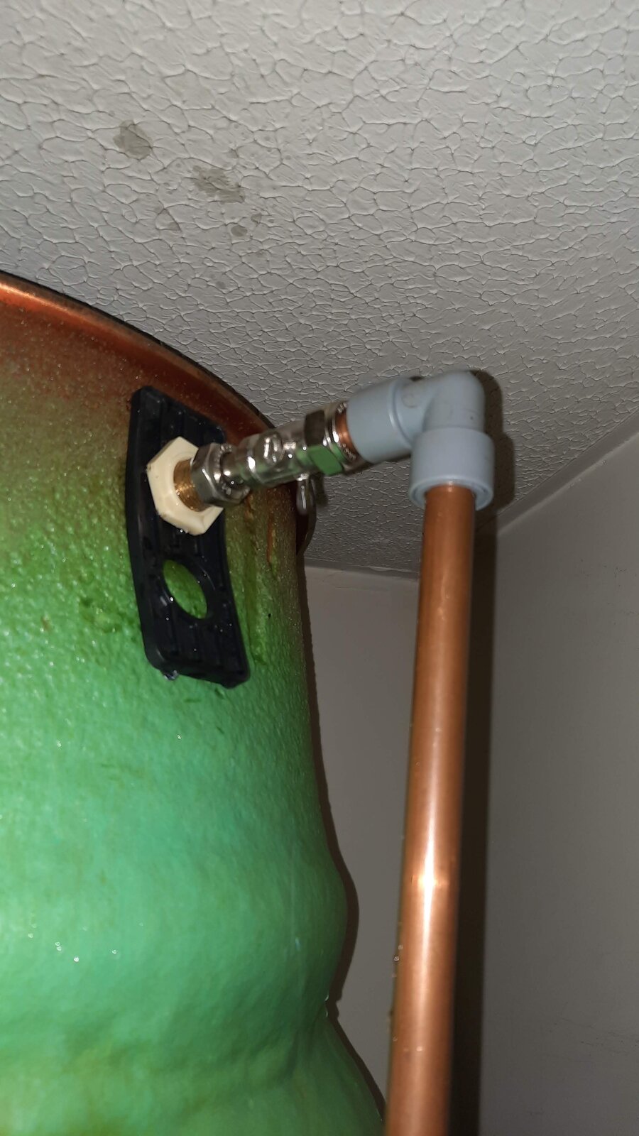

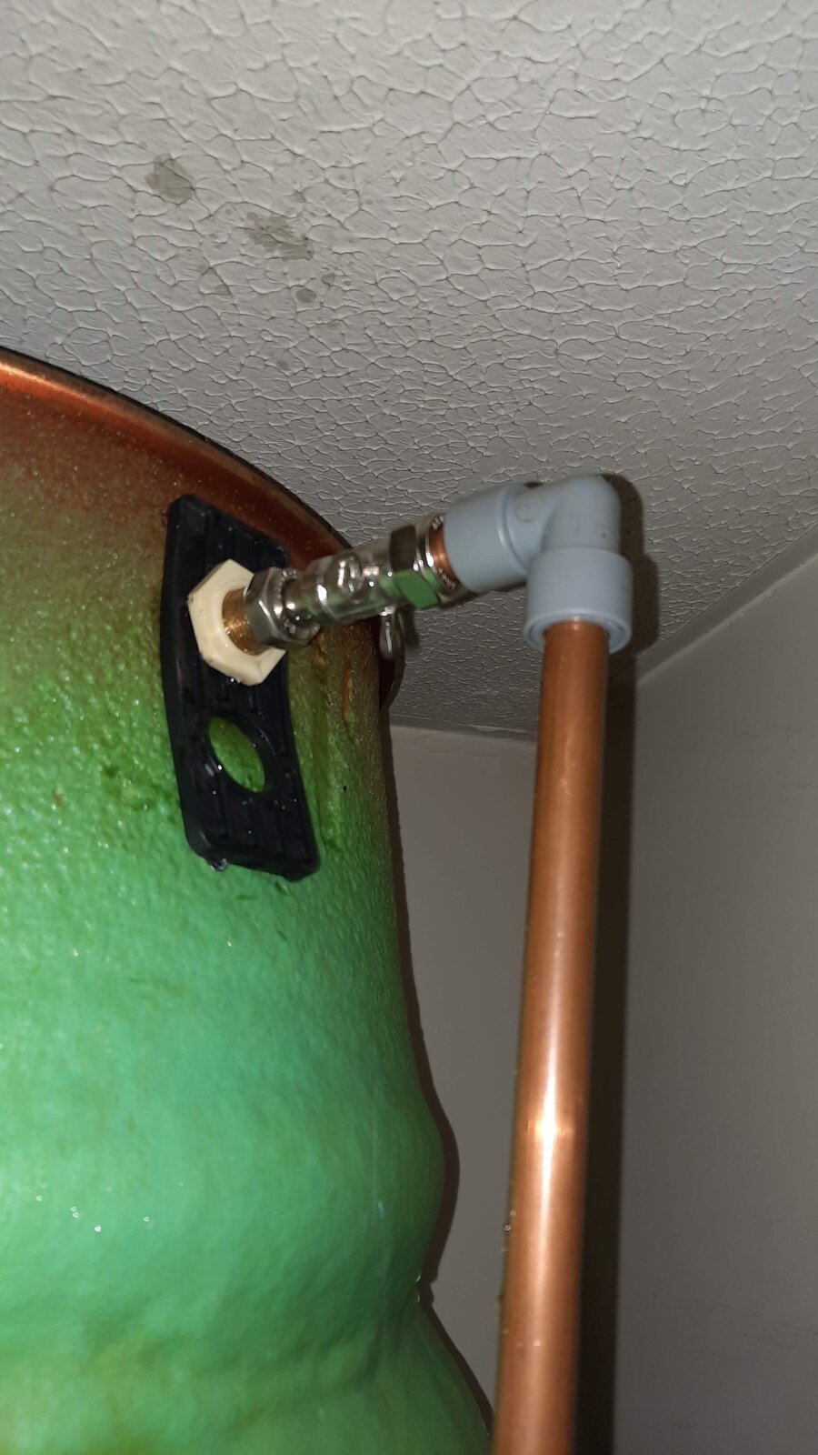

This is it.
Thanks so far for the advice guys.
Thanks.

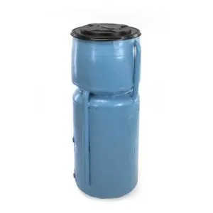

From a distance, does it look anything like this?
