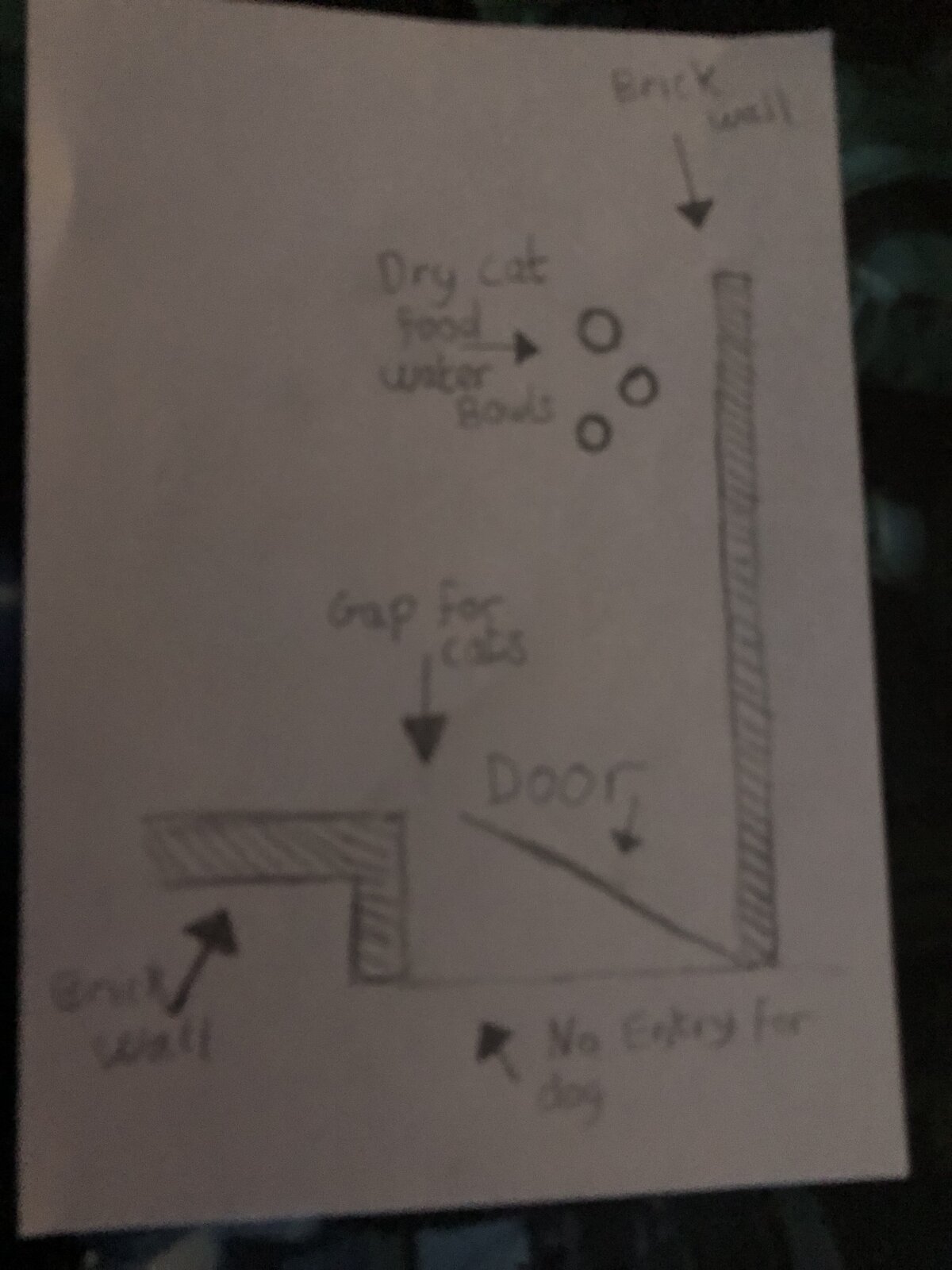

My cats have their dry food on the floor in my bedroom, as I keep my door open enough for the cats to come and go, but should give me as much privacy as possible. This is where my sisters dog comes in, she can obviously smell the cat food, and she will come in my room, nothing stopping her and eats everything she can. I have made a door stop wedge that I have to put on the inside to stop the dog from entering, problem is it stops me from getting into my room when pain is bad, and needing to rest. I have to sit on the floor to set up the door wedge and dismantle it.
I have made a quick sketch so you can hopefully see how my room is setup, and if you can help me stop the dog from eating my cats food.

You could perhaps fasten a cabin hook to the doorframe, and a screw eye to the door, to hold it, say, three inches open. It would only take you a moment to lift the hook to go through. The hook goes on the frame so it does not rattle.
I'm also thinking you could have a pet-gate faced with coarse carpet, which a cat can easily climb over to get in and out, or jump if young and agile..

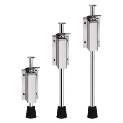

There is also a kind of bolt you can use to hold a door partly open, you fix and release it by pressing the top with your foot. It does not bolt into a hole, it has a rubber foot that presses on the floor. I don't know its proper name.
