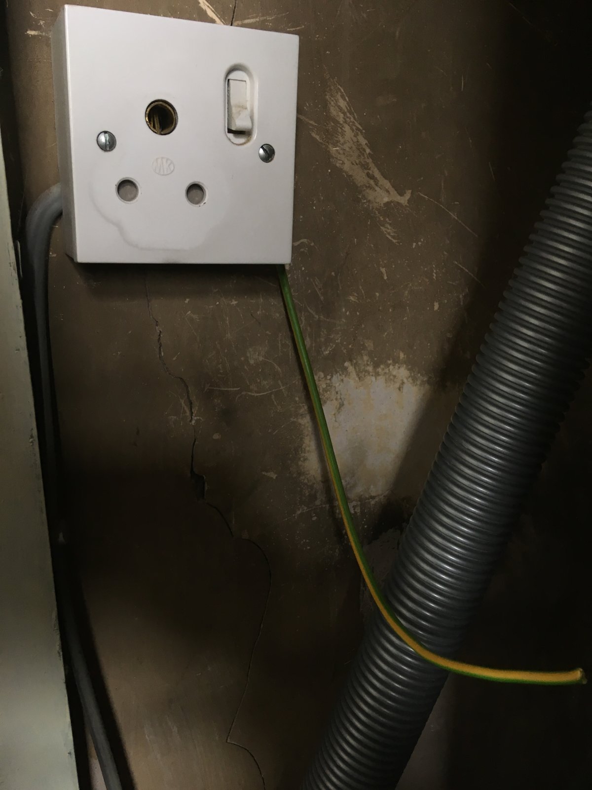

Identify this socket?
2 Mar 2019
13
Slowly figuring out what's what in a new house. This is in a bathroom cupboard, I assume for a water heater or similar, any ideas if I'm right. Would like to get power into the cupboard (regs allowing), not sure yet if there's power to this though.

It said it was uploaded! Hang on. I knew that was too fast for a useful answer :D
You are right. It should be just a 15A circuit. Do you still have fuses in a fuse board?
You can swap for normal socket(s) but will be limited to 15A.
All circuit breakers - two boxes, one of which is labelled with stuff like 'storage heaters'. There aren't any in the house. There's one labelled 'downflow' which I've figured out powers the boiler. I'll wager this is wired up to one of those, if it's wired to anything, but there's nothing to indicate which one.

Sockets are not permitted in bathrooms unless they are more than 3metres from a shower or bath.
So forget having a double 13A one there to plug in the hair dryer!

My understanding is that as it's a cupboard, with door, it'd be permitted under regs, but that sparkies may well not be willing. For reference
https://electrical.theiet.org/media/1450/section-701.pdf
doors, floors and fixed partitions may be taken into account where these effectively limit the extent of locations containing a bath or shower as well as their zones.
If I can't find a willing sparky, I'll drop the idea. But it's two adults, no kids, no chance of that changing or the house selling in the near future, so I'd hope to get it done.
Yes, I think that's all true.
I would personally say that a lot depends upon the intended usage. For the toothbrush charging and vacuum cleaners you've mentioned, it would be fine, but if one were thinking of hair dryers, fan heaters etc. with long leads, it would rather defeat the point of the regulations!
Some electricians might be hesitant because, regardless of what you might say about your intended usage, no-one can know what a future occupant might plug in. However, I wouldn't think it would be difficult to find an electrician who was willing/happy to do it (it's not uncommon).
