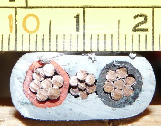

Identifying 10mm\16mm T &E
Unfortunately I don't have any calipers, but each strand is definately well over the 1.5mm.
Even 7 strands at 1.5mm diameter works out to 12.4mm so working on your 'at least' comment then I would assume it's not 10mm.
As Lectrician pointed out, it could well be an imperial cable:
7/.064 would work out to around 14.5mm
[code:1]Imperial Actual Nearest metric
size mm² equivalent
1/0.044 0.98 1
3/0.029 1.28 1.5
3/0.036 1.97 1.5 or 2.5
7/0.029 2.98 2.5
7/0.036 4.60 4 or 6
7/0.044 6.87 6 or 10
7/0.052 9.59 10
7/0.064 14.53 16[/code:1]
0.064" = 1.63mm.
1 of 7 strands making 16mm² would be 1.71mm.
If it's only being measured with a ruler and all we know is it's more than 1.5mm dia, it could be either cable...
That's my thinking (above) - I ruled out it being 10mm² with it more likely to be 7/.064 or 16mm²

That's exactly the sort of thing I am worried about - 1) thicker sheathing & 2) differences in the imperial sizes (which it is undoubtedly). Judging form other posters it could well be the 7/0.064 -= that strands do seem to be 1/16" which is near as dammit.
Here's a photo.
Once thing though that I forgot to mention is that this may have not been the original cooker cable, but rather the supply to a secondary consumer unit that the cooker was fed off. Now that unit was removed 10 years ago , but I suspect the cable for it was just then used for the cooker.
My real question is, assuming it will fit the new cooker switch, is there any problem just reusing it for the new cooker in the new kitchen ? I'm not needing to replace the entire cable run. Am I just as well replacing it anyway ? It is an Electric range I am installing at it specifies 10mm: I also have a 12m distance to cover. I guess 10mm would be slightly easier to work with - at at least fit all the standard cooker switches and connection boxes.....
absolutely not problem whatsoever.
if it's 10mm then it's fine, so if it's 16 it's even more fine...

7/0.052" utilises 7/0.044" cpc ~ 3 x 0.044" = 0.132" approx' 3.35 mm
7/064" utilises 7/0.052" cpc ~ 3 x 0.052" = 0.156" approx' 3.96mm
Allowing for burred edges in the pix, looks like the larger cable.
Rated at 61 amp when clipped direct. with coarse excess current protection.
With close current protection the rating may be multiplied by 1.33
All that from the wiki - apart from the cpc dimensions.
IEE Wiring Regs. 14th Edition, 1966 - Apparently.
