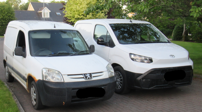

So have you got rid of your polluting 350 year old van then
