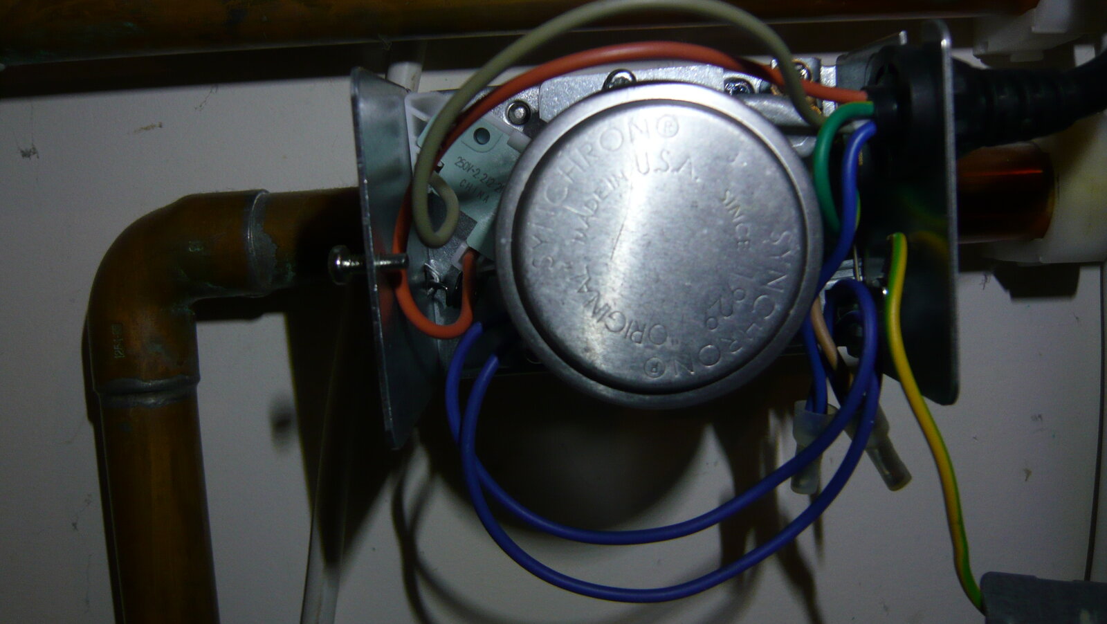

I'm guessing this valve need's to be replaced .
Can just the electrical part be changed or will it need to be the whole thing ?

I got the cover off and thought i had found the problem , only 1 screw holding the motor on , on spending half an hour or so finding a suitable one , I discovered it only has 1 holding it in, the other side of the motor locates in a slot , it seems to be a rack and pinion type of arrangement , i have operated it several times now and can't seem to get it to make that noise again .
The speed the motor turns i don't think the noise would be the cog slipping , so a bit puzzled really , this valve is no more than 5 years old .

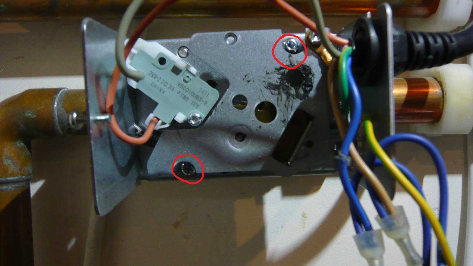

Ahh, you've separated the motor from the carrier. To check the valve you need to separate the carrier from the valve. Looking from above the motor you'll see 2 brass slotted nuts at diagonal corners- if you can't see them then take a pic from above & someone will put some highlights on.
Was the actuator loose on the valve body? If you remove the actuator from the valve, then it will make just this noise. The actuator needs to be on the valve to make the drive dog locate with the motor spigot. If it still makes that noise, then just replace the actuator as long as the shaft is free.
Edit to add. Do you know the history of this valve? Has it been repaired before with a new synchron motor? If so, then it may be a cheap chinese lookalike motor with nylon gearing that has stripped. What name is on the top of the synchron motor?
I loosened the 2 screws (see photo) on the carrier but couldn't seem to get the carrier off , it was loose but wouldn't pull out ,its all original as far as i know and the motor cog is brass , i can move the lever with the pinion easily by hand .

Yeah you usually have to wiggle the mounting a bit to get the mech off, don't start levering or hammering though.
Sorry , i did look at uploading photos directly yesterday but could only see a link option a link option ,, ok finally got it off and valve turns very easily with fingertips ,
