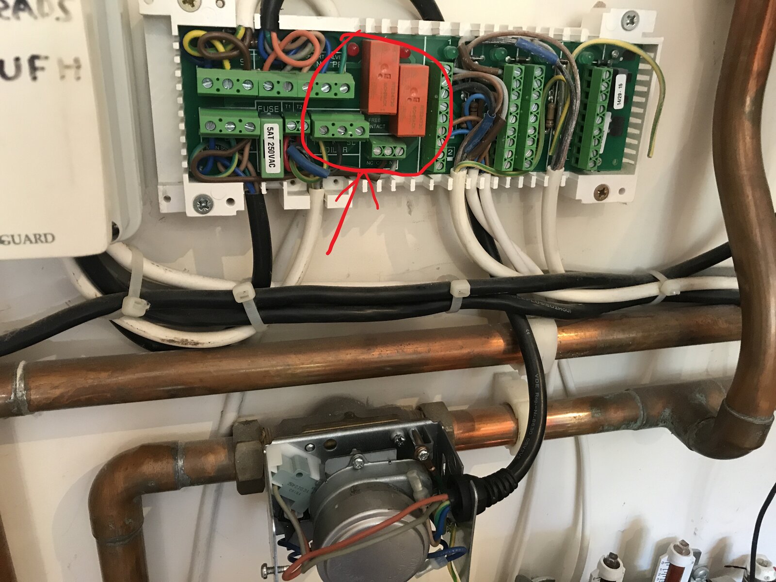

Sorry guys but I've been a bit dim , the noise in my original video is from the relays in the wiring centre which is just above the valve ,
I also seem to still have an issue with the room stat that I thought I had solved at the beginning of the year (with this forums help) , The stat is cutting in and out too often sometimes up to 2 times a minute .
I am trying to catch it when the relay is in the clicking state to check the voltage on the switch wire from that stat , would you agree its looking like that room stat is faulty. ?

A standard room thermostat shouldn't be switching that rapidly.
Possibilities are;
A poor connection at the thermostat (which is arcing or otherwise generating heat & causing detected temperature to go up and down very quickly).
A poor connection somewhere else causing too much volt drop at the relay when the coil is energised (so it cycles as described)
A broken thermostat (internal switch fail)
Standard stat is easy to verify- isolate power, remove stat, replace with a standard 2 way light switch (common to common, call for heat to L1, satisfied to L2, neutral if there made safe in terminal block.
I have swapped the room stats over and checked all wire screws are tight , still same issue ..
I sent the video to continental ufh and they said i need a new wiring centre , blaming a power cut , not too sure how the faulty wiring centre would cause the room stats to cut in and out too quickly though.
I will change it ..
Last update on this for anyone who may arrive at this thread in the future , i fitted the 2 new room stats (see above post) and no more relay clicking and heating is cutting in and out as expected.
Thanks all who posted for the advice and help ..
