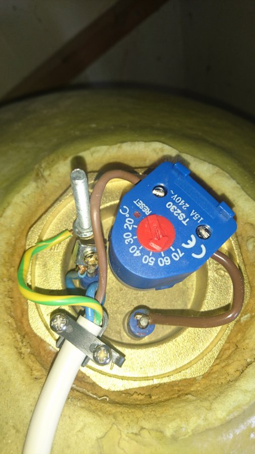

I've bought a house and been here a year now but the immersion heater is not working now. It randomly stopped one day so I bought a new element/stat and swapped them over. It's a basic cylinder with a single element entry at the top. I've replaced it of a similar element of the same size (27") and still no joy. I took it back and swapped it out under warranty and again still no joy.
I wired it up the same as the old one, and the new one came with a diagram which confirms it is correct.
I can replace things around the house I've replaced all plug fronts and light switches as well as adding some new lights throughout the house but my electrics especially terminology is basic.
I grabbed a multimeter and thought I'd give it a go myself as I've had not one but two plumbers round and both say 'it should be working but I don't know why' and pretty much ran out the door, I'm assuming fault finding isn't worth their time and came just to do an easy swap.
Live to earth is 240v
Neutral to earth is 240v
Live to neutral is 0
Resistance is 20 ohms.
there is power both sides of the Thermostat (in and out) and when turning it down to 0 it shuts power off to one side (cable running to element). The overheat reset is pushed in.
I'm stuck with this and I can't get a sparky round to look at it until next week, it's been 10 days without hot water and it's not good!
Any help would be much appreciated and remember to dumb it down for me :)

They are right! it should be working, and I think you have come to that conclusion yourself, hence your post here.
Whilst the voltage is present, is there something restricting the current flowing? A 3kW immersion will require about 13A. So, for example, there may be a poor connection at the consumer unit or switch. Or, the switch contacts maybe pitted or burned, which would allow you to see a voltage, but not let sufficient current flow.
If you could by-pass the wiring at the switch, (or timer) purely as a test, and see if it works then, that would allow them to be eliminated from your enquiries.
You could always wire a fly lead to the immersion and plug it in just as a test, that would confirm that the element and overheat trip are OK or not. If it does work, don't be tempted to leave it like that though.
looks like a high resistance fault in the supply. Perhaps the wall switch is burned out or someone put a nail through the cable.
It could also be a wiring error, but you say it used to work.

If you have Neutral (N) to Earth (E) at 240v and 0V from Live (L) to Neutral then you have a fault. I'd be back looking at a possible issue with the wiring, specifically the Neutral if it's showing 240v to/from Earth. Check your supply voltage to the fused spur and check you have -
L > N = 240v
L > E = 240v
N > E= 0v
If you do then check the wiring to the element for continuity. If you have the same results as you found, 240v from N > E then I'd be checking for continuity back to the consumer unit.

Methinks Dane2594 has inadvertently transposed his results.
Hopefully he will be along soon to clarify.
Yes sorry I have conflicted what was said.
The values are at the element/stat -
L-E 240
N-E 240
L-N 0.

The wall switch output (to the heater element)
L-N 0
N-E 240
L-E 240
Going by this the wall switch needs replacing as the input/outputs are different. This has not been touched at all until today and it used to work up until the hot water stopped so the wires haven't been touched in there just to clarify in case someone thinks it's been wired wrong.
Again thanks for the many replies and help offered.
Seems the neutral pole in the switch is not making contact.
A bodge repair would be to link the N in to the N out to test!
But that should not be done as a permanent repair as the element should be powered from a two pole switch!
