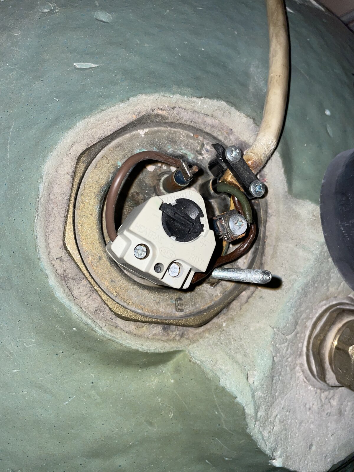

We have an immersion heater that’s stopped working. I’ve reset the connections and element with a multi-meter and they all seem good. What else could it be? Is it possible it’s the switch? I assume if it were I wouldn’t get a volt reading (with a voltage pen) at the thermostat?

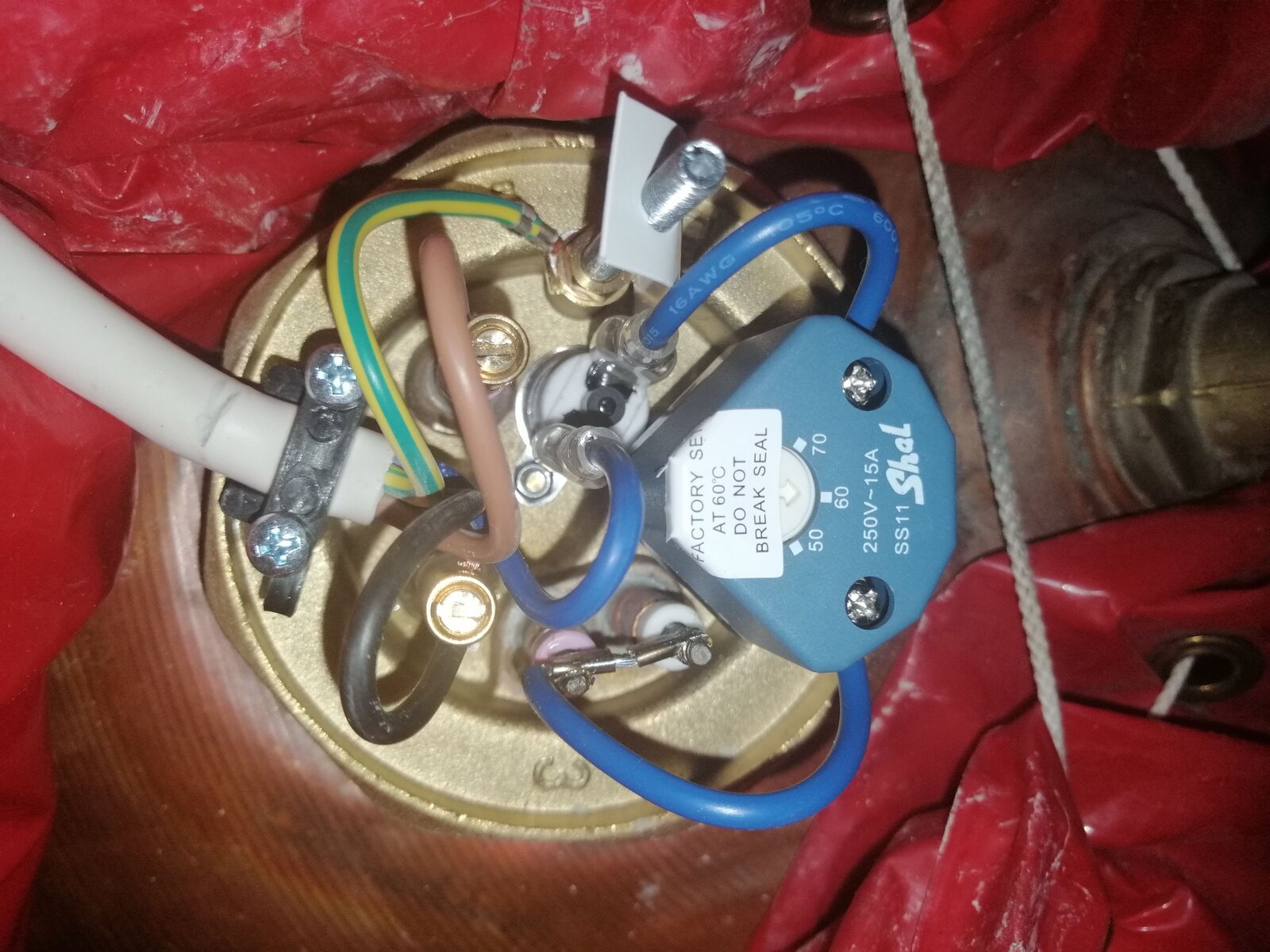

It would help immensly if we had a photo, it could be a side mounted immersion or a top mounted single element immersion or a top mounted dual element immersion with a short and long element, (unlikely since only one element resistance provided). Below is a top mounted dual element immersion where one thermostat switches the common neutral and has a separate over temp thermostat marked 6.

Yes, 18 Ohms. Tried volt stick at neutral and got an indication. Included a picture as well.
