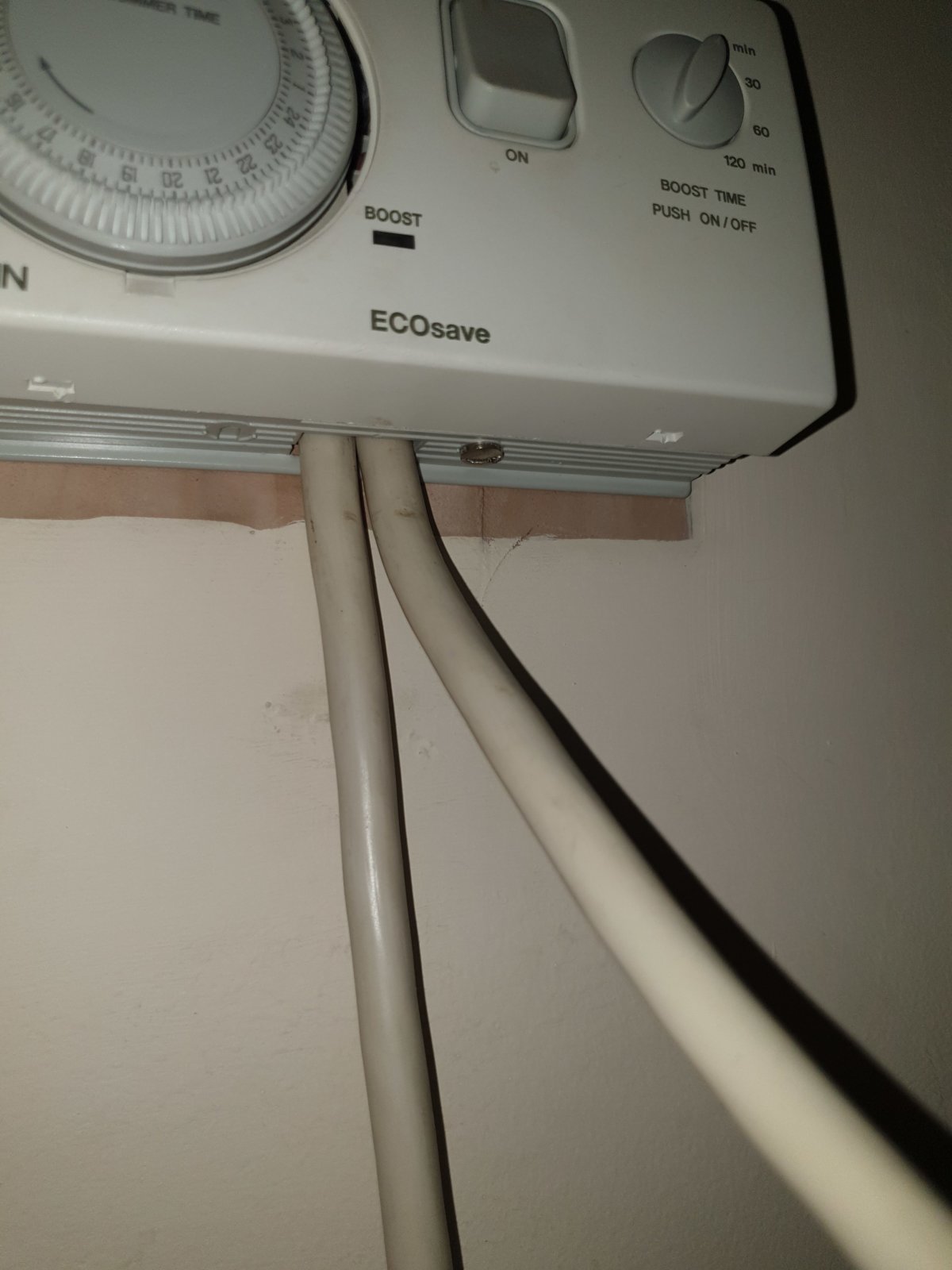

Also have followed cables they go into timer but I'm not sure how I know I'd they are ok here is pic

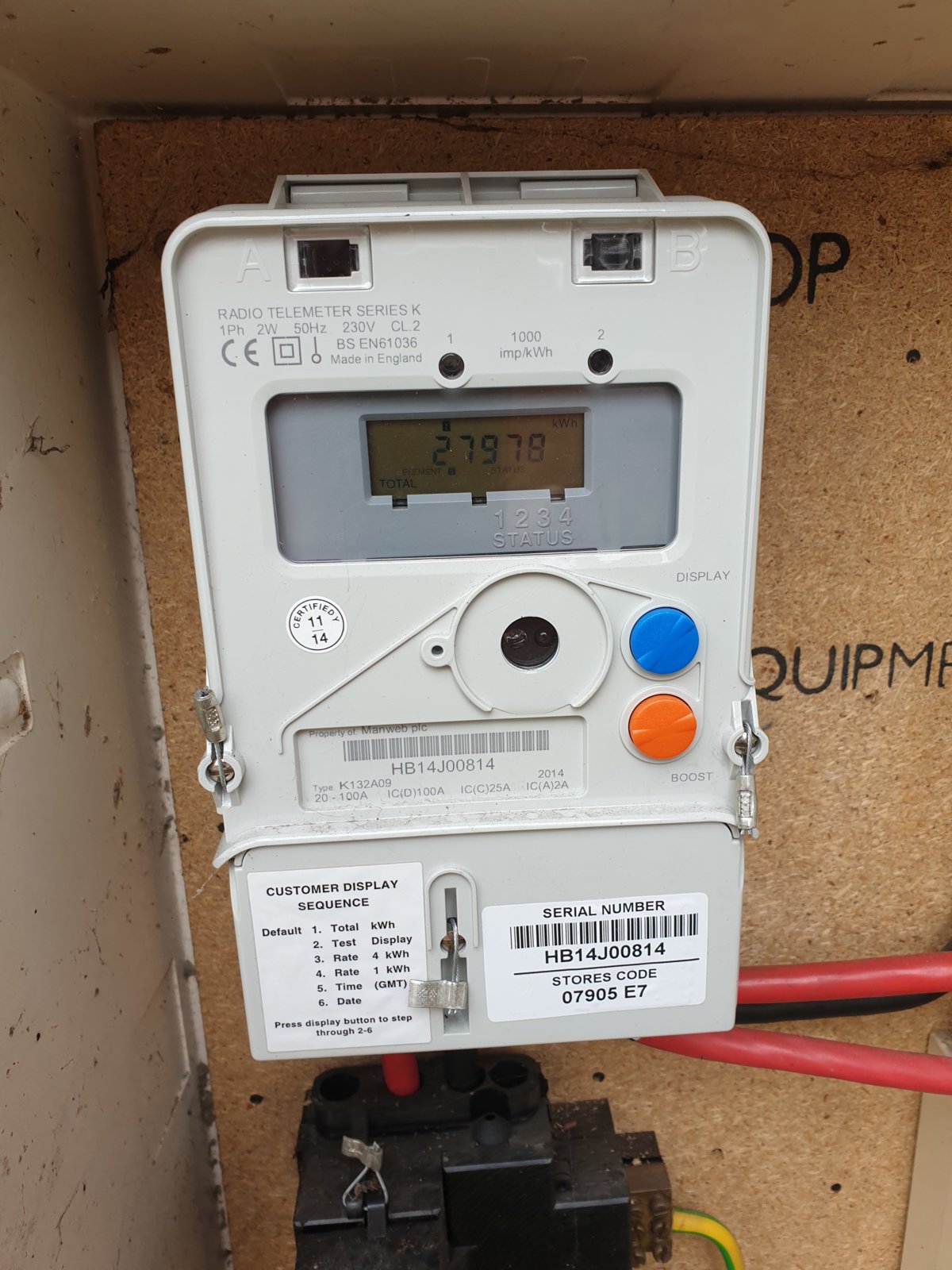

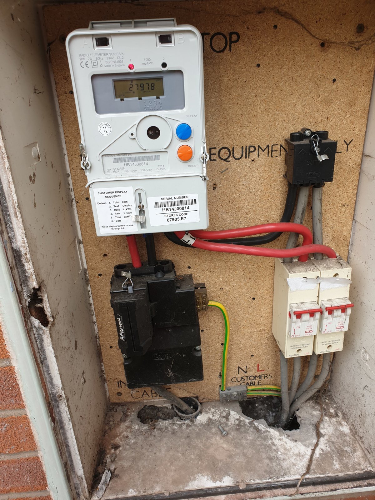

show us some photos of your meter. There may be a timer in it or beside it.
Your electricity bill will also give an indication. Your storage heaters should be turned off for the summer, so the cylnder should be costing you around 5 kWh per night on the off-peak column, depending how big it is.
please take pics showing the cable from the bottom element all the way up to its switch or timer, and the same for the top element.
They might possibly both go into the timer, in which case we can't tell just by looking.
Thanks John will get photos. I only moved in on 10rh June so no bill yet. I'm with Scottish power and did switch into my name but they couldn't confirm for definite what hours odd peak was which I thought was odd anyway I left immersion timer as it was, set for one hour on between two and three in morning and always has hot water. You are right storage heaters are odd for now.
So I've just switched the immersion timer back on and press the boost switch and it's not tripped and it's definitely heating up the water I can hear it does this mean anything help thank you
the "boost" switch is normally wired to turn on the top element, whereas the "timed" supply usually goes to the bottom. Yours might be the other way round, but it is probably not the same element that caused the night-time trip.
Feel the plastic cap of the elements to see which is getting warm.
The top one labelled off peak is warm
Pictures of meter
