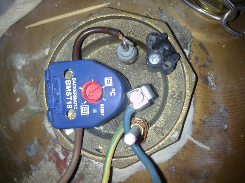

The whole heater was changed 2 months ago as the old one had been in since the year dot and had simply given up.
A plumber went round and changed it (new element and stat) in since tripped the MCB. This is where i went round to have a look. Found it was on a 32amp Ring main so put in a 16amp MCB new 20amp double pole switch. Only have a multimeter but done continuity and resistance tests on the wiring and that was sound. Switched it on around 12pm, 30mins later warm water, 2 hours later it tripped the MCB. So new stat, still trips after a hour or so!
Was just going to bypass the stat to see if the MCB trips straight away, not as a long term thing.
The Backer stat that i put in will only switch off if i physically push the adjuster down i can not hear any click when adjusting from min to max is that right?

(Ideally this should be done at 500v with an insulation resistance tester, and readings of 10s of megohms at least would be expected).
This HAS to be done with a insulation resistance tester. Your multimeter won't tell you that the element is breaking down.
Have you disconnected the element and tested the resistance between the element terminals and the earth body of the element.

This HAS to be done with an insulation resistance tester as your multimeter won't tell you that the element is breaking down, unless it is already a short to earth.
Just thinking about somethign else, is it definitely an MCB you've put it on and not an RCD?

Your problem just doesn't seem to add up. If it can heat for two hours and then trip I wouldn't think there is any break down in insulation . By the sounds of it, the thermostat switching off the immersion is causing the trip, but this is just a switch which opens. Unless it is internally faulty and the action of the contacts opening causes it to earth to the tank it shouldn't make it trip.
The thermostats are available separately from places like the depot and only cost £10. Would be easy to eliminate.
Here's a pic of the new stat. Think wiring is ok.

Tried the test flameport suggested, stat set to min, switched it on, it tripped the mcb, turned up the stat powered it back up switched it on, fine! Left it 30mins, switched off turned stat to min switched it back on, fine!?! One hour later it trips!!!!!!
Must be the element?
As unlikely as it seems, it appears to be the thermostat causing an intermittent short to earth somehow.
With the stat at minimum, it would be open, and therefore the element would not be connected.
With the multimeter you have, the only way to check this will be to remove the thermostat and check for continuity between the terminals and the metal stem while rotating the temperature adjustment. Any continuity reading indicates the thermostat is faulty.
Other things from the picture:
The flex is supposed to be secured in the grip at the top right, the bar and screws are missing.
That thermostat has a very large top, almost too big to fit in there.
The cylinder looks to be as old as the hills.
have you got a clamp meter to check the actual current drain? just wondering if it might be a non-standard element
it's odd that the cable doesn't look like it would fit easily. have you got the plastic cap, and does it show the make and rating of the element?
The element is rated at 3kw from the metal cap, not sure of make, there's a wickes box with the old element in so if that's any help?
The new stat is a bit tight to get pass to neutral terminal but does still slot in, i removed the flex clamp to show the connections, the wires are not on best route but none are touching when clamped.
Will check the continuity on the stat but don't have a clamp meter.
It is as old as that's why i don't want to take the new element out again!!!
I'm with Flameport here, it sounds like your Thermostat is internally faulty.
When it switches the supply off it shorts to earth (tank) somehow.
Get a new one and replace just that bit, not the coil, I don't know if you've removed it before but its just dropped inside a tube. You don't have to get the whole element out to change it.
