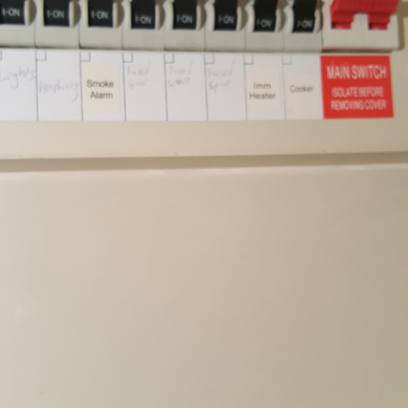

please photograph the thing that is tripping.
if that's not possible, please tell us the words, letters and numbers printed on it. All of them.
Its the one that says "immersion heater"
you have cunningly provided a photo that makes it impossible to see the words, letters and numbers printed on the breaker.
Let's try one as a starter.
Does it say "B16?"
I have cunningly supplied a photo thats makes it impossible to see the words.
Clearly states "IMM HEATER"
There is no numbers just states "IMM HEATER" exactly like ive taken a photo of.
OK.
that's a label stuck on the casing.

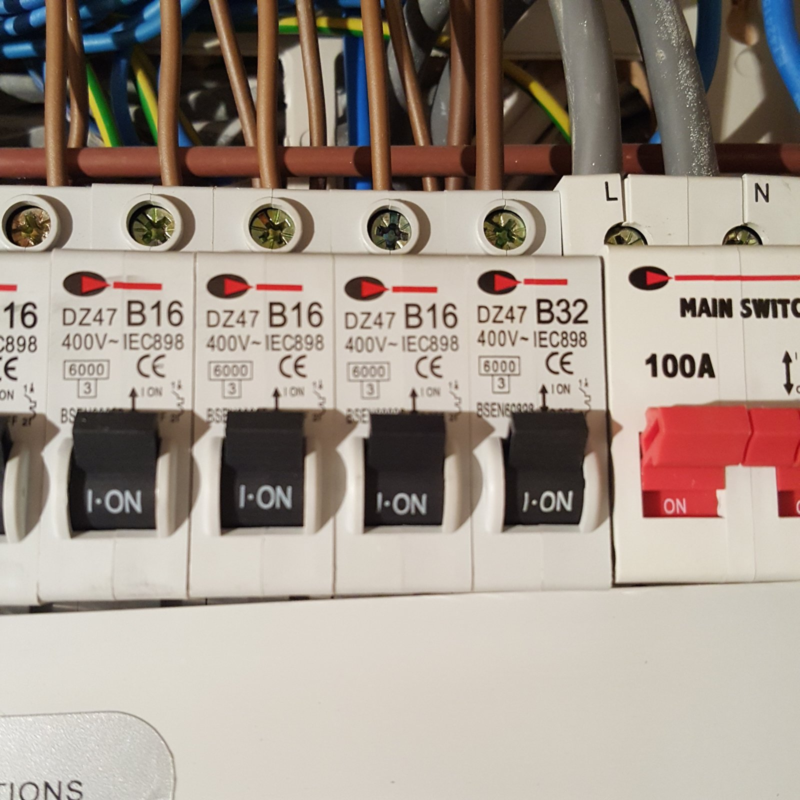

The actual thing that trips is a breaker. It will look something like this. The front part projects through the front of the enclosure so you can read the printed identifying marks.
See what I mean?
Took the cover off, second one in from the right.
B16 like you said
