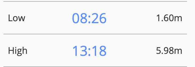

Yes the ebb tide will be generally southerly, but it was a flood tide. (LW + 1-2)

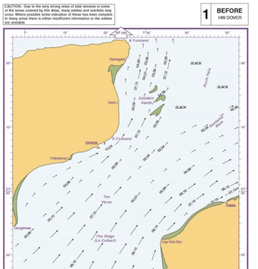

Its not effect of the tide for the hour, its the effect of the tide for the period they were in difficulty to the period the bodies were collected. We are trying to prove a hypothosis that when they asked for help they were in UK waters and when they were recovered (in French waters) it was the tide or the wind that had pushed them back. I calculated from midnight before to 1PM UTC on the day of recovery. If you want to do just 6 hours, you well get similar results:
You'll need a protractor some paper and a pencil (and a ruler). The reference port is Dover time is UTC

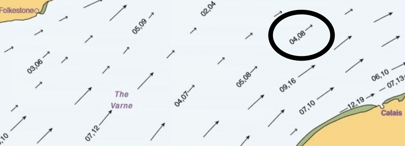

For every hour back you draw a line (say 1cm for each Kt of tide) in the direction of travel. Then you net off the effect of each hour. You will likely conclude that it is highly unlikely even over a 12 hour period that a vessel in UK waters was pushed back by either tide or wind to a position 7NM off the coast of calais.
You can assume it was a SPRING tide as I wont waste my time doing a computation. It was actually around 80% of Spring on the day (full Spring 6.4m 1.3M) is . So the tides will be slightly weaker than the numbers shown. First number is Neaps, second number is spring. So for the example below you draw an 8mm line in the direction of the arrow. My app shows it at 0.7, that is because its only 80% a spring tide on the day.
You now have everything you need to check my calcs.
