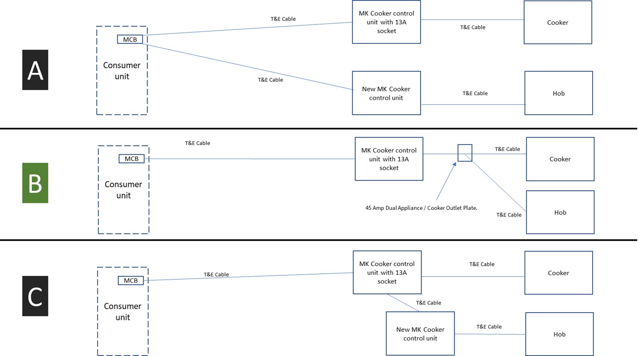

I'm trying to make a decision on whether switch from a gas hob to an induction hob. Specifically, I'd like to understand the electrical work required that is likely to be required and what I might need an electrician to do - if the hassle is to much, I'll leave it in the pending tray.
My consumer units (I have two) do not appear to have spare slots for a new spur/MCB.
I have a 45A MCB in one of the CUs that feeds a spur to an "MK 45A Cooker Control Unit With Neon" ie single13A switched socket and cooker switch
Could an electrician run an additional cable from the 45A MCB in the CU to the hob for a compliant installation (ie that MCB would connect to two cables - one to the hob the other to the existing cooker control unit)? The cable route is easy, so it would be quite handy if it is possible.

Assuming standard equipment you can connect both to your existing cooker switch using a dual outlet. https://www.tlc-direct.co.uk/Products/AA45DCOP.html

Well firstly, thanks Sparkxxx as it looks like option B in the attached is possible and that will be very easy for the fitter.

As it happens, I'll be retaining two gas rings.... Thanks all
Option B is the one to go for, you may need to add a 13A plug and socket after the dual outlet to serve the oven, depends on your model. And as for which is best, I think there are some very good egg boilers in here:D
I'll have to check whether the oven was rated to use 13A supply, but it is directly wired to the mk cooker switch (ie not the integrated with 13A socket). When I did the wiring many years ago, I over specified/engineered everything. Regards and thanks
