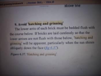

Yes, exactly that.
Also known as hatching and grinning.
My old sage taught me that hatching and grinning is laying bent bricks one way up and the other. ... grinning with dip down like a smile, hatching with the hump in the middle. The bricks should always be laid hatched to dispel water, and not in all different directions
Not sure where your old sage got that one from woody. Creased bricks should be layed so they are smiling.
