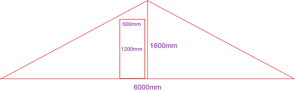

I finally got around to getting up in the loft and having a measure, and i've put this in the attached diagram. I think i'll be looking at something like 2 x 150ltr cylinders, this way they can sit off to the side and allow access to the boiler on the gable. The tanks/boiler will be sitting over a walk in wardrobe, so if it does burst there will be less chance of getting someone, but i will of course take the safety advice on board, as it sounds quite horrific.
