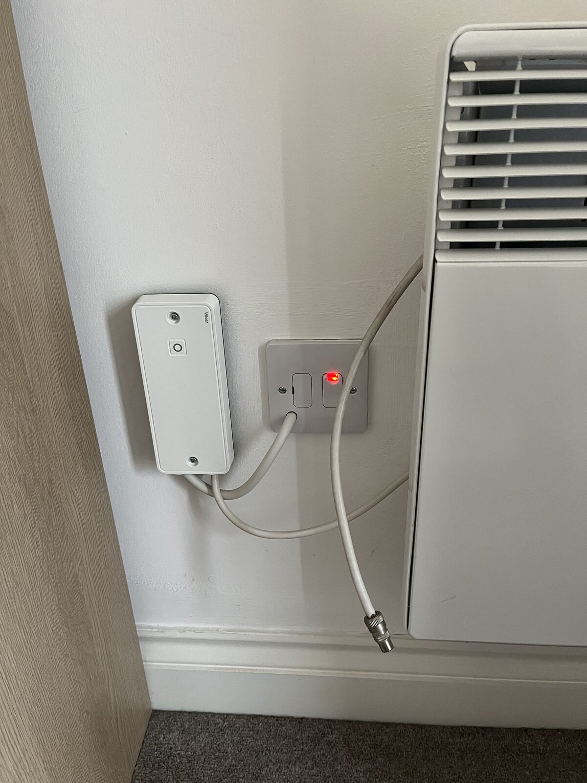

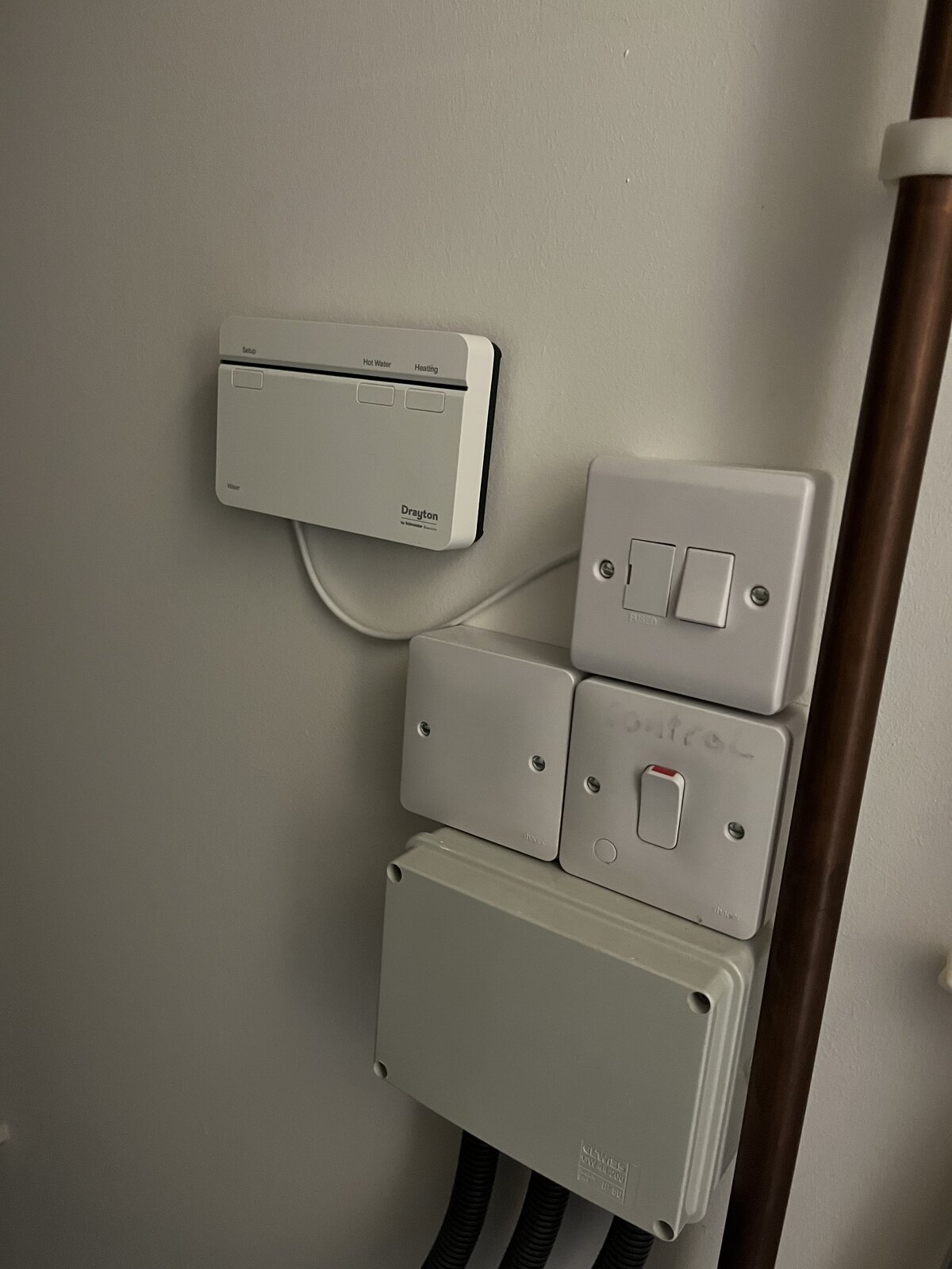

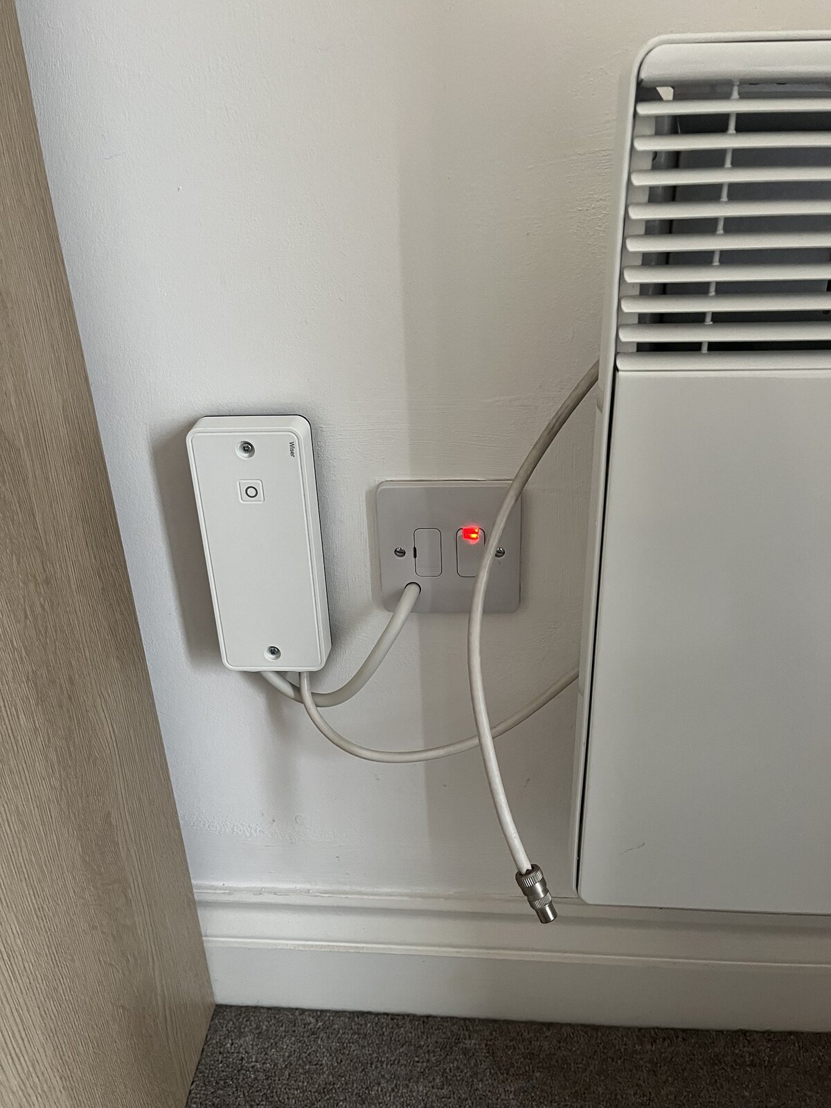

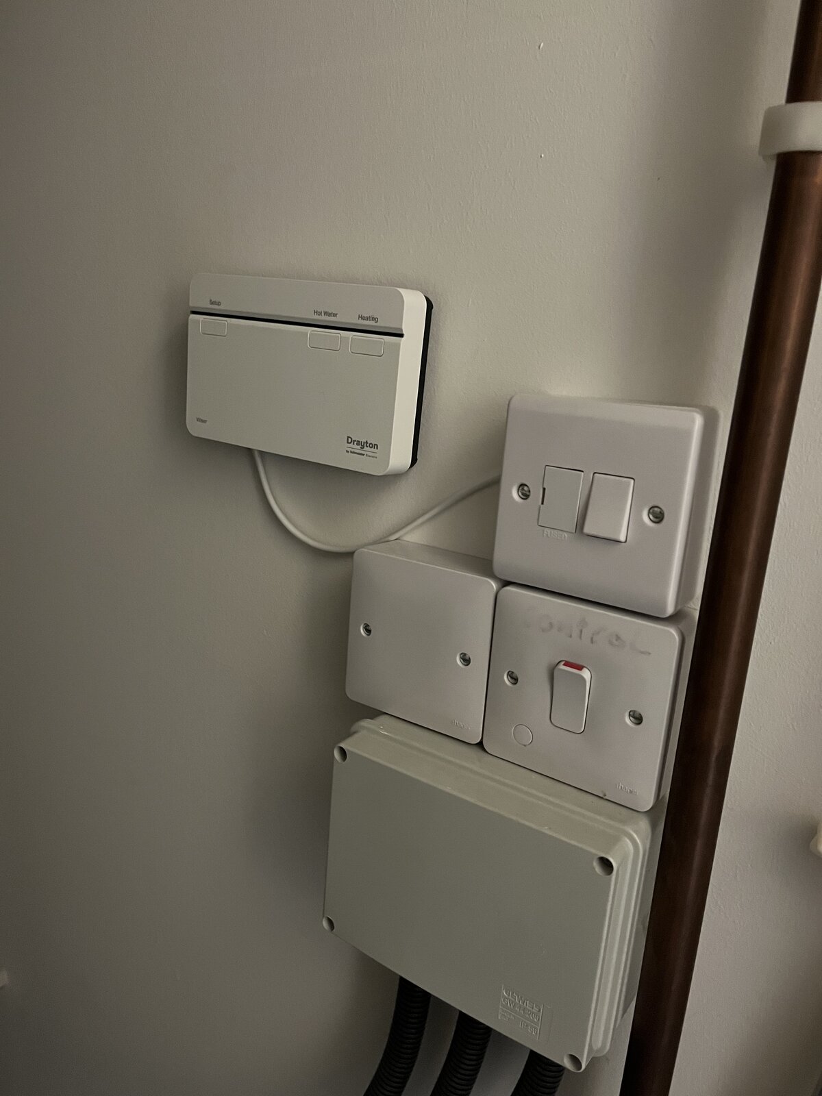

My first post in this thread. I wanted better control of a panel heater in main bedroom. Downstairs is heated by ASHP to water underfloor heating. Upstairs by panel heaters with no timing facilities. Space limitations meant I couldn’t find the right size panel heater with a timer for replacement.
The Drayton Wiser system was mentioned to me and after research decided to install this.
I installed the hub and electical heat switch.
The exisiting timer for heating is linked to the heat pump, meaning I had to install the backplate with an associated FCU - fused at 3amp, from scratch, taking the power from the adjacent FCU serving the ACHP controller.
Working reasonably well but the Wiser App is not the best, but gives useful heat related data.
The App doesn’t seem to remember the heat source for the app. When the Heat Switch is activated by the thermostat I can hear it clicking on and off - I think that this may be related to the hub cycle rate but not certain.
I have set the heatswitch to relay mode but would like to try pilot wire mode (heater has pilot wire and I have connected this to the relevant terminal) but can’t find any information on how this would work with the thermostat. Drayton support went quiet on this after a couple of e-mails.
There is competition between the heater thermostat and Wiser thermostat meaning that even if the setpoint is reached the heater doesn’t provide heat because the in built thermostat doesn’t think it is cold enough.
On the whole I am pleased and nice to have better control finally. Some tweaking of schedules and knowing where to set the inbuilt thermostat so it doesn’t compete needed.
If anybody knows more about how the pilot works gratefully received- does it overide the heater thermostat for instance
