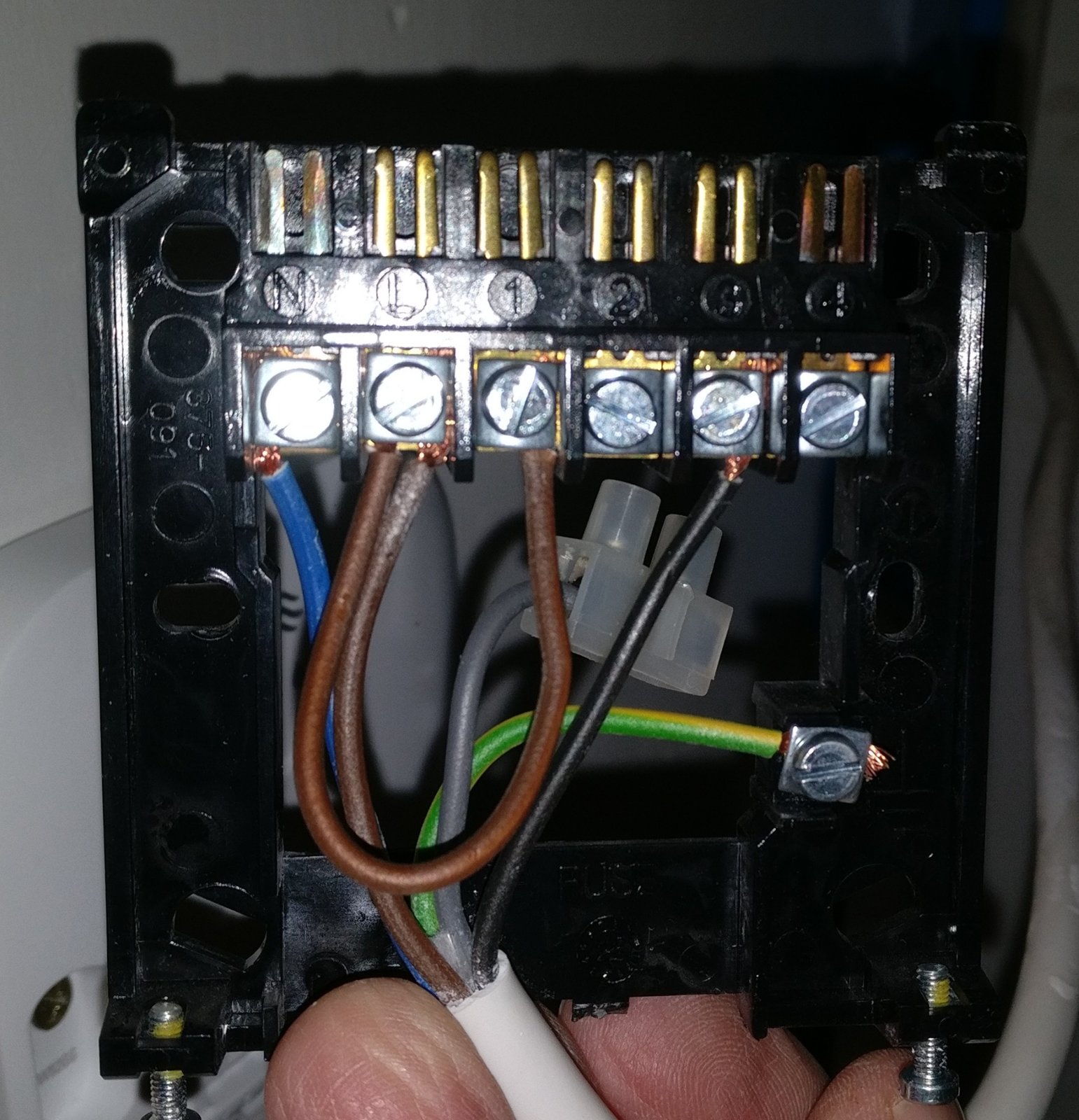

Can someone help with mine? It doesn't look like any other setup pictures.
The live is looped from 2 to 3 and the black is going into 3 (not sure what that wire does exactly, it's marked "call")
It's from a Drayton Digistat SCR going into the Vaillant eco TEC pro 28.
Any help will be greatly appreciated.
Yours is the most standard set up, presently:
N = Neutral
L = Live
1 = Common side of the switch contact connected to the live terminal
3 = Normally open side of the switch contact, is the switched live supply to the boiler
So, if you are installing a Nest, it's exactly as the diagram in the post above yours.
N and L are self explanatory
Nest 2 (common) link to Nest L
Nest 3 (call for heat) to the boilers switched live

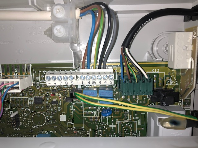

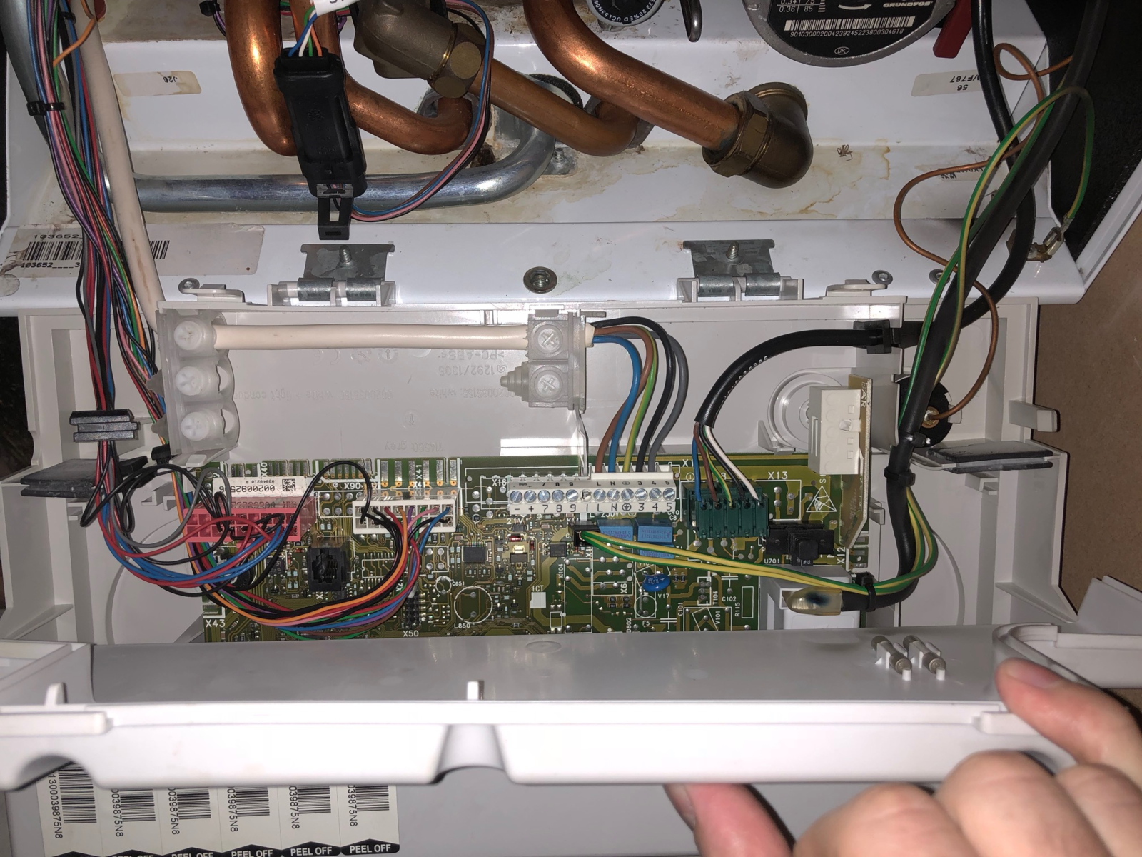

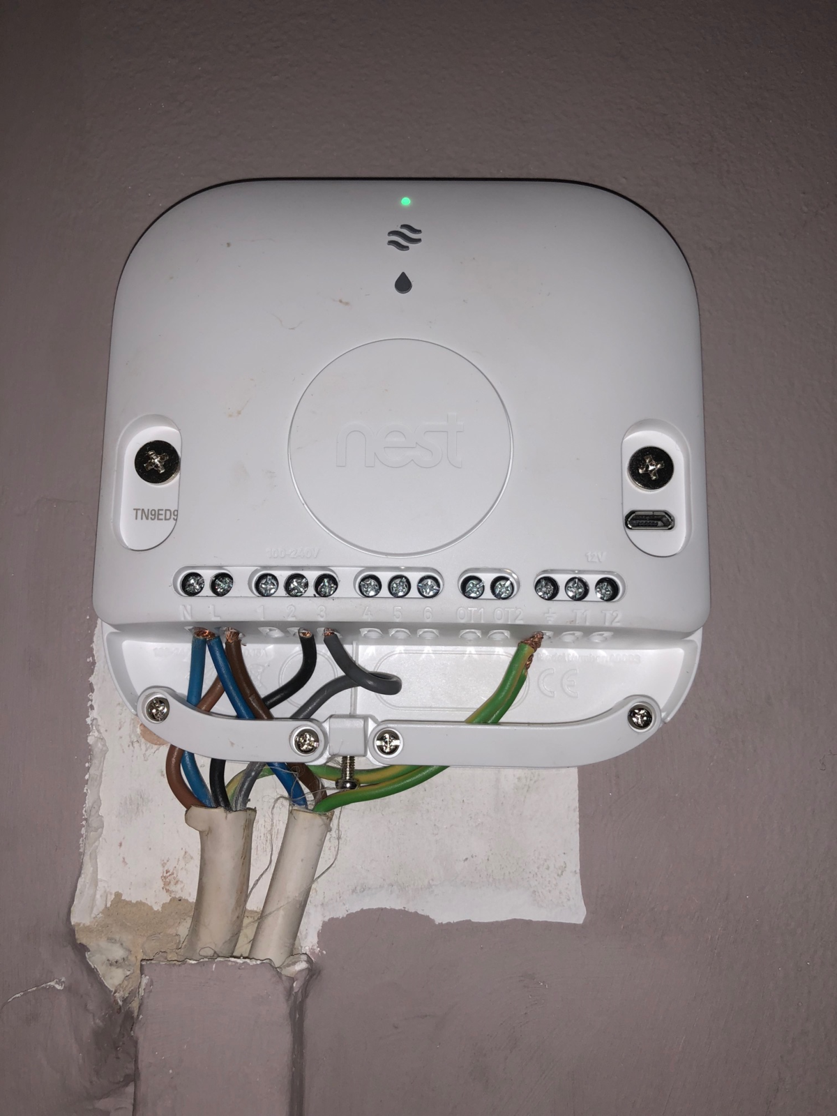

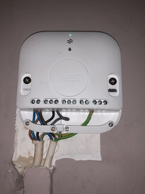

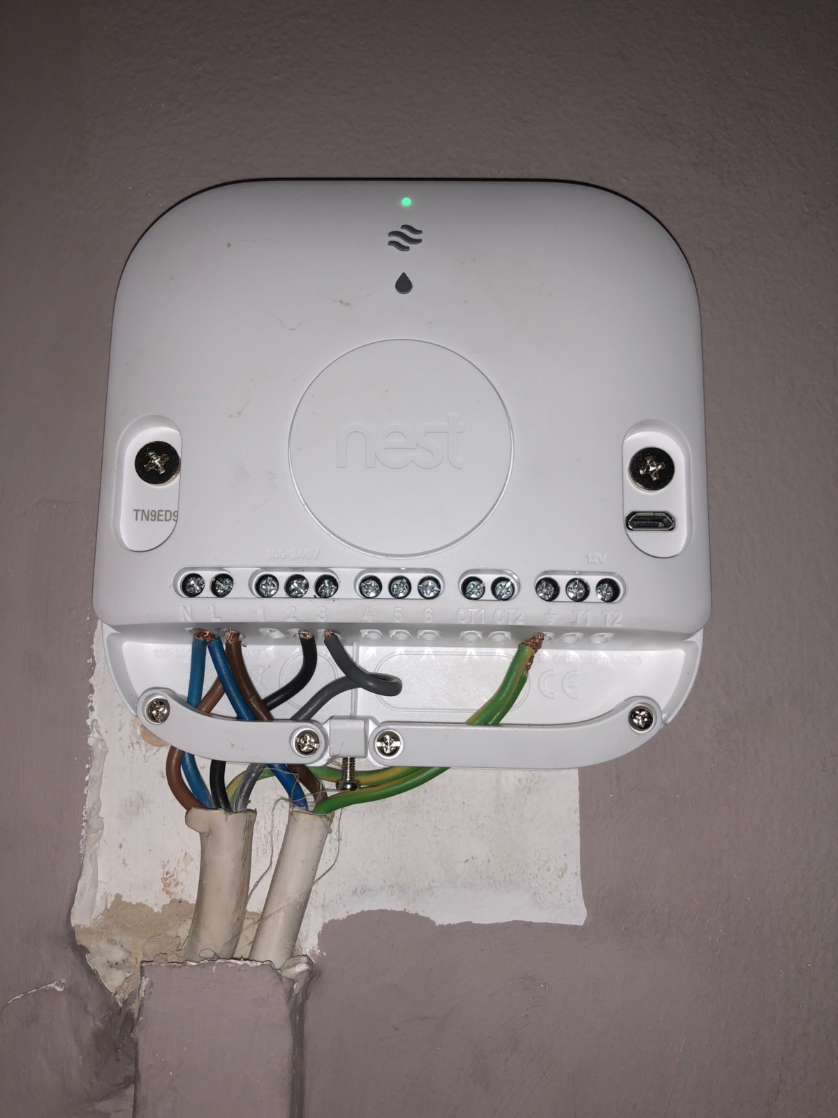

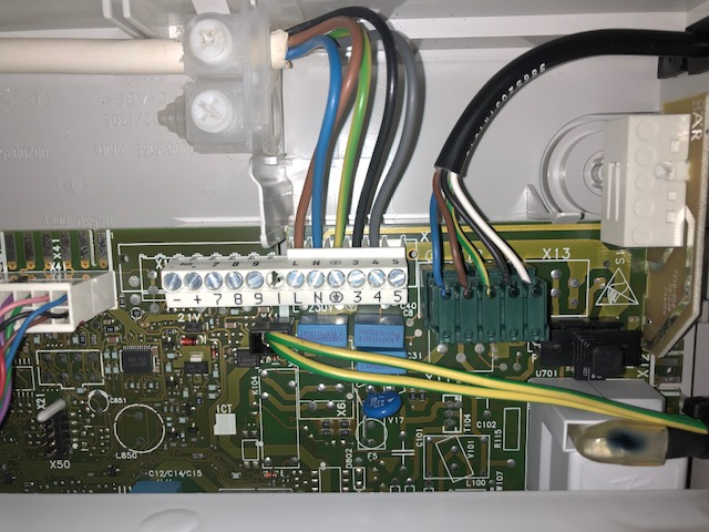

Hi,
I am trying to set up a Nest Gen 3, and had the same stat as the first photo in this thread. I have a Vaillant ecoTec Plus 831 boiler and the circuit board is shown below:
I have wire it up as per the advice shown on this thread:
However, the Nest thermostat still isn't controlling the boiler (no, it's not in manual). Is there something else I need to do regarding wiring? Such as removing something? Disconnect a programmer?
Sorry if there is already a thread on this, I have spent most of the day trying to do this.
Thanks.

Hi Johnc89
Ideally you should have started your own new thread. Adding yours on to an existing one often means that no one sees it as it's buried away. It is also called 'hijacking' and is against the forum rules. However don't start a new one now on the same subject as that is also against the rules ;)
OK, so back to your question. If the grey and black wires in terminals 2 and 3 at the Heatlink are the same as those in boiler terminals 3 and 4 then the wiring is correct.
Are there any other existing controls anywhere? Does the boiler have any integral time control? if so that needs to be set to be 'on' permanently, otherwise it will override the Nest. Is there an existing thermostat that is still in circuit?
However, the wiring at the Heatlink is very poor, and that maybe the problem. First of all, are the wires fully inserted in the terminals and the copper securely fixed under the screws? Then there shouldn't be all that copper on show, you are risking a short circuit. The insulation should go right up to (but not inside) the terminals. Just as you have done at the boiler terminals. That end of the cable is spot on!
Finally the entire cable sheaths should be under the cable clamps, not just the wires.

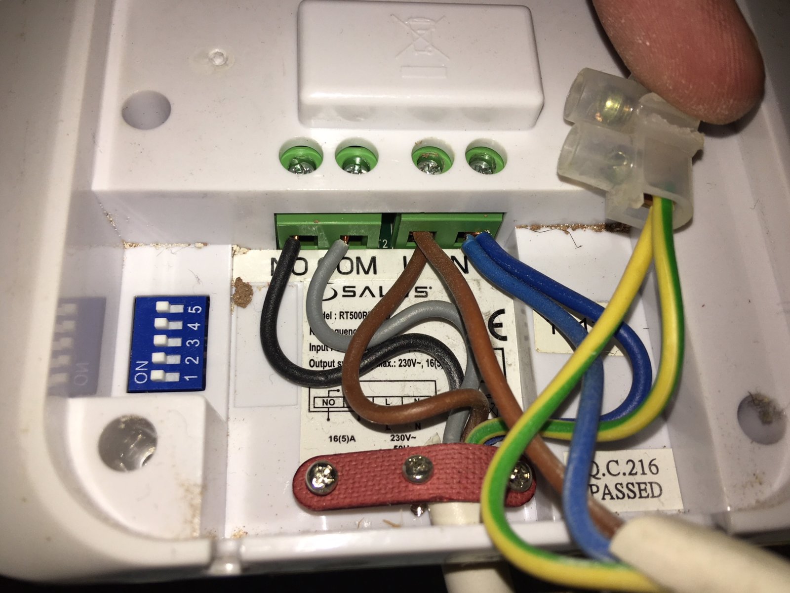

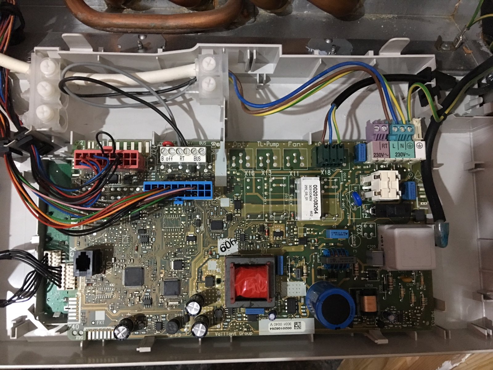

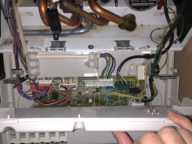

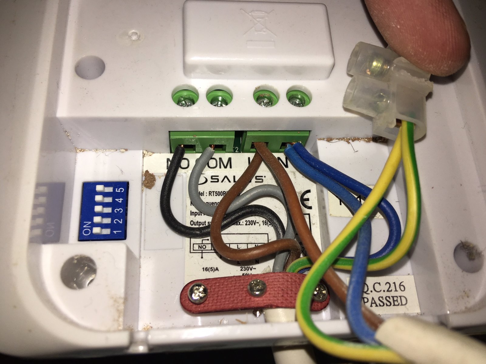

Need some expert help. I'd rather just double check before going ahead and wiring a NEST 3 in.
I've understood the L, N and Earth. Just confused with Grey and Black.
Currently have a Salus and replacing with NEST.
Does Black and grey stay in the RT ports as pictured and hook in Black to T2 and Grey to T3 on nest? or are they removed entirely?
OR do I just connect a black from T3 on NEST to the purple RT block on PCB and remove existing white block RT connections?
Any help really appreciated!
Pics attached of current wiring layout on boiler and salus.
