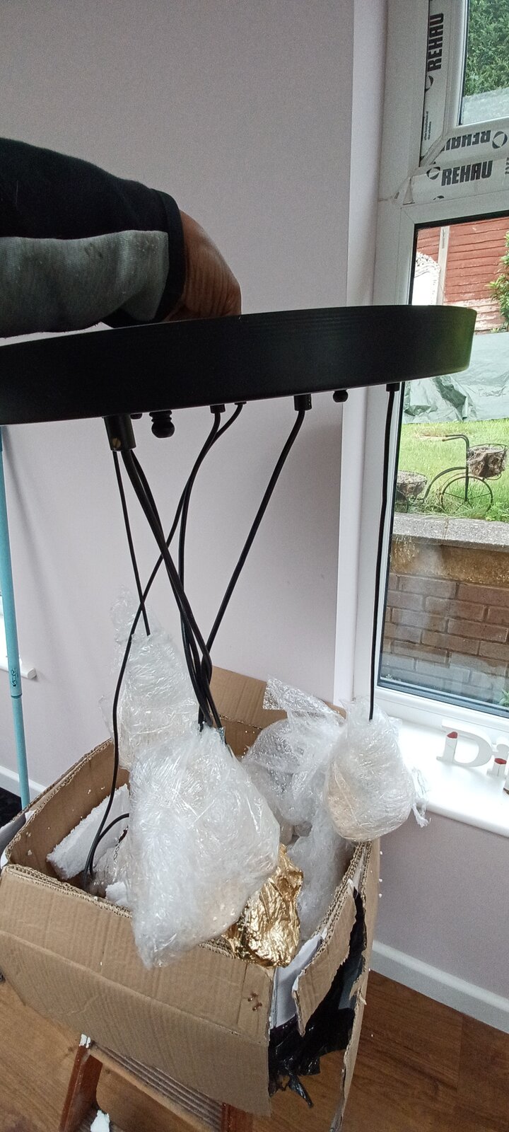

The other half has this chandelier which wants hanging. Replacing another chandelier.
It's really quite heavy. each bulb shade it very thick metal. Not thin metal or glass. Quite thick metal.

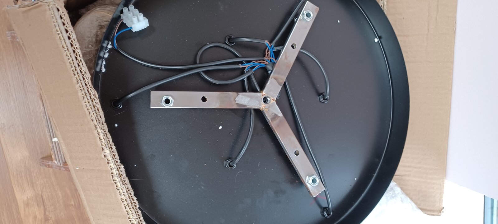

It looks like it comes with a bracket. I think it's a bracket. It came as it. no mounting instructions or hardware. It's from Turkey so can't expect much.
Any ideas really. There are three holes there which I could put a flat head screw threw of about 2.5"-3" into the truss. Though one arm will maybe require me to install a block in between the trusses? I reckon that's what's needed. Am I on the right track?

I would fit a piece of plywood between the joists. Then the bracket can screw into it.
To fix the plywood I would cut it to just fit between the joists. Then I would screw through some scrap wood or batten to both the ply plate and the joist.

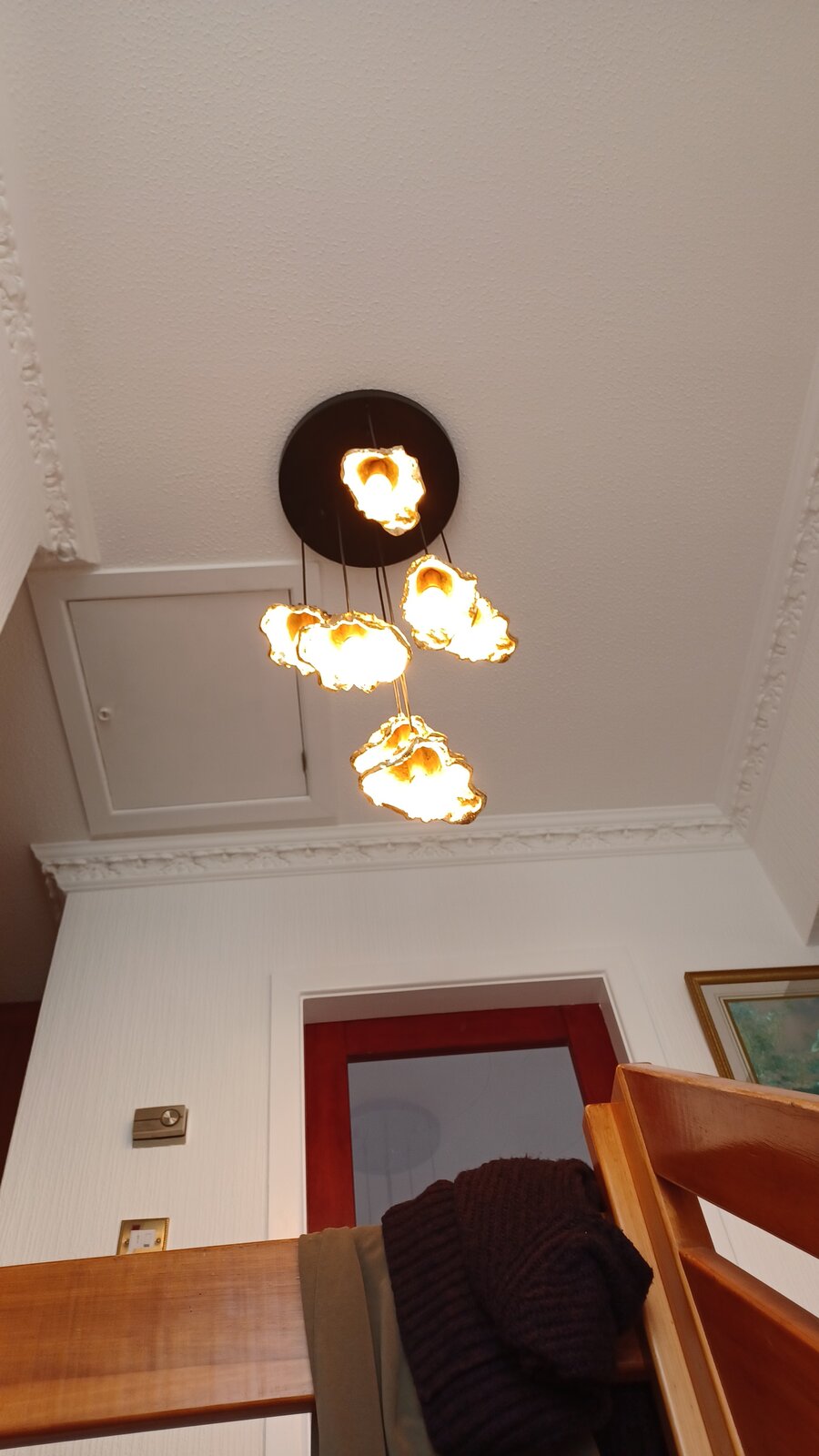

I fitted this 20220529_211956.jpg above my stairs, or at least my son did, it likely needs some wood adding in the loft, clearly not connected to plaster board, but as long as mine has one good screw into wood it is unlikely to fall off the ceiling.

I fitted this View attachment 314175 above my stairs, or at least my son did, it likely needs some wood adding in the loft, clearly not connected to plaster board, but as long as mine has one good screw into wood it is unlikely to fall off the ceiling.

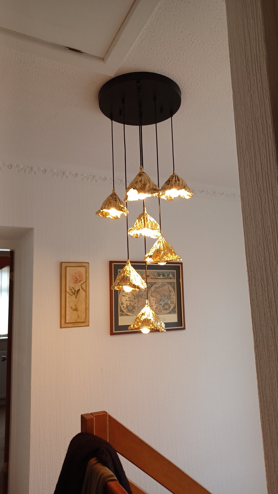

Your son's light is lovely. What my wife chose is ... well... not as nice if I am honest and probably taller.
It's far more than 4kg. Probably around 10-12kg I reckon. I might have some scrap 4" wood around somewhere I can fit between the trusses and screw into that. The other two screws I can line up with the truss so that's it's fully solid.
I was thinking an alternative was on one side using a toggle bolt. Does anyone think that would be enough?

My light, son fitted it, I told wife no way would I fit that, so she asked my son. But yours seems far heavier and I would not want to fit that. I did add a relay so I can select 1, 4 or 5 lamps, centre lamp colour changing Centre_bulb_colours.jpg wife not keen on the red option says its giving the wrong signals!
Get up in the loft and find where the joists are and screw fix noggins between them in line with the fixing holes. Use dowel screws, one end wood screw which fit in the joists/noggins and one end machine screws which fit through the fixing holes into nuts and washers beneath.
If the light fitting is too heavy for this loop suitable steel wire through the holes and up into the loft around or through the noggins.

I found plenty of boards in the garage to put it up with. But found the insulation rather gritty and terrible. At least it's beside the loft opening so no crawling in a very dangerous loft.
I can easily attach a ground wire to the metal bracket if needed - if there is one in the loft wiring. Most the lights in the house don't have it available.

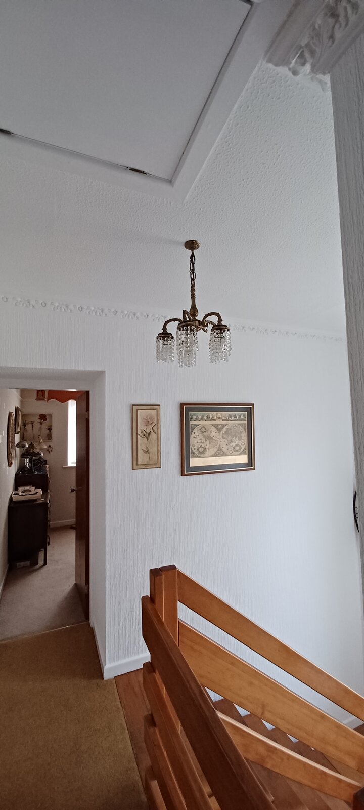

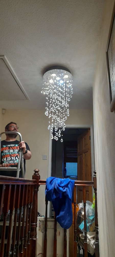

Managed to get this on.
Added a board into the loft beside the one already there. Used 60mm screws and washers for the bracket. This ain't going anywhere.
Two ladders with a board in between with the son and wife help to hold it up. It was 10kg! each of those shades is solid cast aluminium.
The original loft wiring only just barely reached through the ceiling. No rose in the loft...sigh. No ground wire in the loft either so the loop is elsewhere.
It looks quite nice!

Do you have to duck your head when you walk up the stairs on to the landing?
Not all. It is not hanging over the landing or the top section of stairs at all.
But you can still play with the lights as much as you like! :giggle:
