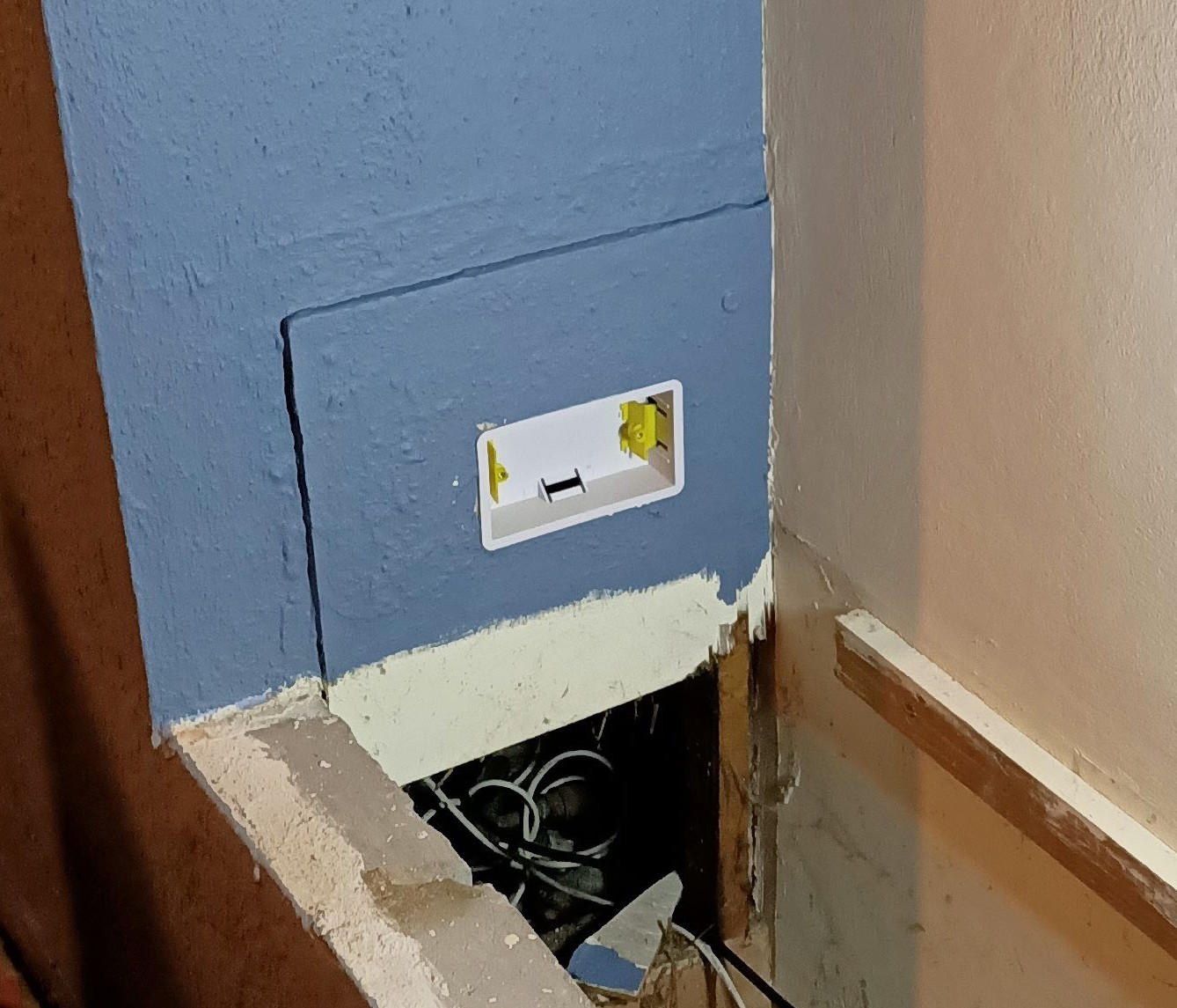

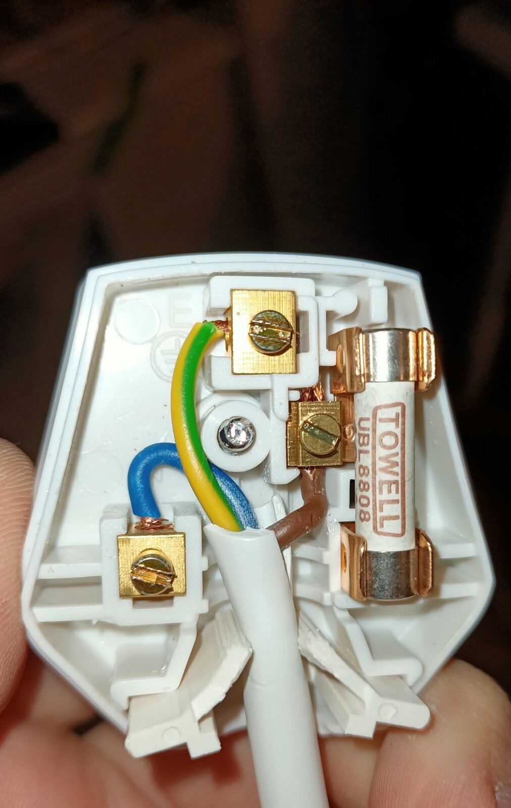

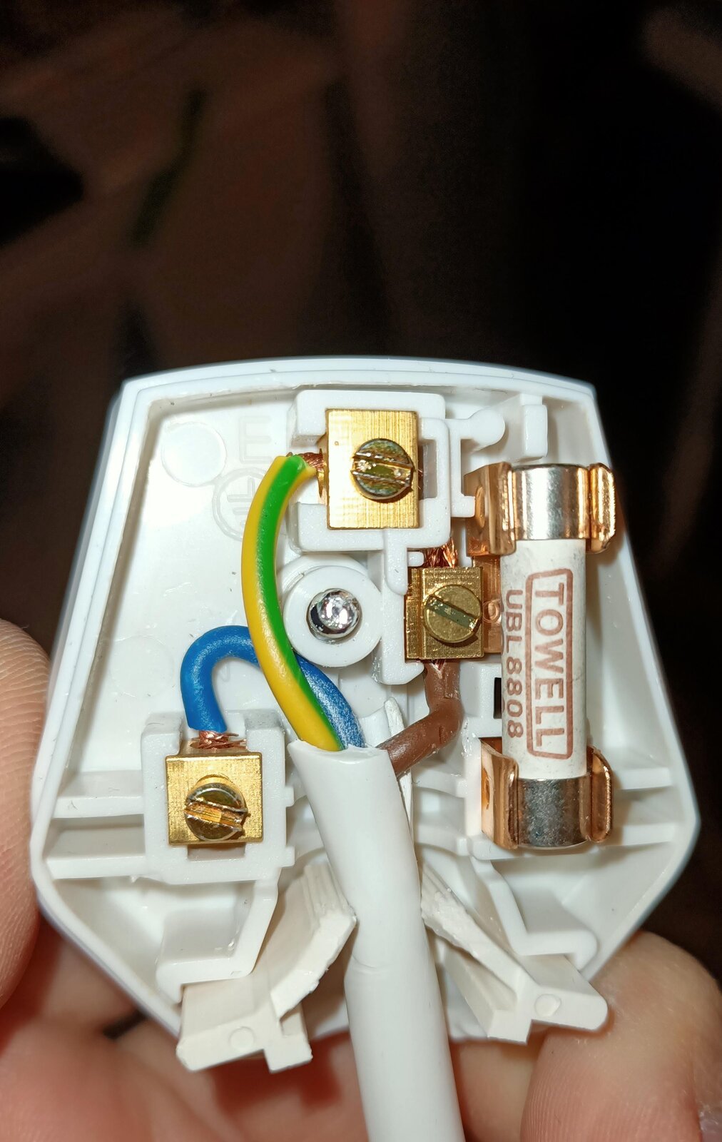

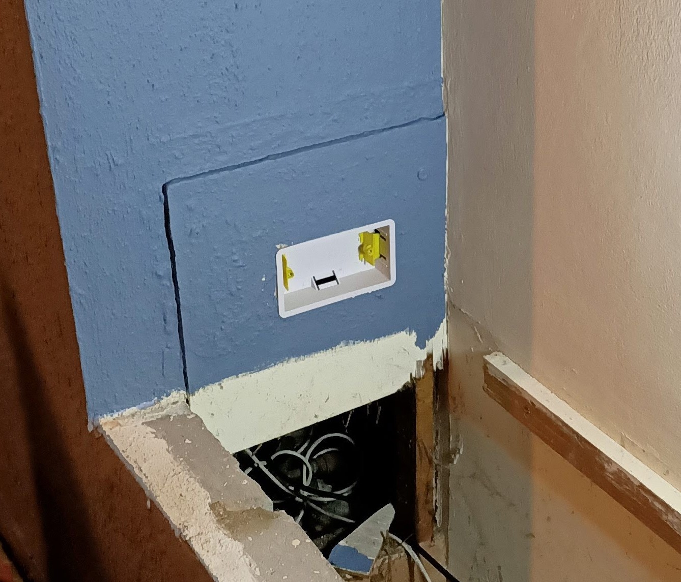

Hi, we are desperately low on plug sockets and have an option of adding a new double socket in an existing hole, but chasing the new spur is out of the question (we rent). The wall is hollow and leads into an open space so are able to use the other end of the cable. Would it be legally ok (we have an electrical inspection soon) to wire the double socket using 3183Y 1mm cable but run that to a 13A plug which we plug into a plug socket further down? So really more of a permanent extension lead?

Thanks, I'll swap that out.. would you say the whole concept is technically sound though?
1mm is rated at 10 amp i think, 1.5 is more suitable
View attachment 232196 View attachment 232197
Thanks!
What do you mean by lower down?
