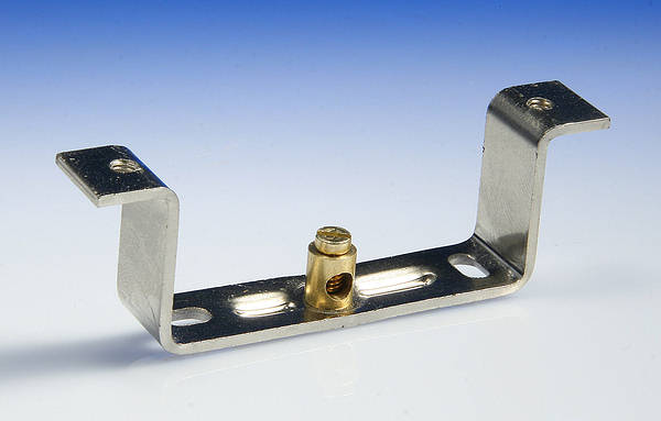

Edit, googling found this
expensive but DIY copyable..........
Yes this is the only one I could find as well. The issue with this is that the single box is centred and the Aquara unit has the back piece offset to the left. So unfortunately would not work.

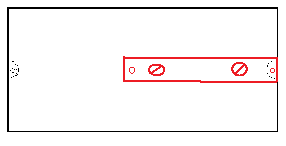

This looks very useful, thank you! If I am understanding correctly, this is how it would be fixed? Existing blackbox in black and the adapter in red, with the two screw fixings.
Looks like the panel is designed for continental back boxes with 60 mm fixing centres and 71 mm gang spacing. The bracket shown above should work though.

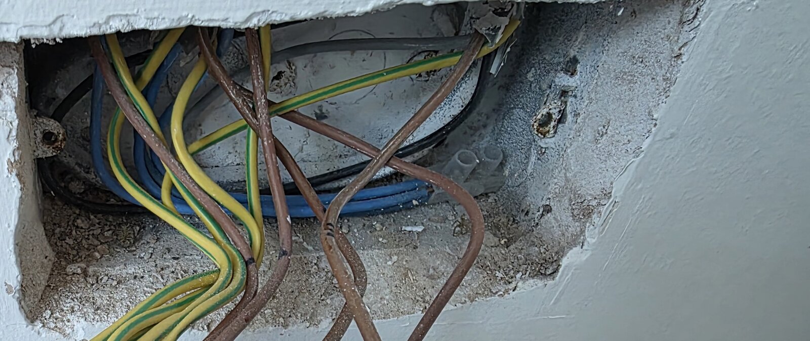

This is the existing back box

mk k2200 may do the job
There is a bloke on ebay that sells custom made adaptors for about 18 quid
Interesting, with that mk won't have anywhere to readily connect the earth to? currently it's connected to the back of the switch.
I came across the ebay one, but I wanted the single gang offset to one side to fit the aqara unit over the existing space. Will message them and see if they can make something.
