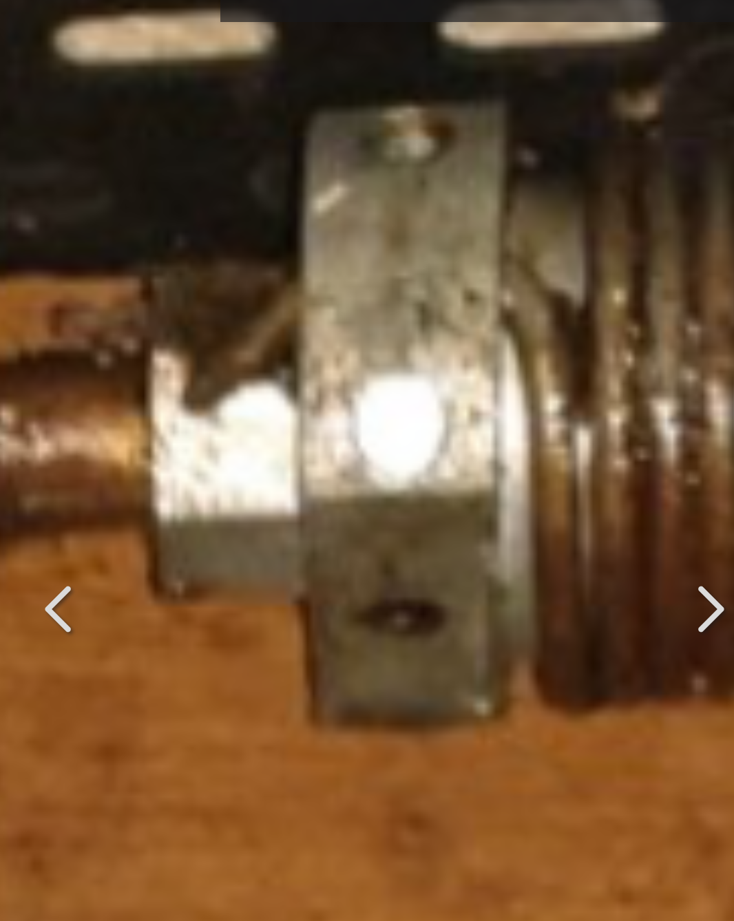

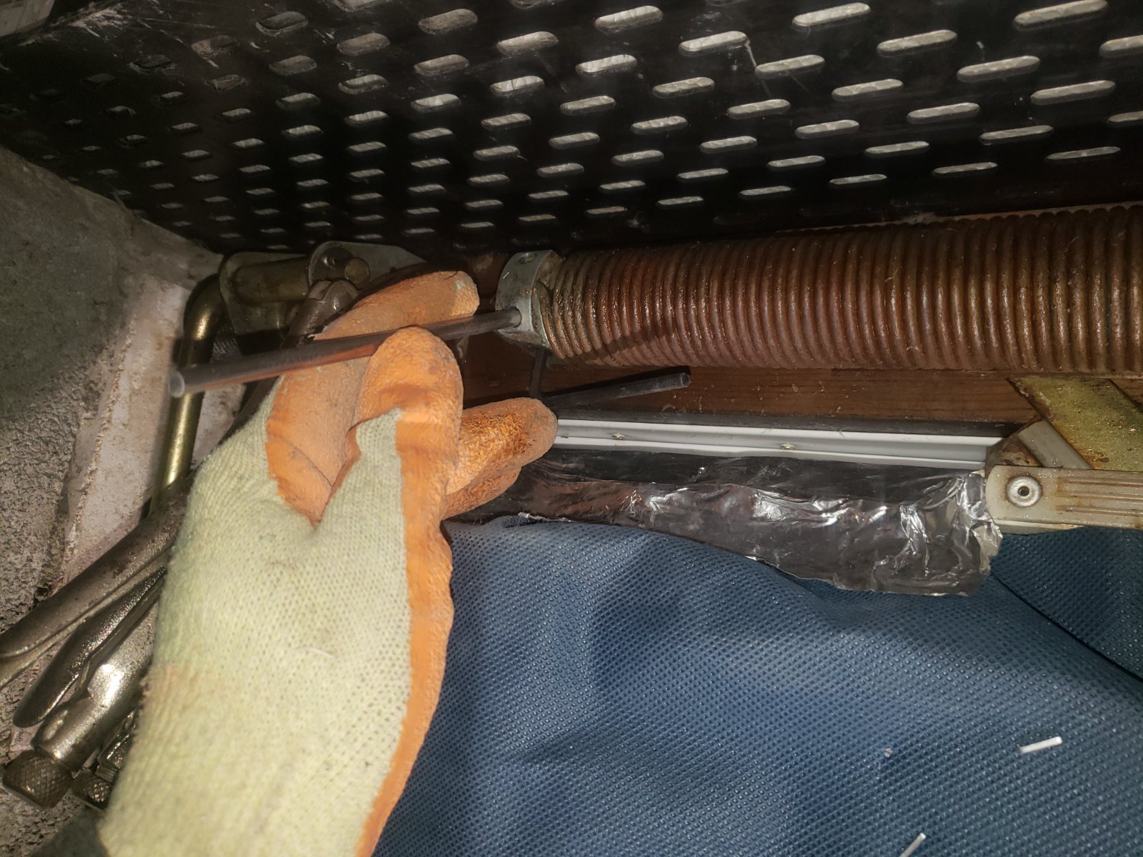

Could do with better pics of this end:
But basically that is where you adjust the spring tension. Somewhere in that block will be a grub screw or similar that clamps that block to the circa inch thick pole visible on the left of the pic (looks a bit like copper pipe in that pic) and you can also see a large silver lump with holes drilled in. You basic procedure is to find two metal rods that fit the holes well, insert one rod and hold it tense (in the opposite direction to what the spring will cause the block to spin ie in your case you will apply upwards pressure to the rod because the spring coil wants to rotate the block so the rod moves downward
When you have applied up pressure to the rod and released the grub screw, the block is free to turn. You push the one rod up until you can get the next rod in the next hole in the block, you insert the second rod, take the tension with it and remove the first, push the second rod up and rotate the block, then reinsert the first rod in the next hole
Thus you end up "walking" the block around in a circle using two rods alternately until you have tensioned the spring more. The more you load the spring to more it counterbalances the new weight of the door. Tension it just enough that it stays open

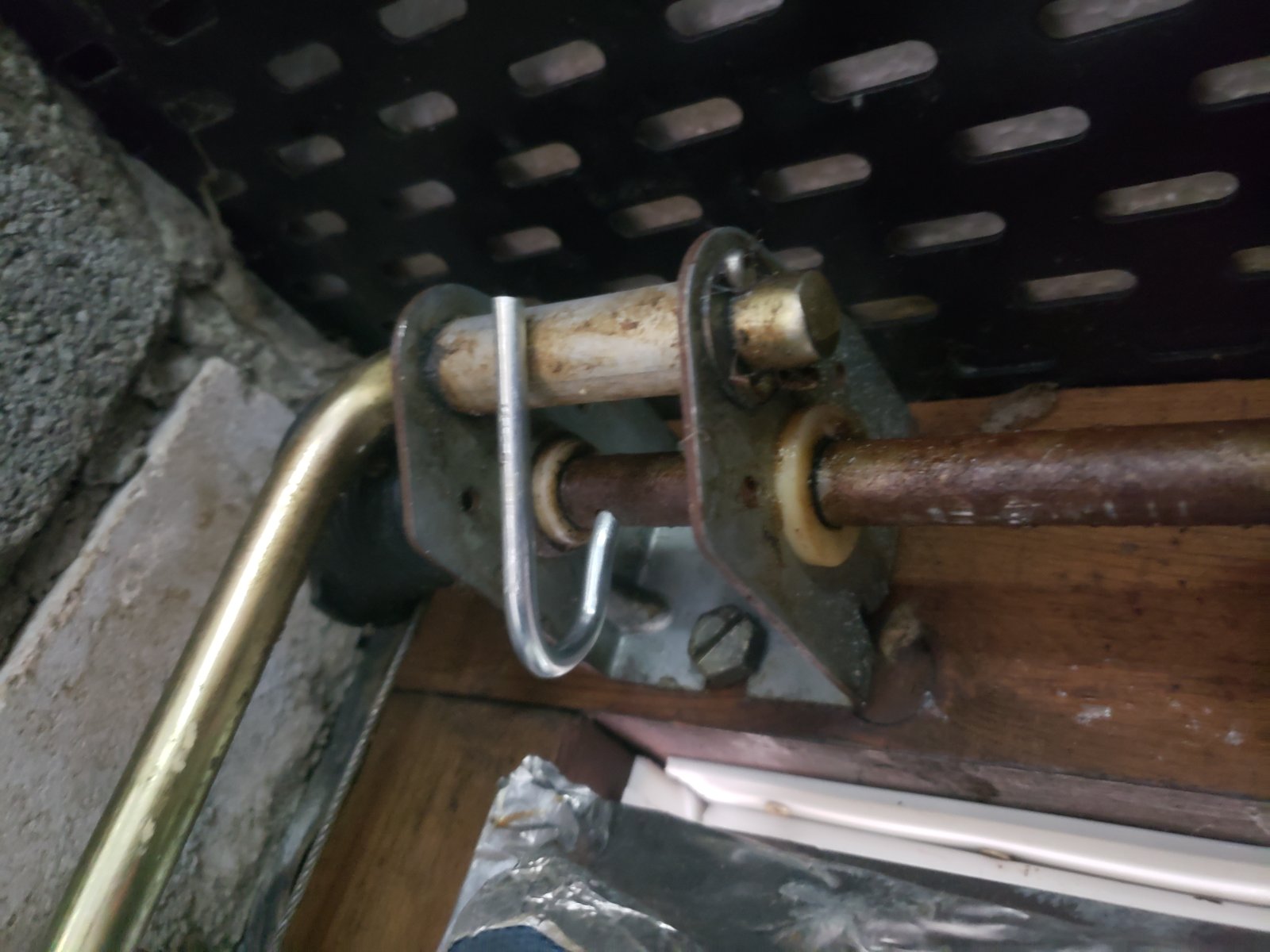

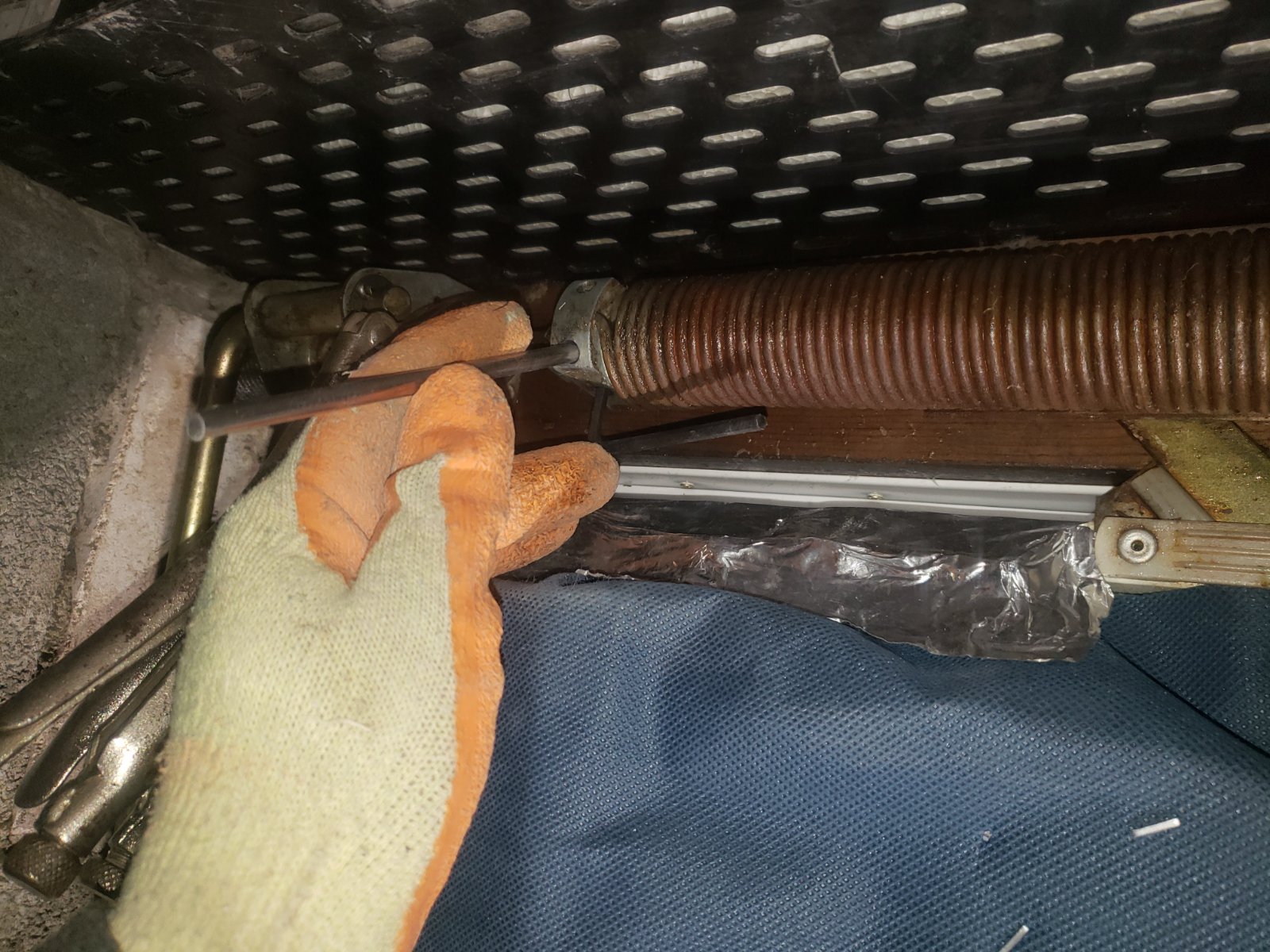

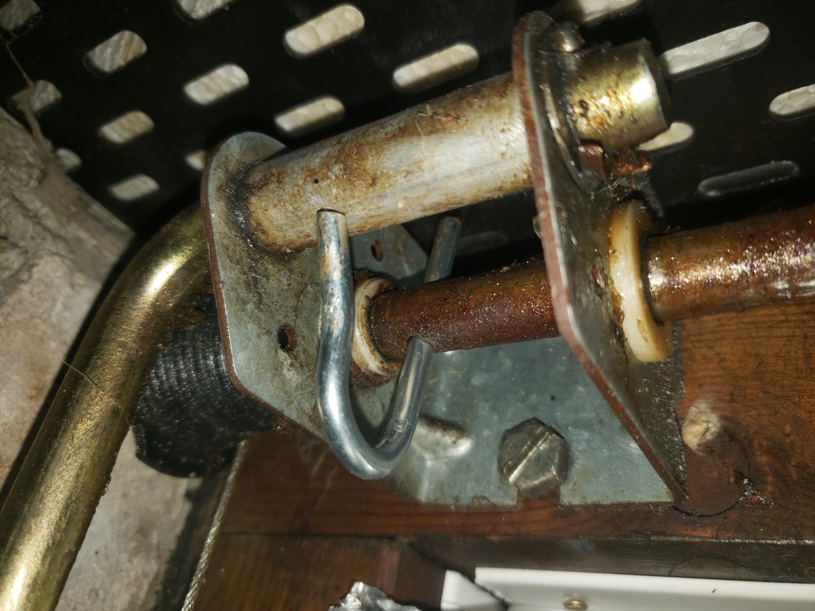

The crook pin, when inserted (see ‘crook pin(4).jpg attachment) does not lock off the shaft to prevent the shaft from rotating with the spring plug. I have successfully used the allen key and 1 toggle bar to rotate the spring plug upward (see ‘allen key and 1 pin.jpg attachment) but the shaft rotates about 90% of the rotation that the spring plug does so the spring is not tensioned very much if at all. I have used mawl grips to grip the shaft which act as shaft movement stoppers. But I do not know how to lock off the shaft such that the shaft cannot rotate at all. How do I lock off the shaft so that the shaft cannot rotate?
Please assist thanks

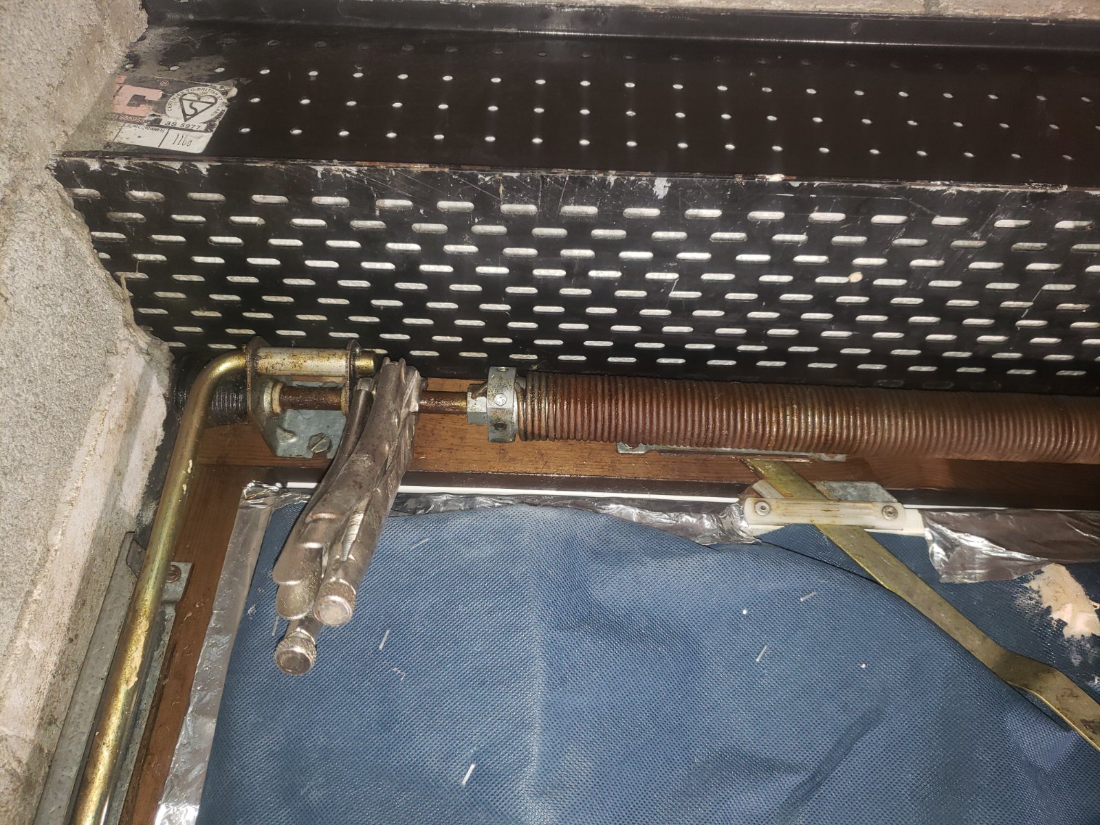

You undo the grub screw with the Allen key and then use two bars to walk the block repeatedly, over and over and over again, until you've put tens of turns on the spring. Then you do the grub screw up locking the block to the shaft.
Do not undo the grub screw without having one locking bar in the block. With the grub screw undone if the central bar that carries the pulleys that wrap the lift cables is rotating nuisancely you can lock it off with grips, but it looks like your crook pin should be preventing that nuisance rotation. Turn the shaft to take up play in the cables then lock it off so it doesn't rotate as you tension the spring
In most pics you'll see of garage door springs there is a spiral line on the spring (done by the manufacturer painting a straight line on it while it was untensioned) that indicates how many turns it has on. I can't see a line on yours but if it's untensioned the line might be at the back
If the tension has been fully released it will need many turns to get back to where it was and more turns to counteract the weight of the kingspan
You can tension it by feel/experiment: put 20 full turns on it (boring I know, you'll be there a while) and see how it holds up. If it drops still, put more turns. If it is jammed open and hard to pull closed, release some tension
The 100mm kingspan insulation just under the block prevents me from using using two bars two bars as I can only use one of the holes in a position of 45 degrees from facing vertically down.
Do my mawl/mole grips that I put onto the central bar (see 'mawl grip' JPEG) stop the bar from rotating? The bar does lift when I push the bar upwards. Should I put mawl/mole grips onto the bar inside the left hand bracket and as per 'mawl grip' JPEG (on central bar) at the same time?
The garage door does lift if I push it upwards with some force (equivalent of about 15kg pull force needed from me to lift the door and the door itself cannot stay open without effort) so the door is definitly tensioned. I'd guess about 5 to 15 rotations tensioning should fix it.
How do I put full turns on the block given that I can't put a bar into more than 1 hole at a time? There are 2 holes on the block 1 accessed from below the other from 45 degrees from below. The RSJ above prevents any rotation from above or near above. Basically access to the block is very tight. And I tried using a flat spanner on the block integrated nut but because the spring wire comes out on top of the nut I can't get the flat spanner to sit on the nut.

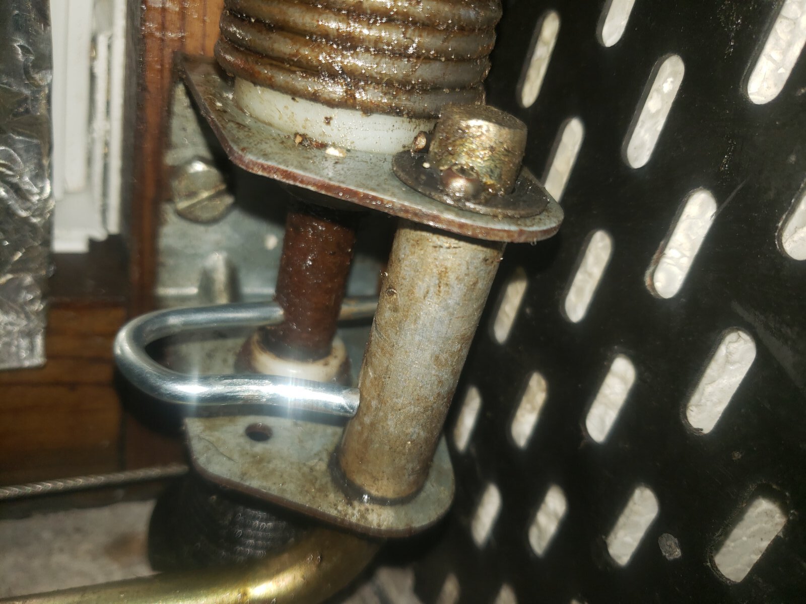

The Henderson manufacturer got back to me and said that the crook pin needs to not only go through the shaft hole on the right hand bracket but also the wider part of the pin goes over the adjacent tube (see Figure 2 of attached) and not just abutt the tube (what I do not, see Figure 1 of attached)
Is this manufacturer advice correct? Moving this crook pin apart (4mm metal alloy is very difficult to move apart using my hands) is not easy at all

I've attached two pics of the crook pin orientation. I think the 2nd JPEG photo showing the crook pin with the long bit over the white bar is the correct position. I want to make sure this is the correct position. Which position looks right?
But you installed that bit, so you need to find a workaround for it..
Neither, to me. Looks more like it should be horizontal and hooked over the tube so it can't fall out under gravity
The hole in the bar is from below so I assume you mean the crook pin needs to hook over the tube from below? To hook the long end of the crook pin over the tube I need to hammer the the crook pin, as in position in JPEG 'crook pin position' upwards. Can't see another way of doing it. Am I right?
The bar rotates?
Yes the bar rotates but the garage door rotates when the bar rotates. I can only adjust the spring with the garage door closed/shut or slightly open.
Do people normally adjust the garage door spring with the garage door shut or slightly open? In the video I have seen where the garage door springs have been tightened the garage doors have been shut
The bar is rotated by the spring, winding the cables onto the pulleys and helping lift the door. The more tightly coiled the spring, the more assistance it provides. The resting position of the bar is a function of the length of the cable; the spring will always try to rotate the bar by uncoiling and the cable will always try to resist the rotation.
If you need the bar to be rotated a quarter of a turn or whatever so you can get the locking pin into correct position, you can either use a bar to tighten the spring without having undone the grub screw in which case your efforts of coiling the spring will turn the bar, or you can take the tension of the spring up with a bar, undo the grub screw and thus the bar will be free to rotate the quarter turn you need it to to lock off. Tightening the spring loosens the cables. Take great care to ensure that the cables are well positioned on their drums when returning the system to its starting state, pre quarter turn
If you can't work out how to make the bar do that quarter turn, just lock it off with mole grips, undo the grub screw and then use two bars to tension the spring in a walking fashion. If you can't get the second bar in having walked the spring as far as possible with the first bar, because there is essentially a massive block of insulation in the way that wasn't there before the door was insulated, then cut and remove enough insulation to get the second bar in, tension the spring, lock the grub screw, remove the bar lock, and see how the door operates, then glue the insulation cutout back in place using expanding foam
