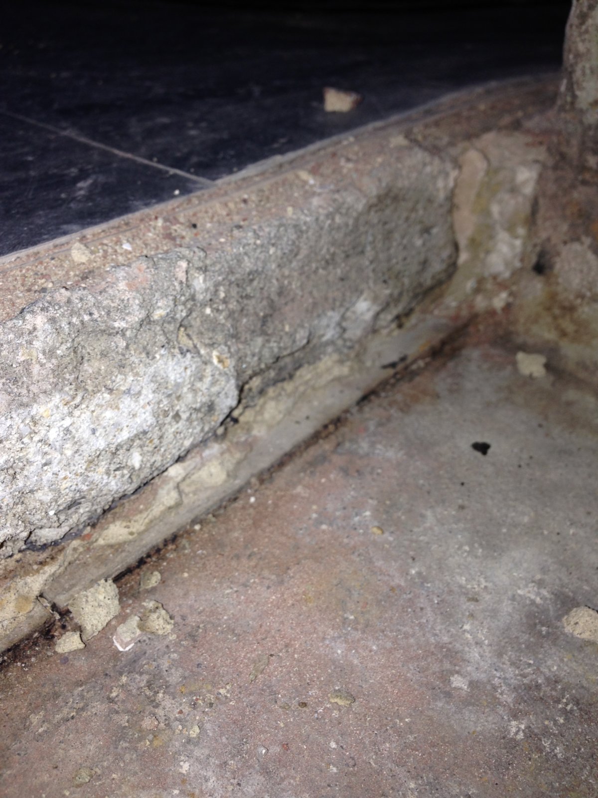

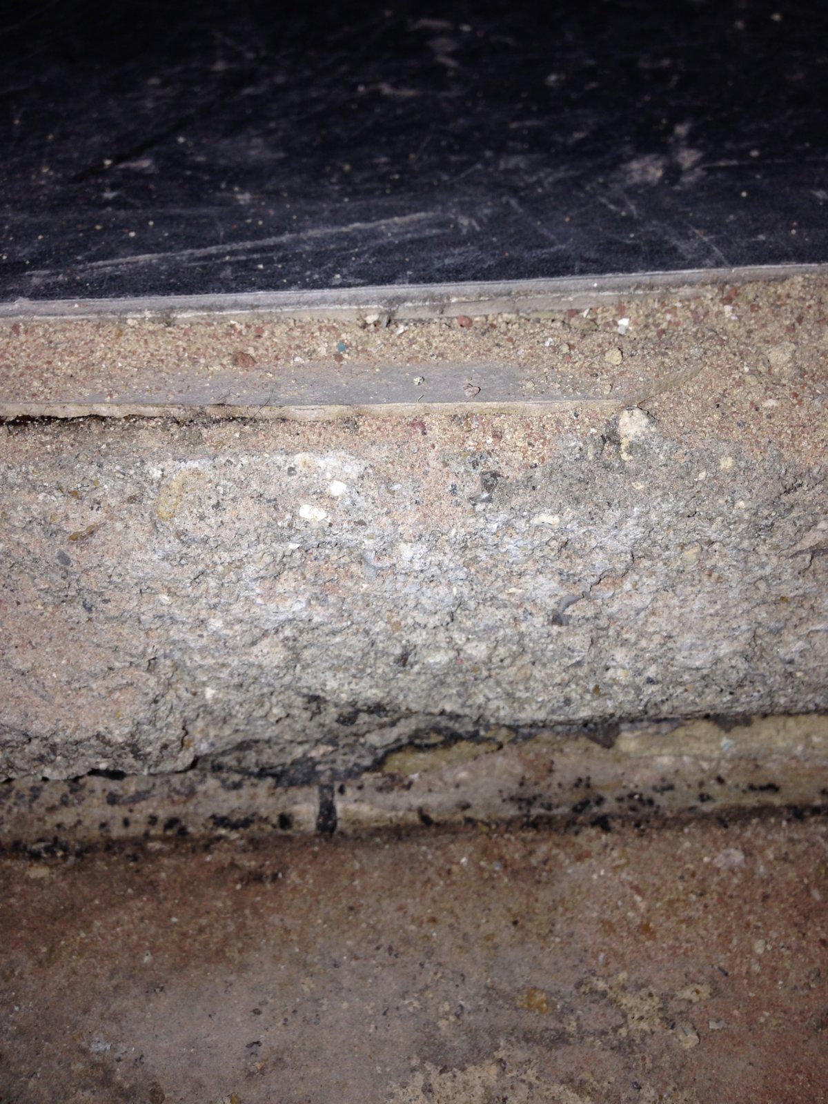

Intersting you say that as I realised I can see a cross section in the fireplace I've opened.
Looks like it has been screed over the original floor. Looks like old floor coverings in the photo???
Might mean the top 50mm would chip off easily?

I had a dig about earlier and found that the floor has previously been screed with a 55mm layer. I hacked the 'new' screed away and can see it was laid straight on the old floor tiles.
This has got me thinking - I could hack it away (where kitchen cupboards won't be) and lay underfloor heating.
The 55mm thickness could in theory accommodate a ~10mm screed / floor levelling compound, ~2mm membrane, 25mm celotex insulation, then Nu-Heat underfloor heating which is apparently 18mm thick. Then tile on top of the lot.
