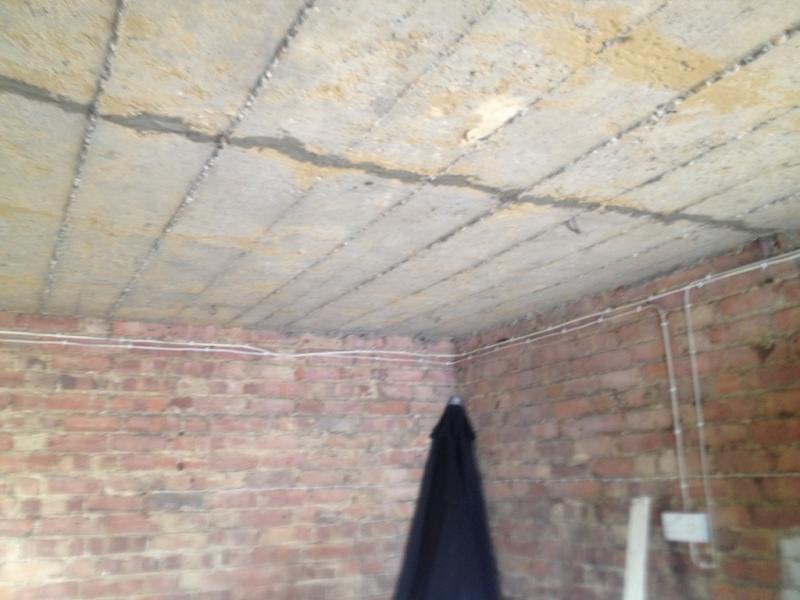

Hi Folks,
Moved into a 1930s place last year that has solid walls. CH is on already and it's still bl**dy freezing!
Anyway, one room is above the garage. It has a timber floor on joists which are suspended above a poured concrete slab (garage ceiling). Half of the wall of the room is also in the garage since it has a pitched roof that connects to the house halfway up the external wall (see pic).
The floor in this room is always freezing (not surprising - no insulation).
I was thinking about pulling the floorboards up and insulating between them, but after I thought about it for a while I think it's better to insulate with rigid boards from below because I can go round the corner and get a bit of the external wall too (but still inside the garage).
This will also reduce any cold bridging where the floor meets the external wall (note: plan to have external insulation done over next few years).
Anyway - would peeps agree this is the best approach? And if so, what can I use to stick the boards to the concrete slab from below? Want to avoid mechanical fixings if possible since the slab is a bit sandy and crumbly (don't think the mix was right when it was poured 80 odd years ago).
Garage construction:
Garage slab (bit crumbly):

As I said, originally I was intending to insulate between the joists, but it seems better to insulate from below since I can then take the insulation up round the exterior wall which is covered by the garage porch.

Hi Nebjamin. Sorry I know your thread is old now but this is exactly the problem I’m having. Did you do the Kingspan insulation and if so did it help?!
Insulation on its own won’t make the floor warm.
you can’t Only rely on glue/foam to adhere pir boards to the ceiling, it will need some mechanical fixings as well.
you could lay pir on the concrete floor and float your floor, if it’s wood/engineered, not if it’s carpet.
if you really want it warm, ufh. :LOL:
