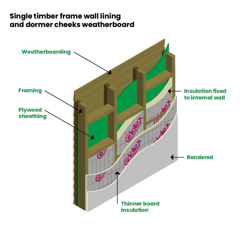

So my plans for the wall are as follows outside to inside
T&G cladding
Tyvex fixed to frame studs
PIR insulation between the studs
waterproof membrane ( for draft/noise insulation)
T&G cladding

One thing I learned is 100mm timber is not 100mm dried. It comes in at about 95mm. You want your PIR flush to the outside and any air gap between PIR and plasterboard. It will only be about 20cm.
I was always lead to believe that the gap should be on the outside (on the cold side) of the wall ?
