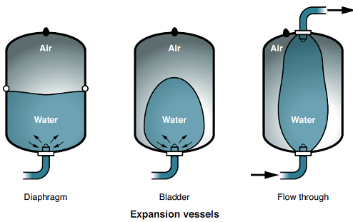

Muggles suggested maybe fitting a mini expansion vessel
In hydraulic terms a dead leg with trapped air is the same as an expansion vessel with trapped gas ( nitrogen or air ) except that the expansion vessel has a membrane separating water from gas.
If you truly were the font of all knowledge you would know where the mini expansion vessel goes in relation to the sensor it's not rocket science.
And before you run to the mods please note I never called you names I said you was acting like one - as usual :)
And doesn't pose a legionella risk.
HSG274 Part 2 Published 2014
In pressurised systems, a means of accommodating water expansion (caused by the water heating) is required. This is often achieved with the use of an expansion vessel. However, these may not fill and empty where the system pressure and temperature remains steady.
There are several types of vessel available including diaphragm or bladder type, with fixed and interchangeable (replaceable) bladders, as shown below. These internal bladders are often made of synthetic rubber such as EPDM and may support the growth of microorganisms including legionella, so check to see if these are approved against BS 6920. Vessels with a ‘flow
through’ design should provide less opportunity for water to stagnate and become contaminated (as in the latter design).
( admittedly this HSGis directed at commercial/industrial systems but legionella bacteria cannot tell the difference between commercial and domestic water systems. )
