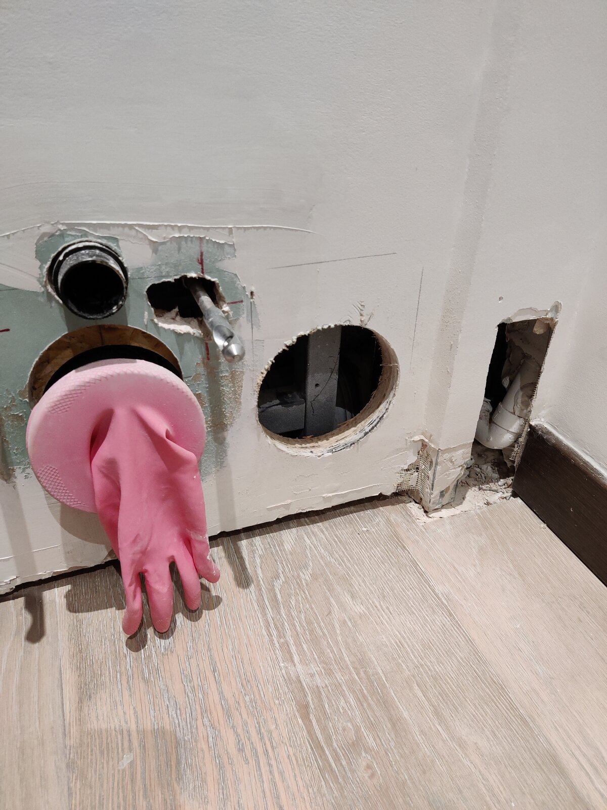

Hi all
We've been experiencing an intermittent smell from our downstairs toilet for the last few months. We've tried replacing the pan connector and have had a CCTV inspection on the drain, but the problem persists. Last week I removed the toilet again and disconnected the sink trap. Both have been capped but we're still getting the smell.

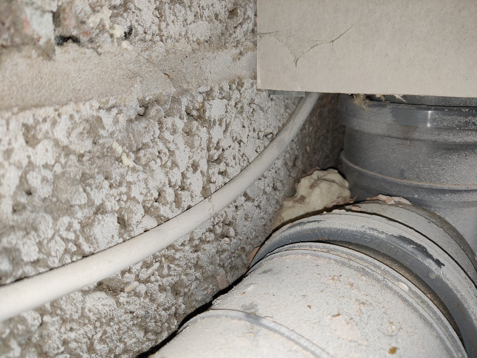

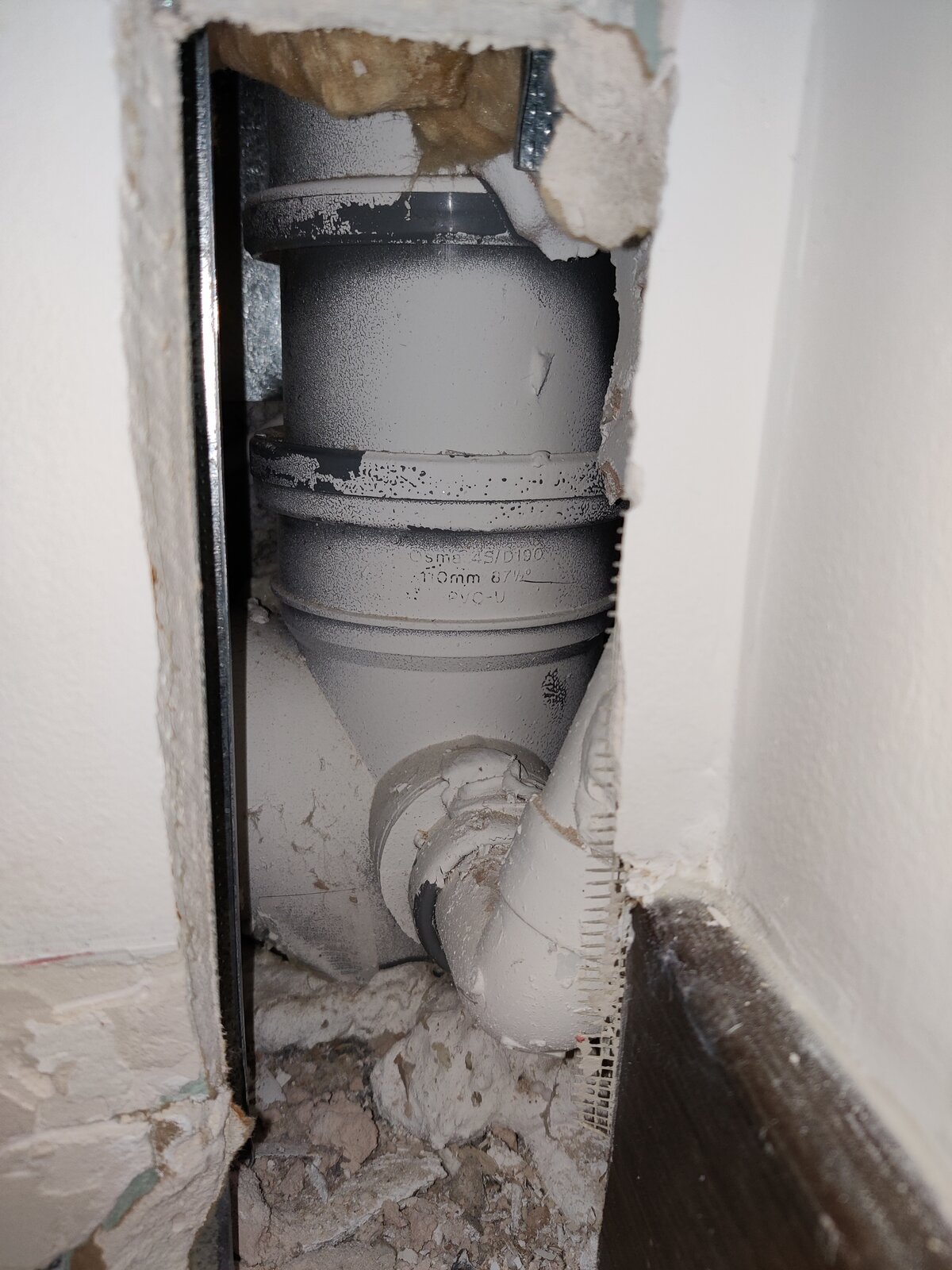

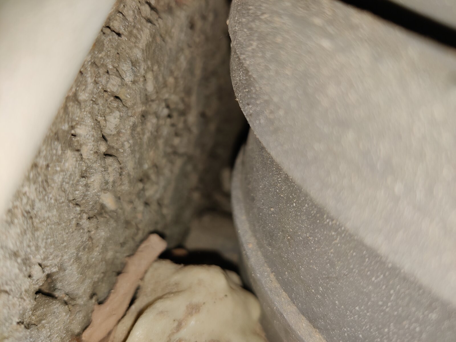

The pipework is boxed in, but I've cut a hole to inspect. The pipes are covered in dust and there are no visible leaks.

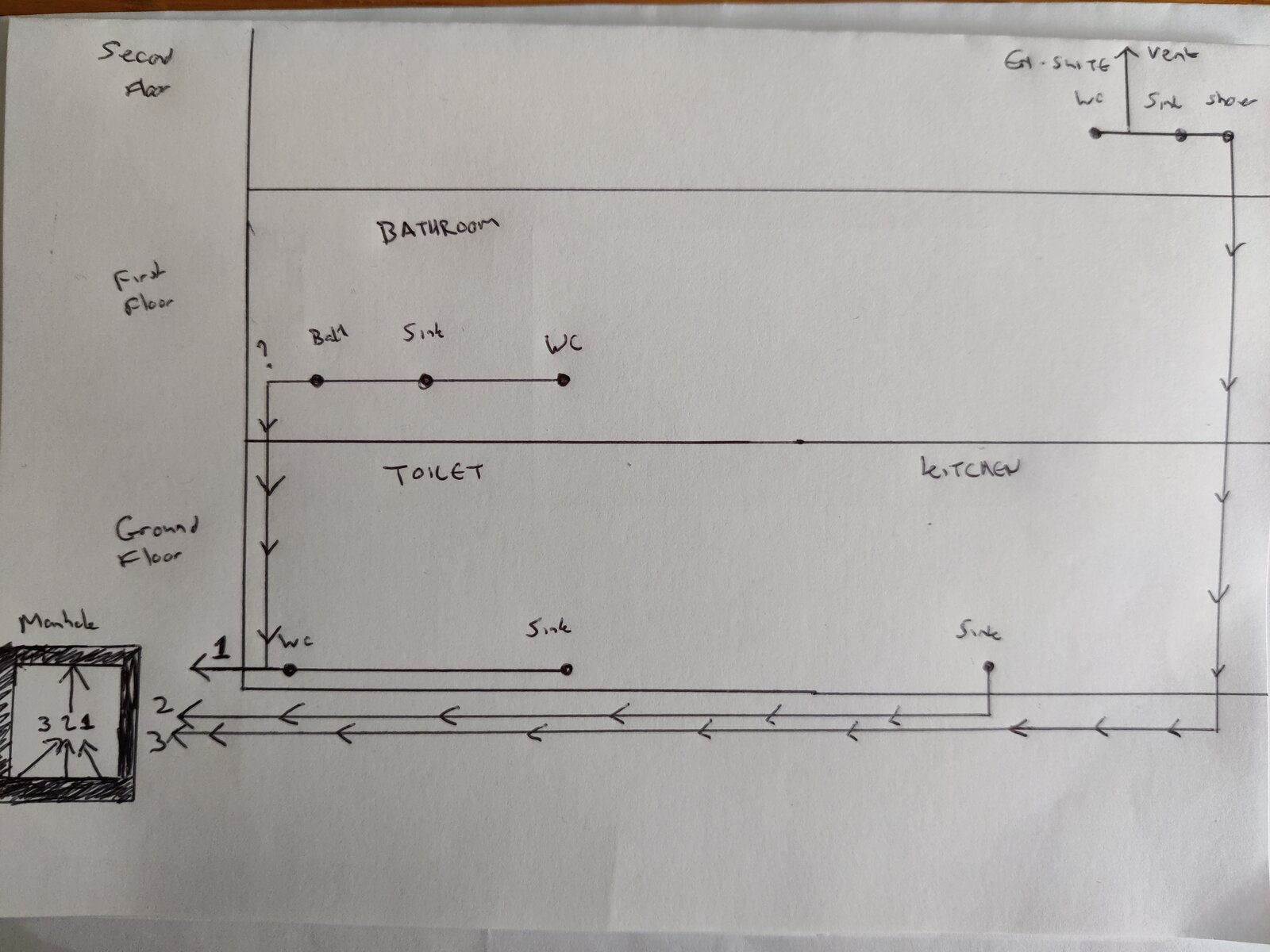

The soil stack also services our bathroom on the first floor. It's boxed in here too, but there is a large gap behind our vanity unit. Despite this, we've never experienced a smell in this room. The stack isn't vented externally, so, I assume it's capped internally.
Air is forced through the pan connector when we flush the upstairs toilet, but I can't feel any air coming through the inspection holes. I can feel a fairly strong draught, but it doesn't seem to be carrying a smell, or at least not today. The soil pipe is insulated, but it looks like the insulation is missing at the bottom.
Could the smell be drawn in from the outside? We've tried to trace the smell outside before but it seemed to be isolated to this room.
Thanks in advance for your help.
