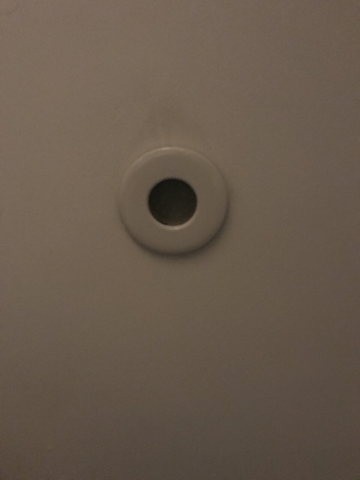

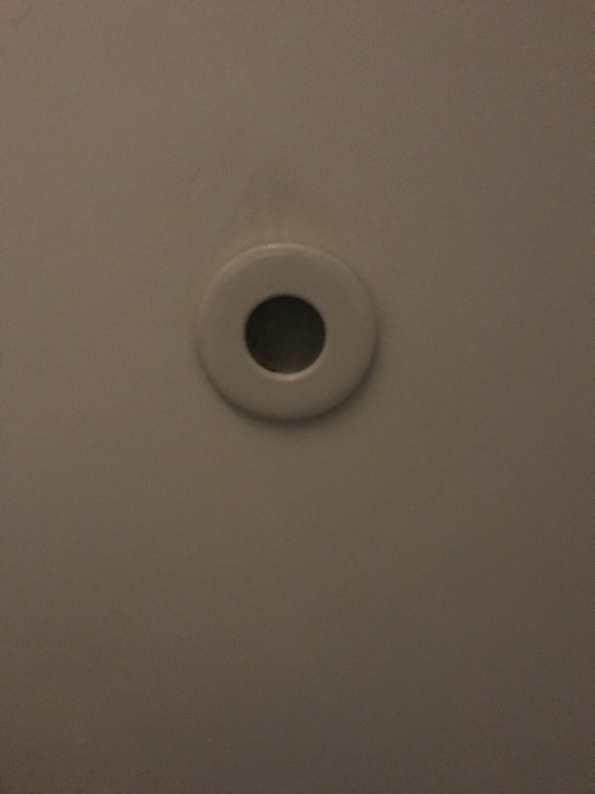

Also forgot to ask, are those Ip65 Gu10 holders with glass generally so small in the surface area of the light. I checked the ones I have in my kitchen and the light can only get out of a 40mm glass hole so little light can escape compared with the non IP65 ones.

But would t it be better to go for the ip75 if they’re available.
Actually I’ve got a pack of four left over from the kitchen which is the one from the The photo.
You can if you like. But aren’t they 12v halogen lamps? Halogen lamps are obsolete.
Also, the light spread on those is very restricted.
