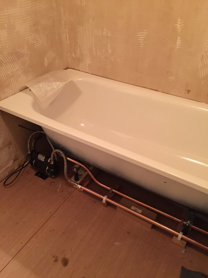

Is a shower pump regulated underneath the bath
I missed the pictures for some reason. That installation is an abortion. And if a plumber doesn't know the difference between positive and negative head, I would be worried.

I suppose that's why it's loud, what about the pipe work has he done that correctly?
Well, that explains why the shower pump is so loud.
Even the place where I purchased the pump from, insisted I was being childish over the noise, as they made it clear it was pretty normal, they recommended this Plamber to me.

The bath panel is not easily accessible as the washbasin with cabinet is in the way.
I did tell him to move it farther away,
He refused to listen to me.
Said it will be fine.
I have a paving stone, a thick Shower pump mat, which is meant for the pump.
And various heat resistant soundproofing
I'll have to find someone else to help me install it correctly.
I had another plumber who came round he installed a salamanda 1.5 pump under bath, as it meant Breaking tiles in order to go to the loft. The pump came with feet. And pump mat was used.
I am so delighted! I cannot even hear the pump is switched on..
no more Unbearable noise!
My previous Plumber installed the pump incorrectly, and even possible the pump may be faulty.

I think they are loud if fitted incorrectly.
I am so pleased this problem is resolved.
So you did not even use the paving stone?
I don't know why you bought another pump. We don't rate Salamanda very highly. The proper Stuart Turner are the best.
At least I am glad of my attempts to get you to realise the problem was with the mounting!

The salamander pump came with feet.
Pump Matt I purchased from Amazon,
Didn't use The paving stone, it wasn't required. I think the pump mat is absolutely brilliant!
All pumps come with a sound proofing mat or feet and are never fix to nowt as in your photo including the flexi hose which is used to reduce noise. I have even fixed pump to plywood base then rest on 25mm water pipe lagging, like floating a boat on drums so to speak. It works and that is the main thing.
All you have to do is read the instructions available to all, for all makes on the internet and you will see there is a pattern for installing most shower pumps including Auqalisa roof jobbies. Pumps fitted above a cylinder require extra special requirements. So no exuse really, unless your plumber cant read however all instructions come with pretty coloured drawings as well.
Fitted loads under baths and no problems with most. I would not of used copper pipe to the shower unit but placky "resting" on 25mm water pipe foam lagging attached with tie band or if copper sleaved with same but not fixed as such with physical clips as shown. All pumps have a slight screaching sound not a rumble.
