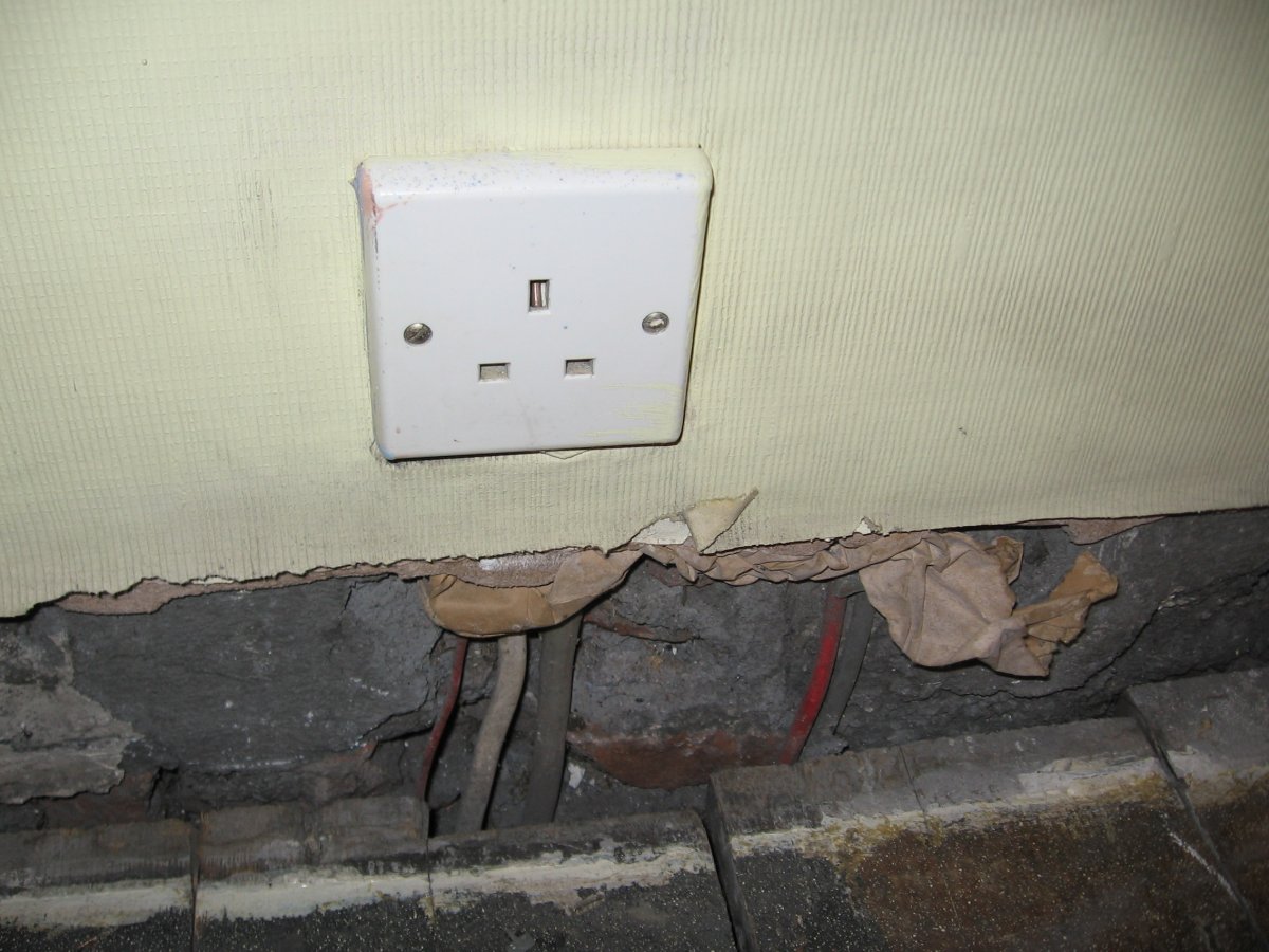

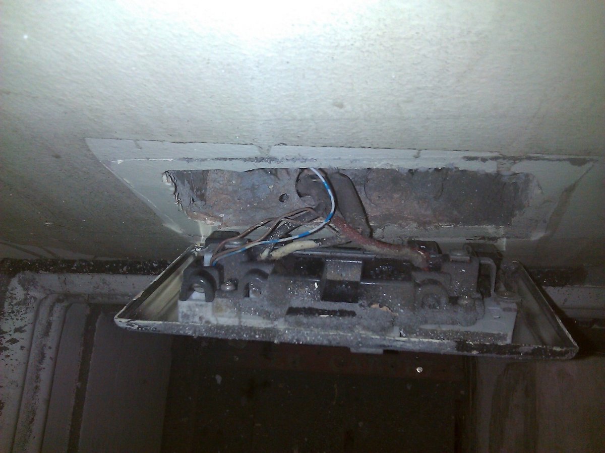

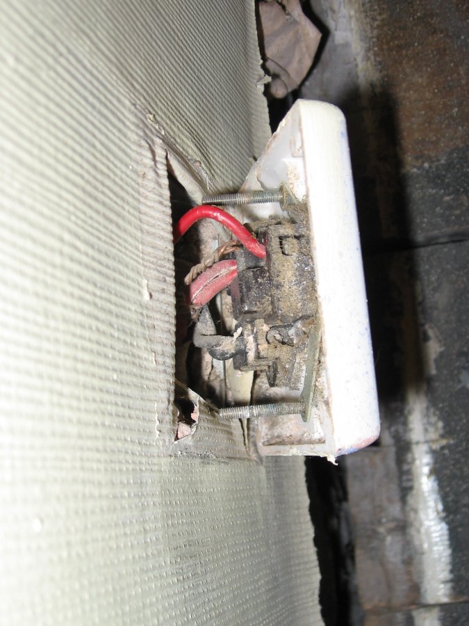

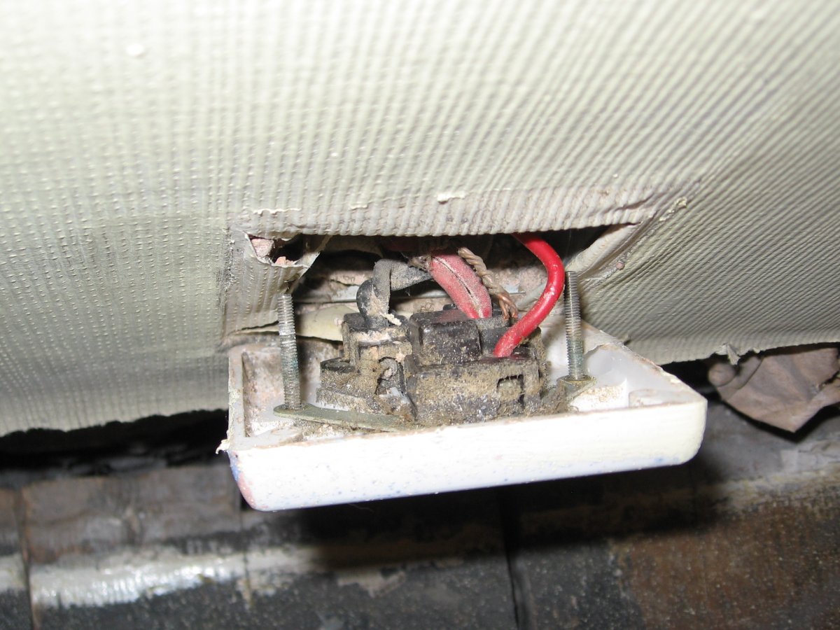

Just doing some renovation work in an 1895 house and have found that the wiring isn't perhaps BS 7671:2008+A3:2015 compliant...
Random wires.JPG Strange wiring.JPG Under a blanking plate.JPG WP_003981.jpg WP_003982.jpg WP_003990.jpg

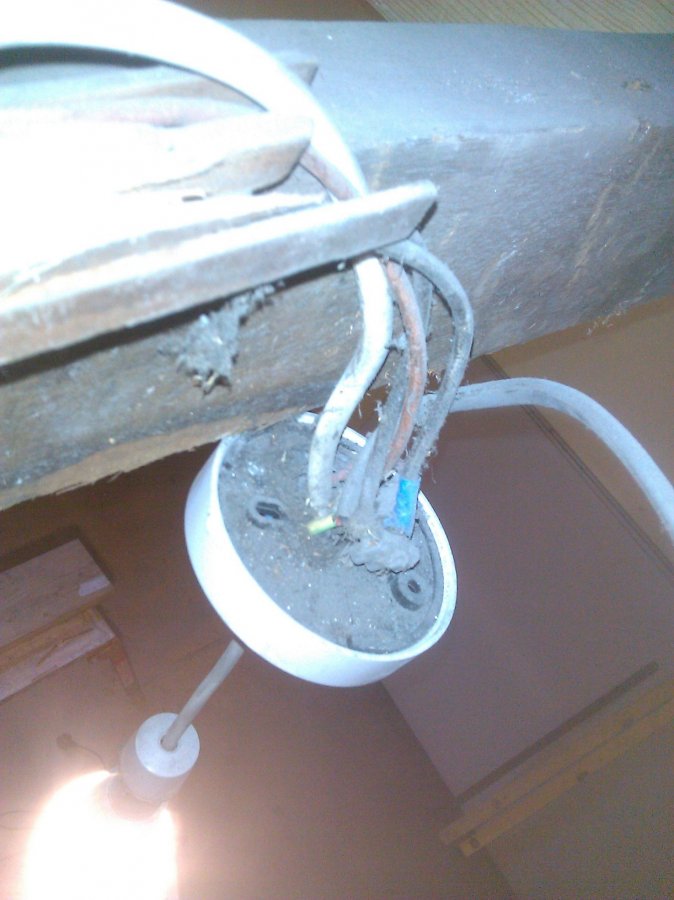

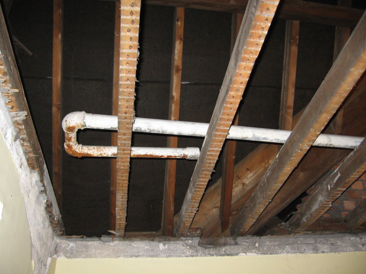

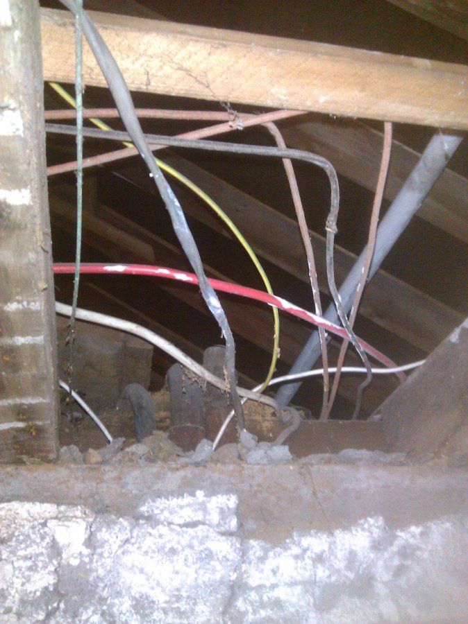

Renewing the ceiling and tidying up some old Victorian cast iron central heating piping that was in the loft (see below) and I thought I would remove some of the old turn of the century 'case and capping' wooden trunking wiring that was still up in the loft.
That was fine until I came across the point where it connected into the newer T&E and I realised it was still in use.

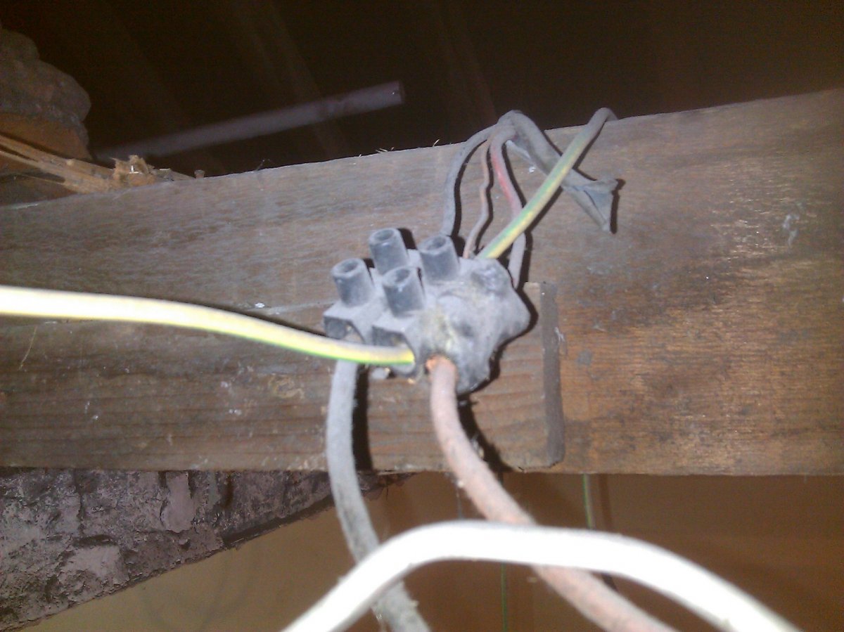

The terminal blocks you have pictured are melting with heat.
With wiring in this state, with the errors I can see just from the photographs and a lack of further evidence then I would imagine the only safe route would be to rewire the property, especially if the cables you describe are still in use.
Good grief! ... what bhm1712 said! One would normally advise a full inspection of the electrical installation (EICR) as a starting point but, in this case, I'm not sure that there would be any point!

As mentioned already that property needs a total re-wire,

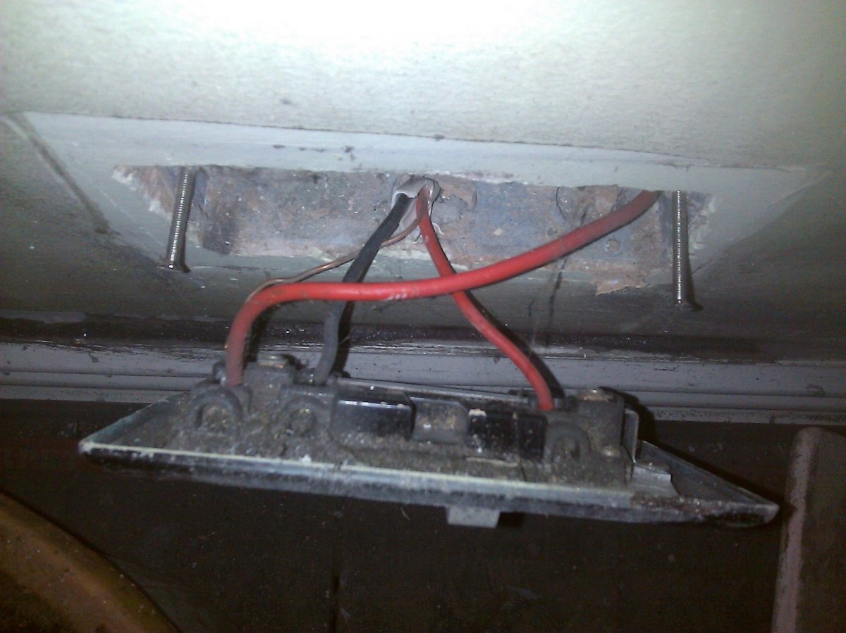

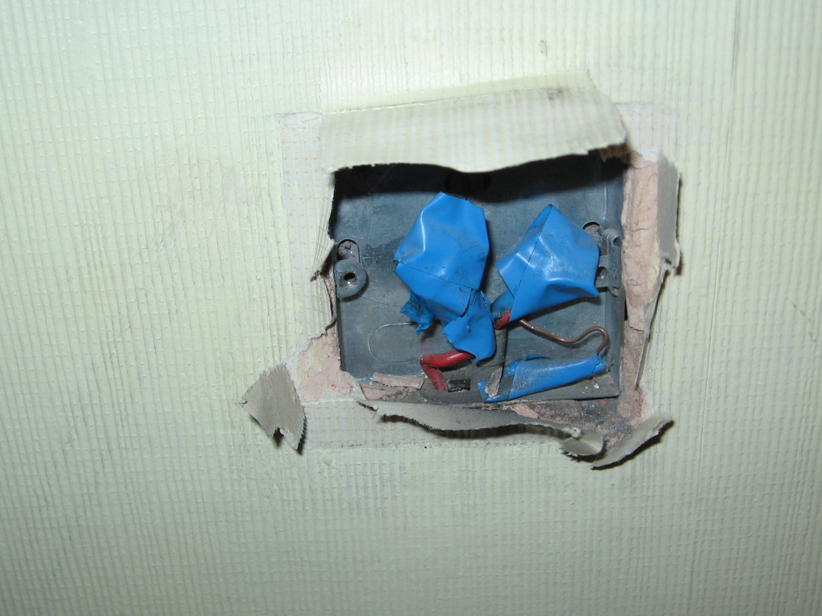

bhm1712 – yes that terminal block is not in a good way… There are others that have lose connections as when you tap the wiring the lights flicker. Light switches have a single live feed from a single large red cable. Even stranger, I have found one live feed that is tee’d off from the light switch back box using a terminal block and then this extra live disappears back into the wall – separate from the live that then feeds the switch and lights. It seems most Neutrals are ‘borrowed’ even on lights that don’t have two or more way switching.
Has anyone seen these single solid core fat red wires before? They have the same diameter as 6A mains cable and I haven’t come across that before? They can be seen in these photos.
Iron pipes in the loft are common, but will have been for gas lighting. They might still be connected to gas fires and may still be live. Occasionally there are later wires poked down them.
